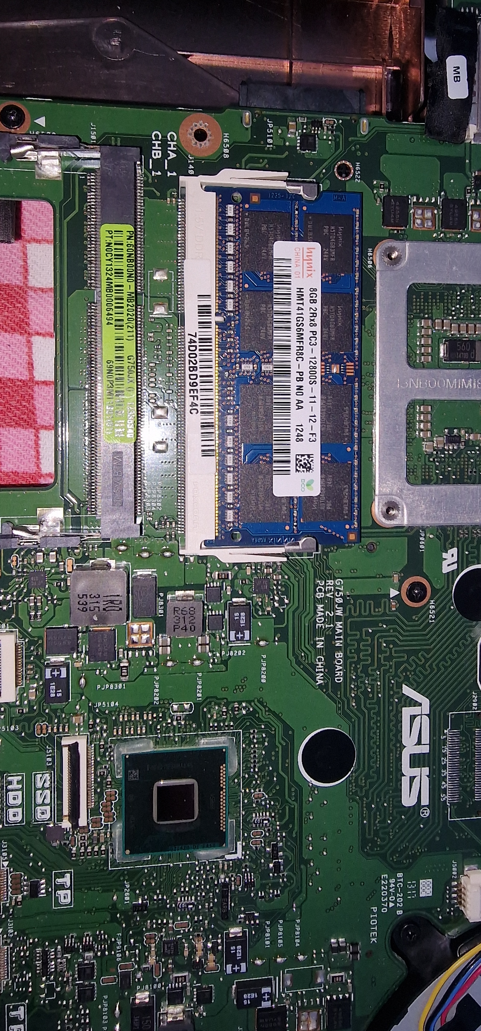

    I have a problem with the asus g750jx, it shuts down exactly every 30 minutes. There is no overheating and the like, it works perfectly for half an hour. it turns off both in bios and in windows. My guess is that the bios is the problem, would anyone like to take a look and try to fix this bios so I can flash it again?
    I should mention that the bios update did not help.

    post the S/N, post the original content of the bios chip, the motherboard model, etc.
    ​post the bios here on the site, not on other sites...

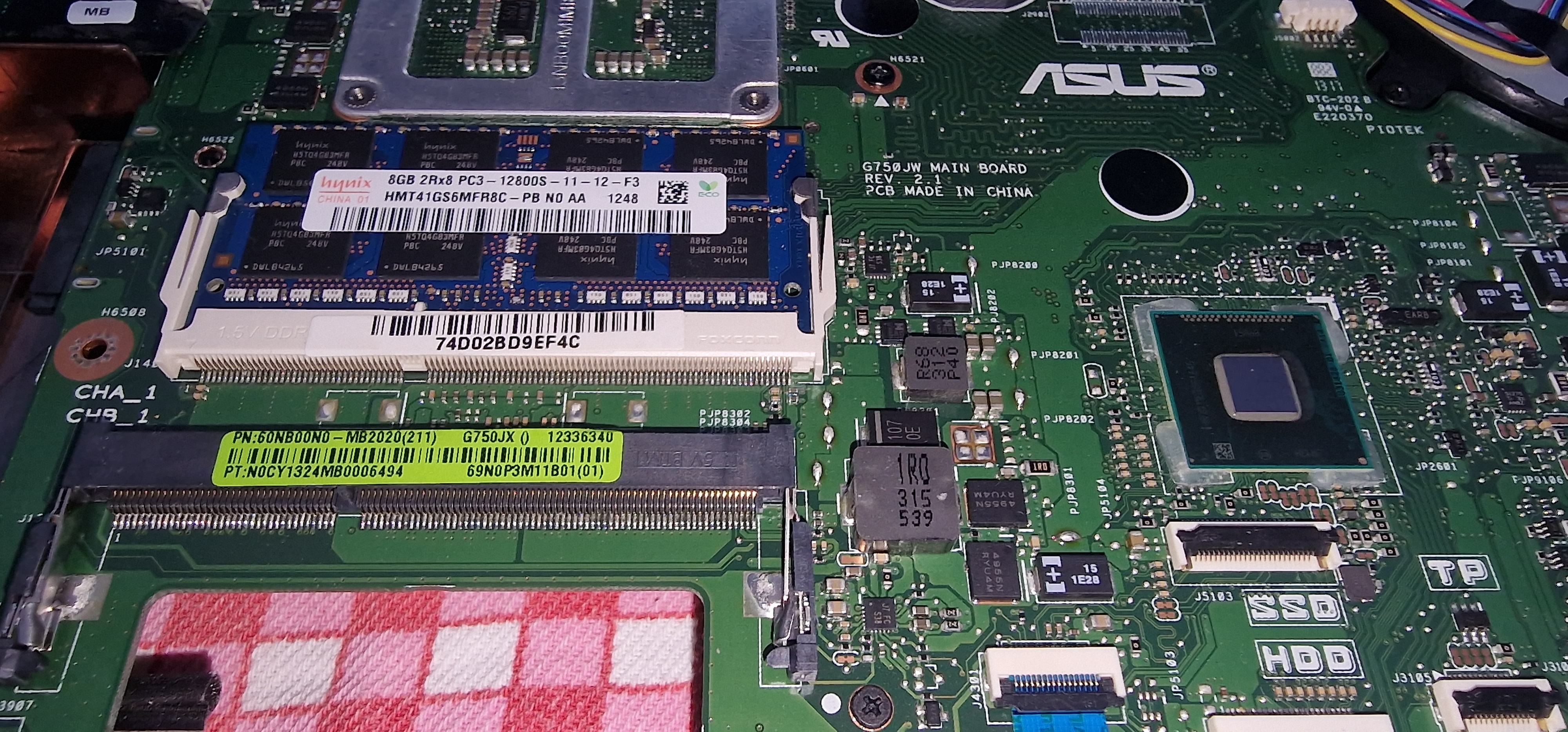

      SN/ D6N0CY359870244
      Asus G750JX-T4167H
      MB/ G750JW REV. 2.1
      Noticed after bios update the serial number disappeared

          I flashed the edited bios, everything works as it should, now I wait 30 minutes to see if the laptop shuts down.
          Again no serial number in bios but that doesn't matter if everything else is ok

            It works! Just amazing, it didn't shut down after half an hour, thank you very much!
