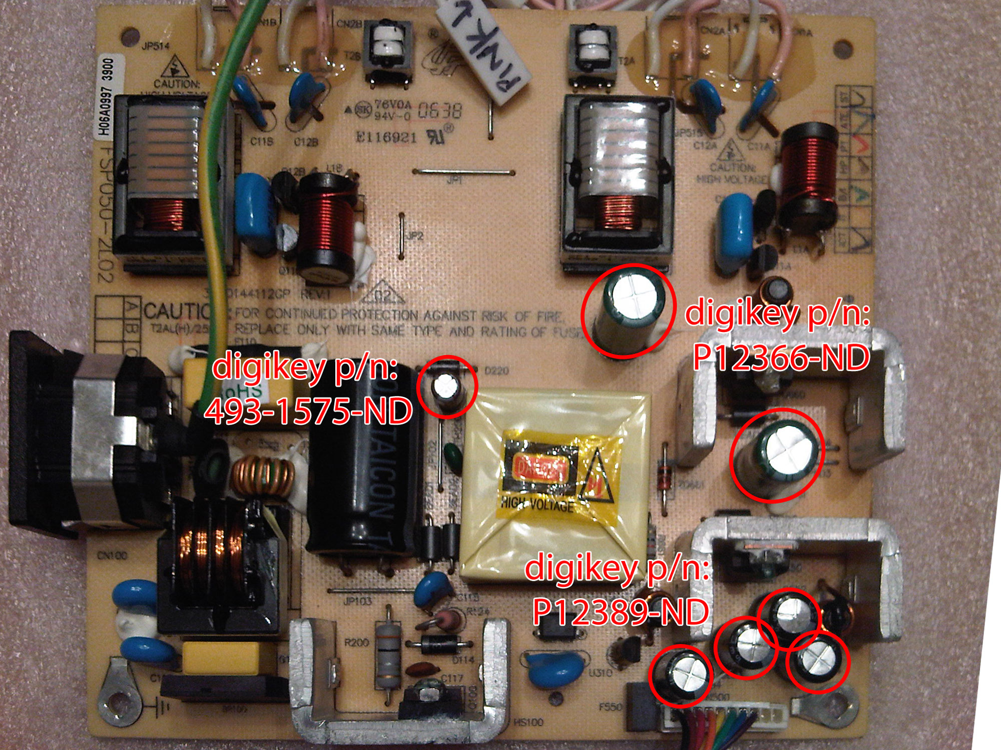

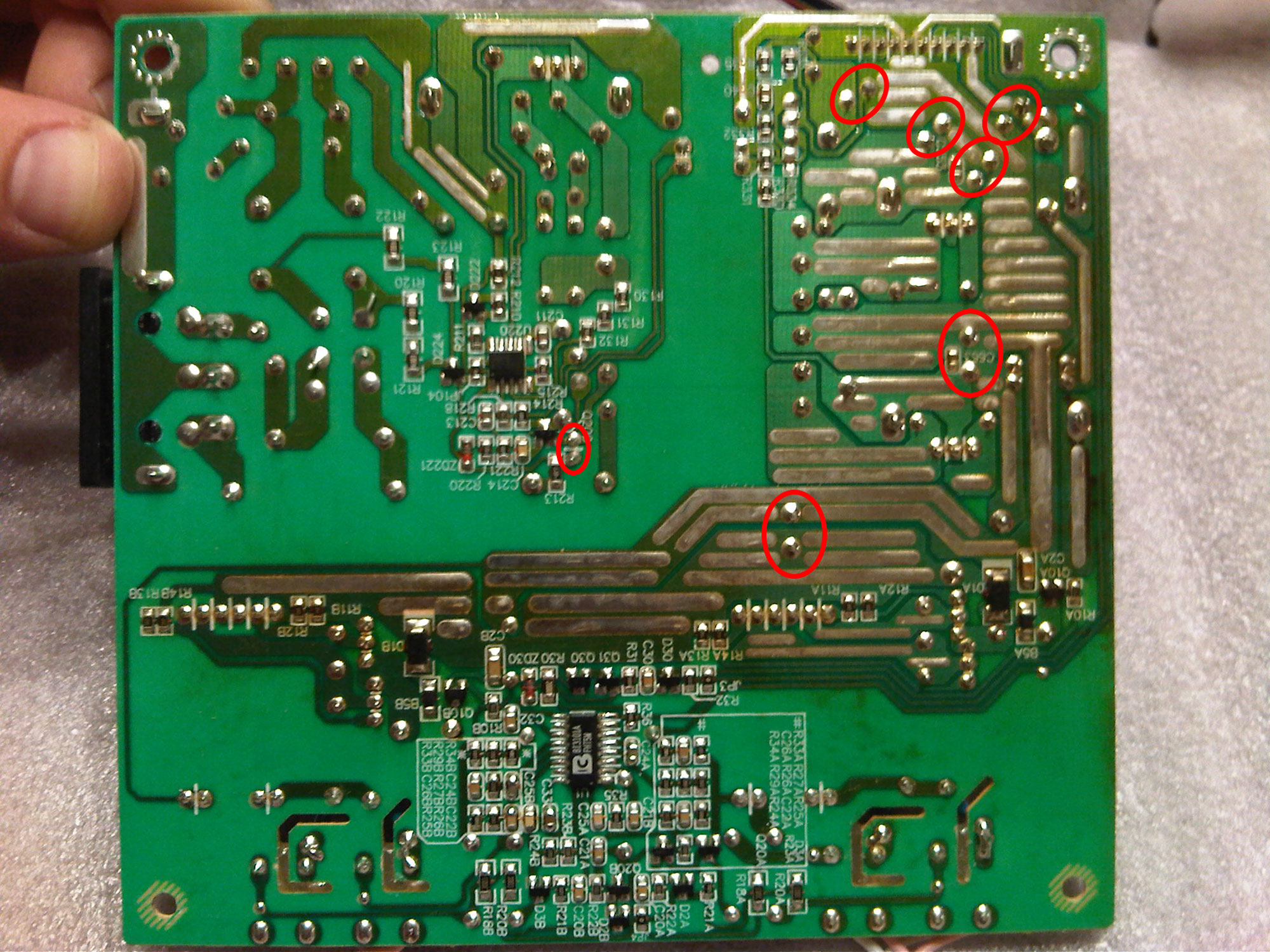

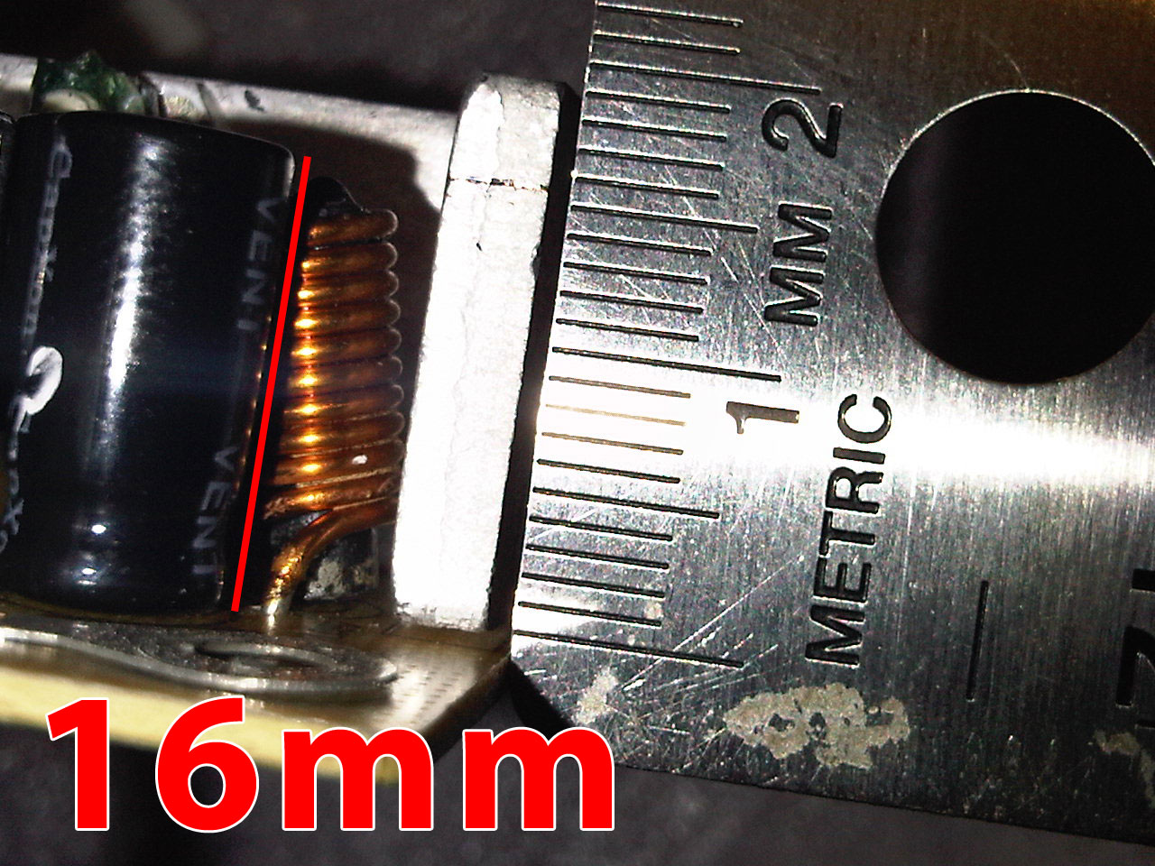

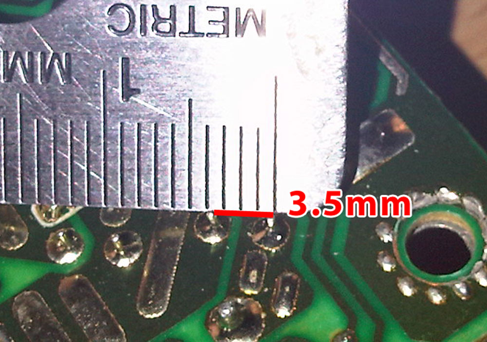

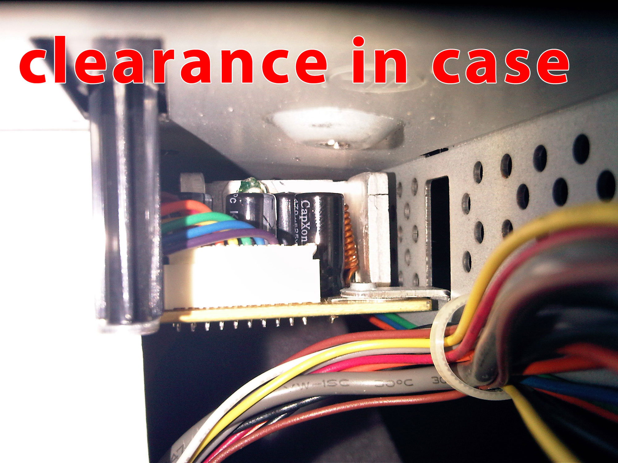

    Thanks kc8adu and Bobdee.

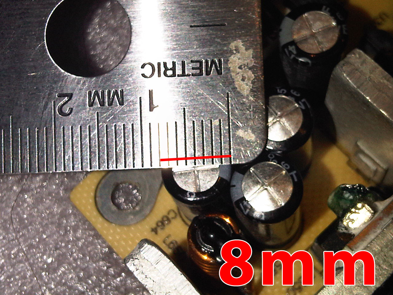

    I'm a little worried about the size. I can't seem to find an exact match but I may not need to. It seems there will be enough clearance for the 20mm in regards to the height of the 470uf25v to fit in there (see pic), but I'm a little worried about the width as 10mm is the smallest I'm seeing on the sites; the ones in there right now are 8mm. Plus the my searches have been turning up caps with a 5mm pitch and these are 3.5mm.. do you think I'd be able to make that work?
    Here's the breakdown - (w) x (h) x (p)
    470uF 25v KF 105*c = 8mm x 16mm x 3.5mm (black)
    1000uf 16v 105*c (HF)P = 10mm x 20mm x 5mm (green)
    33uf 35v GL 105*c= 5mm x 7mm x 3mm (purple)
    more pics just in case.

      Re: Sceptre X22 WG Gamer With Replaced Caps Turns off after 5-10 minutes
      Sorry That I have been out for a while. Here is my parts list from digikey:
      digikey# 493-1575-ND, mft# UE1V330MDD CAP 33uf 35v Elect HE Radial
      digikey# P12388-ND, manufactures# CAP 470uf 25v ELECT FM Radial
      Hope this helps.

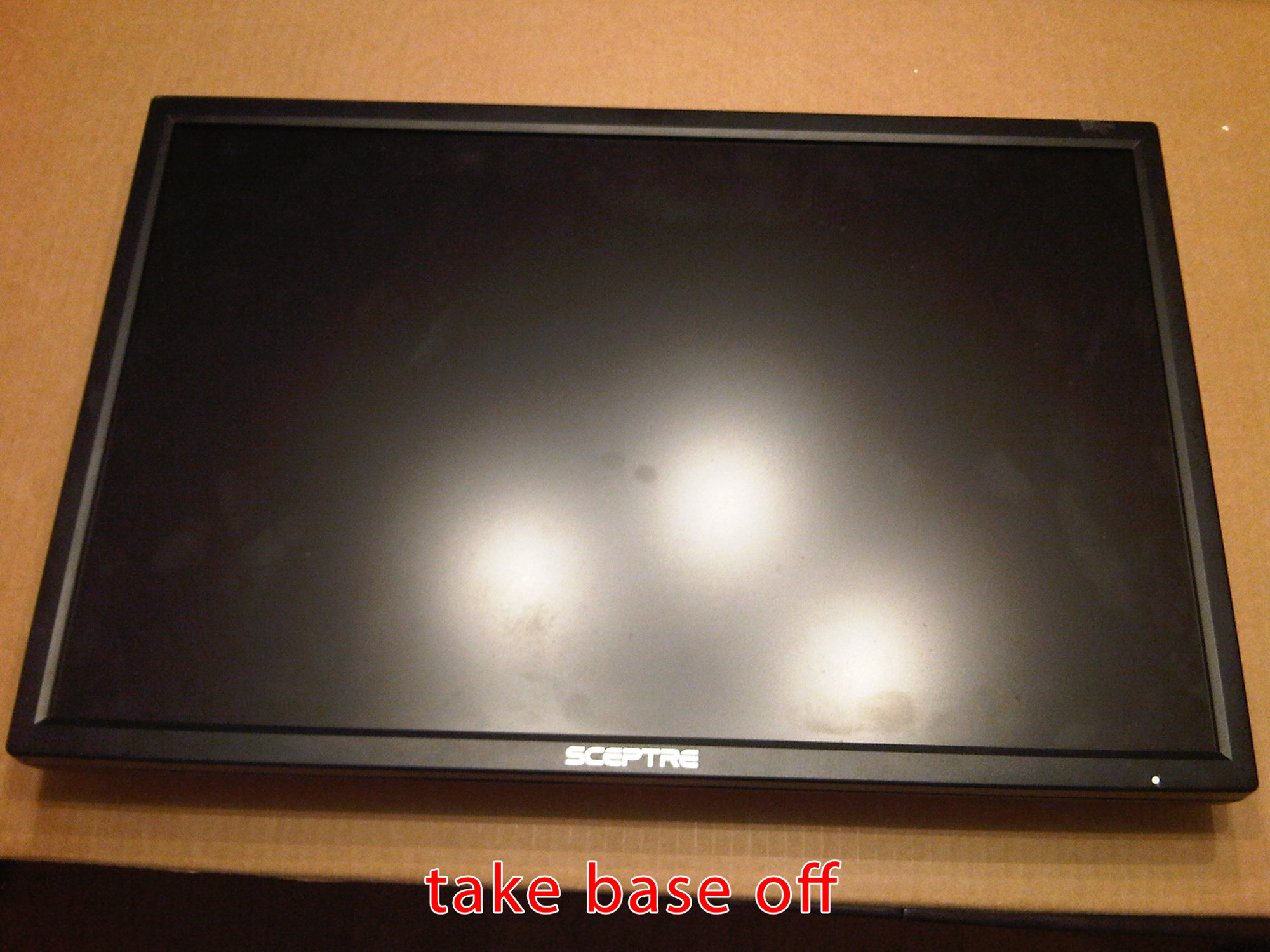

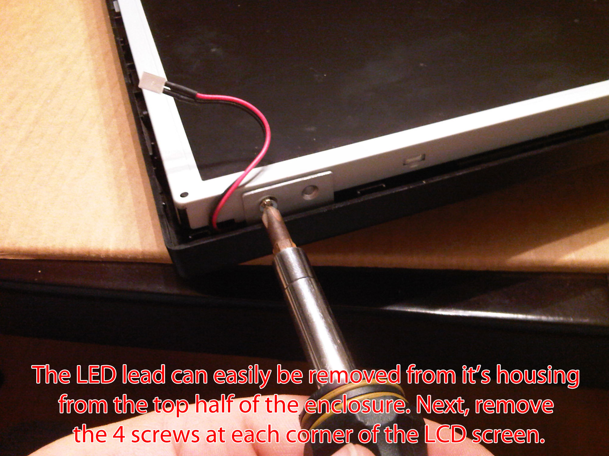

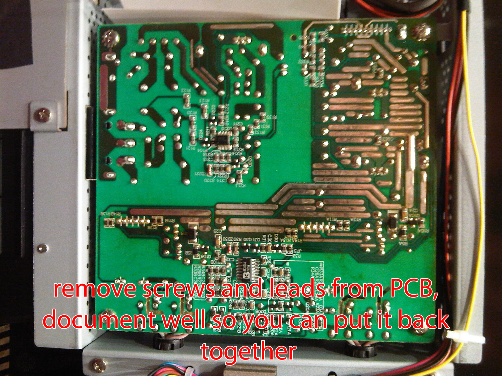

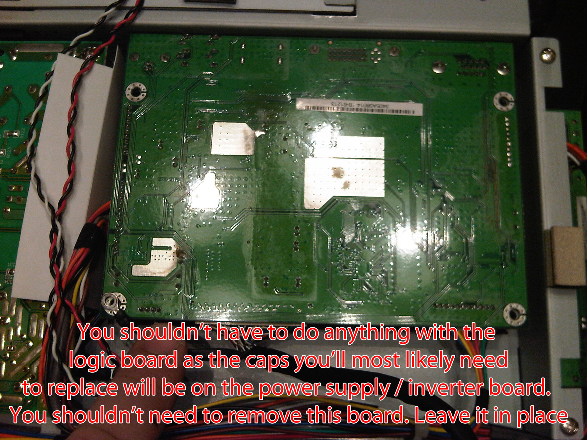

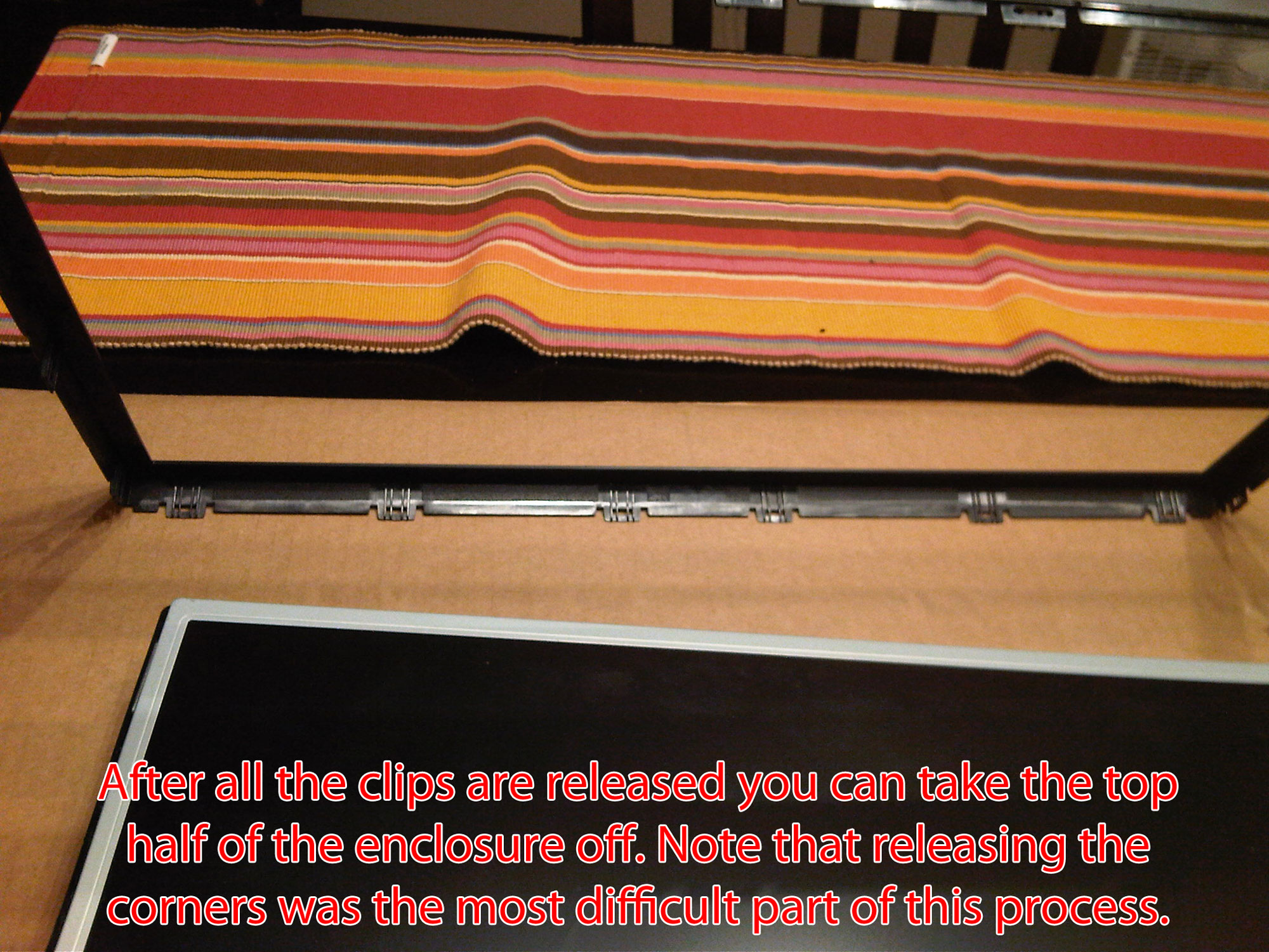

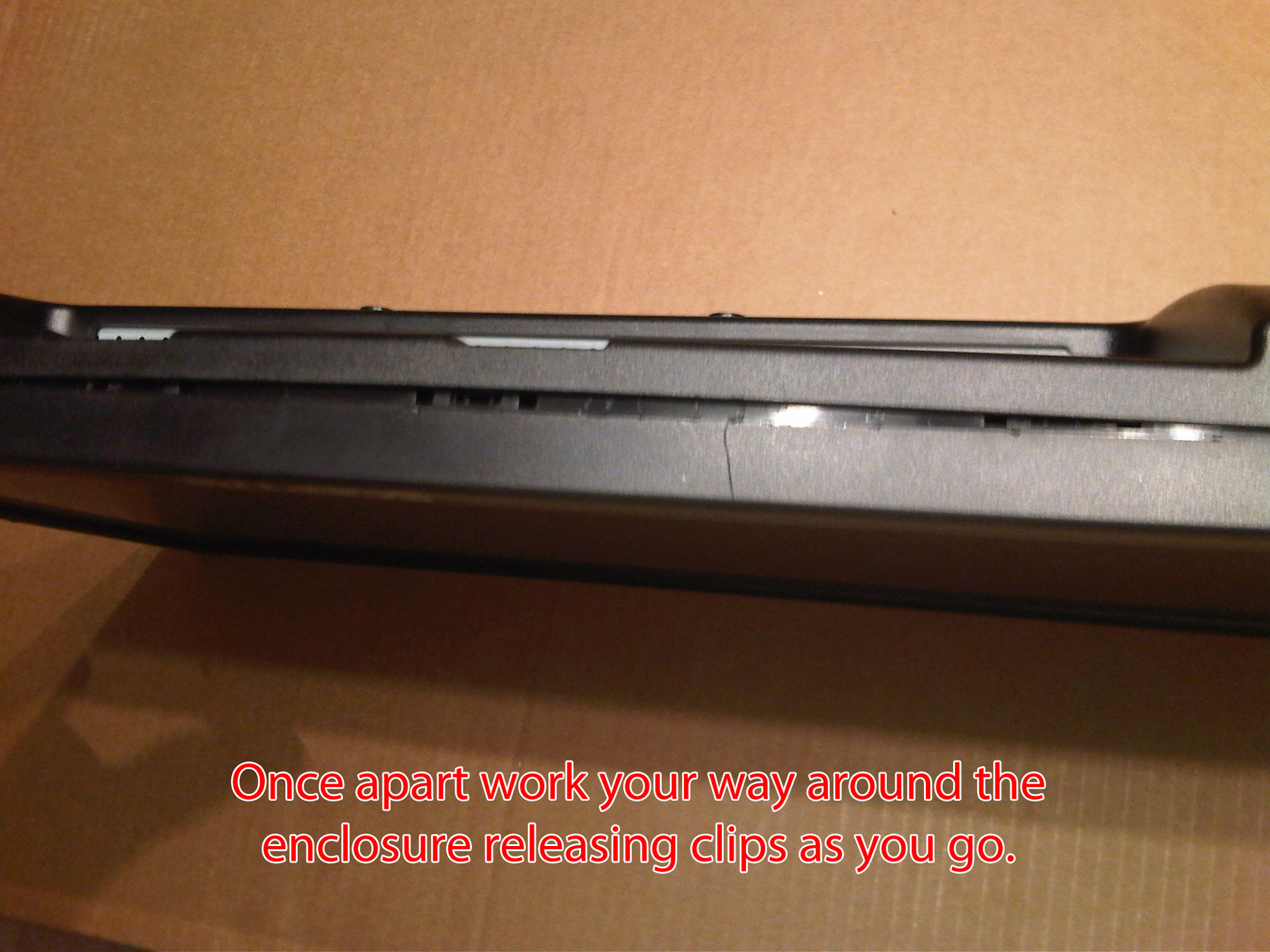

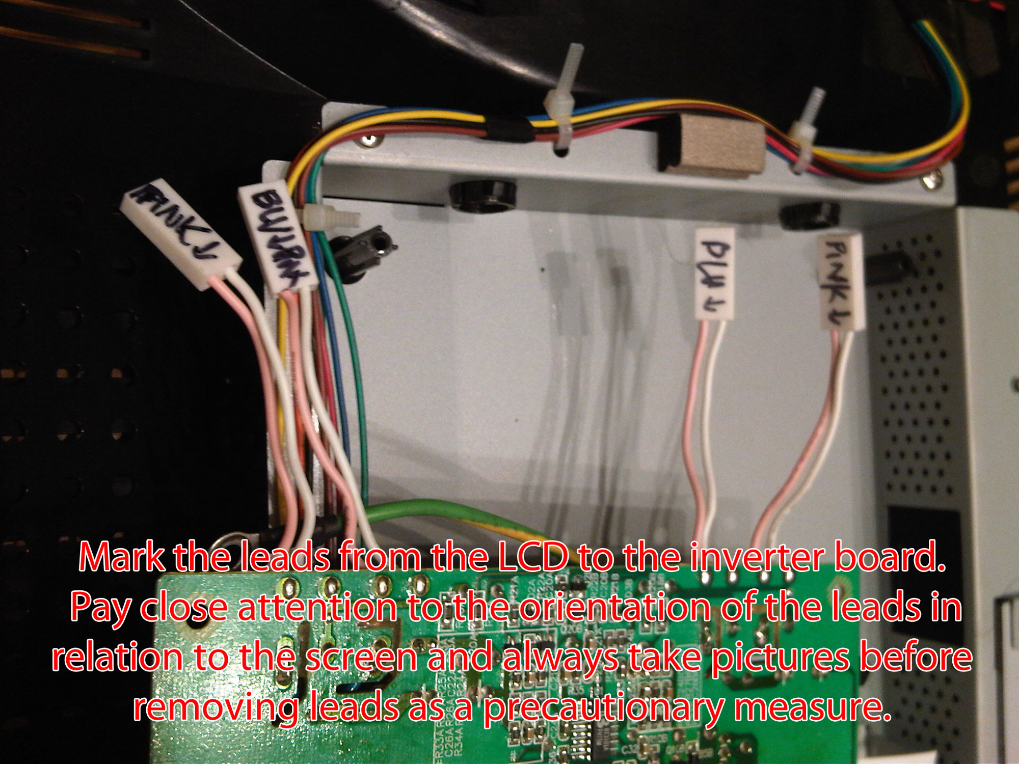

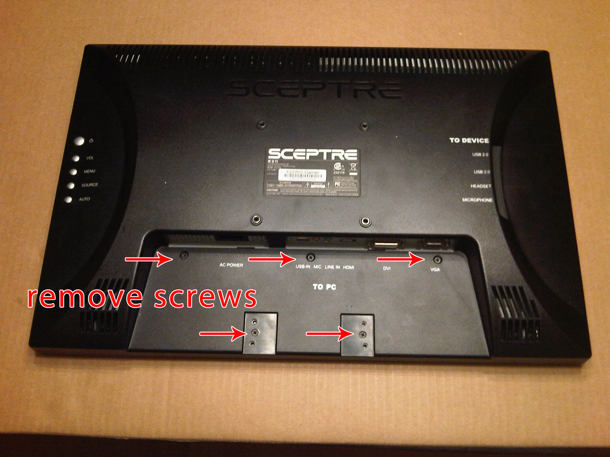

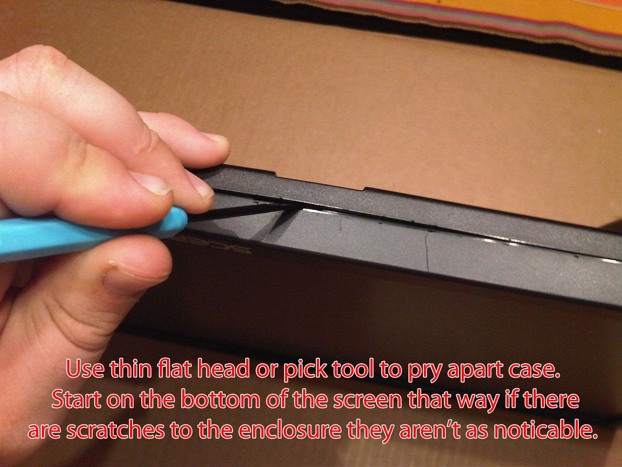

        thx logos, I replaced the caps on the board and my monitor works great again!!! thanks you all for your help.
        I'm posting pics of getting into the case in case others need to do the same... since the recommendation from Spectre tech was to "buy a new one" when I called asking for a quote to repair it.
        Here are the pics. Keep in mind this was my first time attempting something like this so I'm not sure if this is the best process but it worked for me.
        Cheers.
        EDIT: when I uploaded the pics it rearranged the order. Just look at the filename to get the correct order. 01-10 then parts list..

          However, part #p12389-nd isn't going to be available until Jan 11, 2010 so do you know if there is any alternative to this capacitor?
          Thank you.

            If it will fit into the available space, try P12388-ND. If dimensions are critical, try P10274-ND.

              P12388 seems to be too fat (10mm) and P10274 has "only" 2000 hours of lifetime. I play games a lot so I would feel much safer with 4000+ hours.
              What do you think about Nichicon #493-1552-ND?
                Lifetime doesn't mean what you think it does.
                Do you honestly think they make caps that only last 83.3 days?
                And caps that last only 166.7 days would be oh so much better!
                The proper name is "Endurance Lifetime".
                It is how long you can put every parameter at absolute max and NOT do any damage to the cap.
                - It does not even relate to how long the cap will last.
                Yeah, you can make some assumptions and do some math using some equation and estimate Useful Lifetime using Endurance Lifetime as an input but the equations are only +/- 40% accurate.
                If your math says 7 years it means the useful lifetime is "anywhere from 4.2 to 9.8 years". - Pretty much meaningless.
                From a practical standpoint Endurance Lifetime is a useless number so don't waste you time stressing over it.
                [There is equipment where that number matters but not in PC's. If a cap in a PC gets anywhere near the conditions required to 'start the clock' on Endurance Lifetime the system will have already crashed. The rail the cap is on would have to be at the caps rated voltage. The 12v rail would have to be at 16v -or- the other rails [5v or 3.3v] at 6.3v or 10v to 'start the timer'.]
                The Ripple rating is a much better indicator of how 'heavy duty' the cap is.
                The Ripple number is how much Ripple the cap can handle without overheating internally so it's much the same as a wattage rating on a resistor.
                The caps filter noise out of DC power.
                The caps could give'a shit less if you game.
                The load [watts] on the DC power is not a load on the caps, only the noise is.
                If you managed to pump 500 amps through your +12v rail the cap wouldn't even care.
                - That 500 amps isn't going ~THROUGH~ the cap, only the Ripple is.
                - ESR is the only thing that's going to affect system stability.
                - Lower ESR = Less noise in the power = more stable.
                - It's Ripple and ESR and 'will it fit' you should be worrying about when choosing replacements.
                470uF 25v Capxon KF series in 8mm does not exist in the datasheet.
                [Probably a custom ordered cap. They do that.]
                The best 8mm in the KF datasheet is 8x16mm and has Ripple / ESR of: 620 / 0.190
                The FC [P10274-ND] has Ripple / ESR of: 995 / 0.065 and is a good upgrade.
                The HE [493-1552-ND] has Ripple / ESR of: 1050 / 0.069 and is a bigger upgrade.
                Capxon KF series is weird.
                Many need at least Panasonic FM to match Ripple & ESR but others are fine being replaced by an FC.
                I think it's due to KF's odd lengths for whatever uF you are looking at.
                The series only has one 8x16mm and ALL the rest of the 8mm are 8x11.5mm no matter what uF or volts are.
