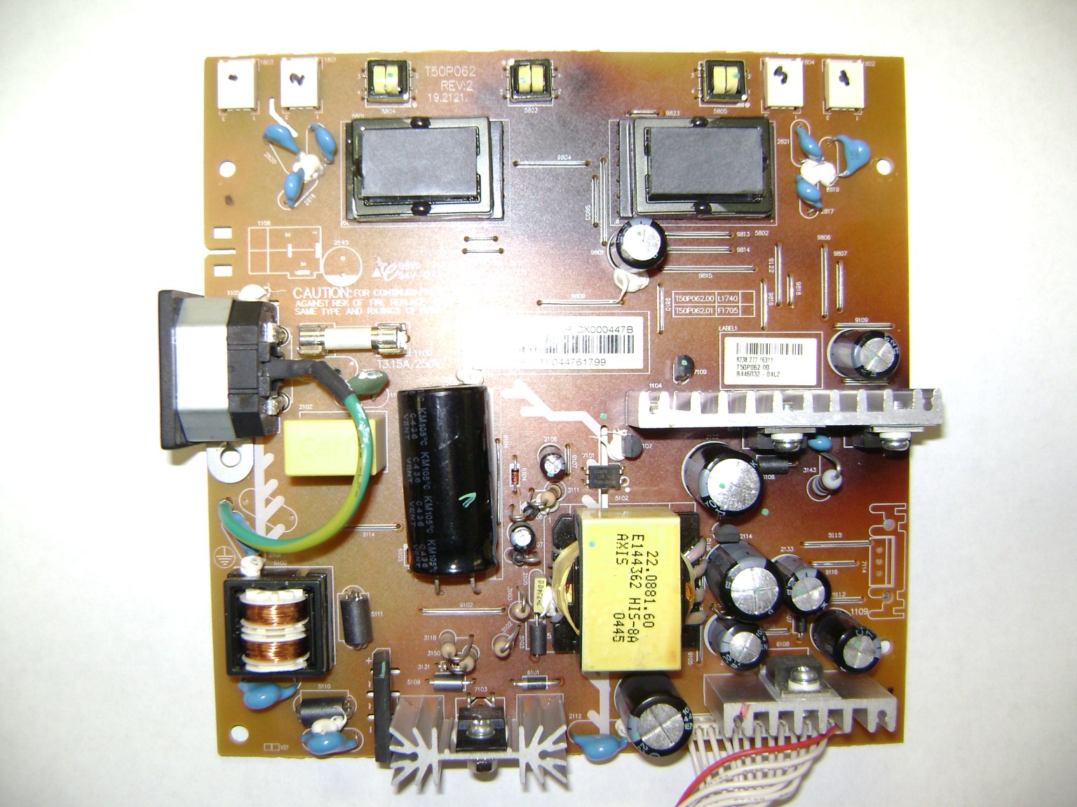

                            • George Ortiz
                              • Oct 2009
                              • 51
                              Re: HP L1740 Lcd inverter/power board
                              All,
                              Finally was able to get a picture of one of the inverter/power supplies.
                              George
                              • Bobdee
                                • Jun 2008
                                • 461
                                Originally posted by George Ortiz
                                All,
                                George
                                Just a suggestion
                                It seems that you may have a problems on the back of this board judging by those burn marks, (hope I am wrong)
                                Post a picture of the back of this board (without flash please if possible)
                                BTW Your board is a Philipps I believe and dmbj is a Benq, this monitor must use both boards
                                Bob

                                    Suggested a picture of back of board because it sounds like faulty inverter or CCFLs, and the dark heat area is probably the mosfets the members helping you will need to see the other side
                                      Right, the discoloration is extreme, but could be nothing more than the result of running for an extended time with failing caps. Unless the traces have actually lifted from the substrate it is possible to replace any shorted transistors.
                                        PlainBill,
                                        I checked on the other board that I have at home. This is my prototype repair board.
                                        It has the same discoloration as the board I have here at work (the one photograhed here). There is another board with the same burn marks. All have blown caps.
                                        Looks like running for extended time with failing caps. There are no circuit board tracks lifted on the other side of the boards.
