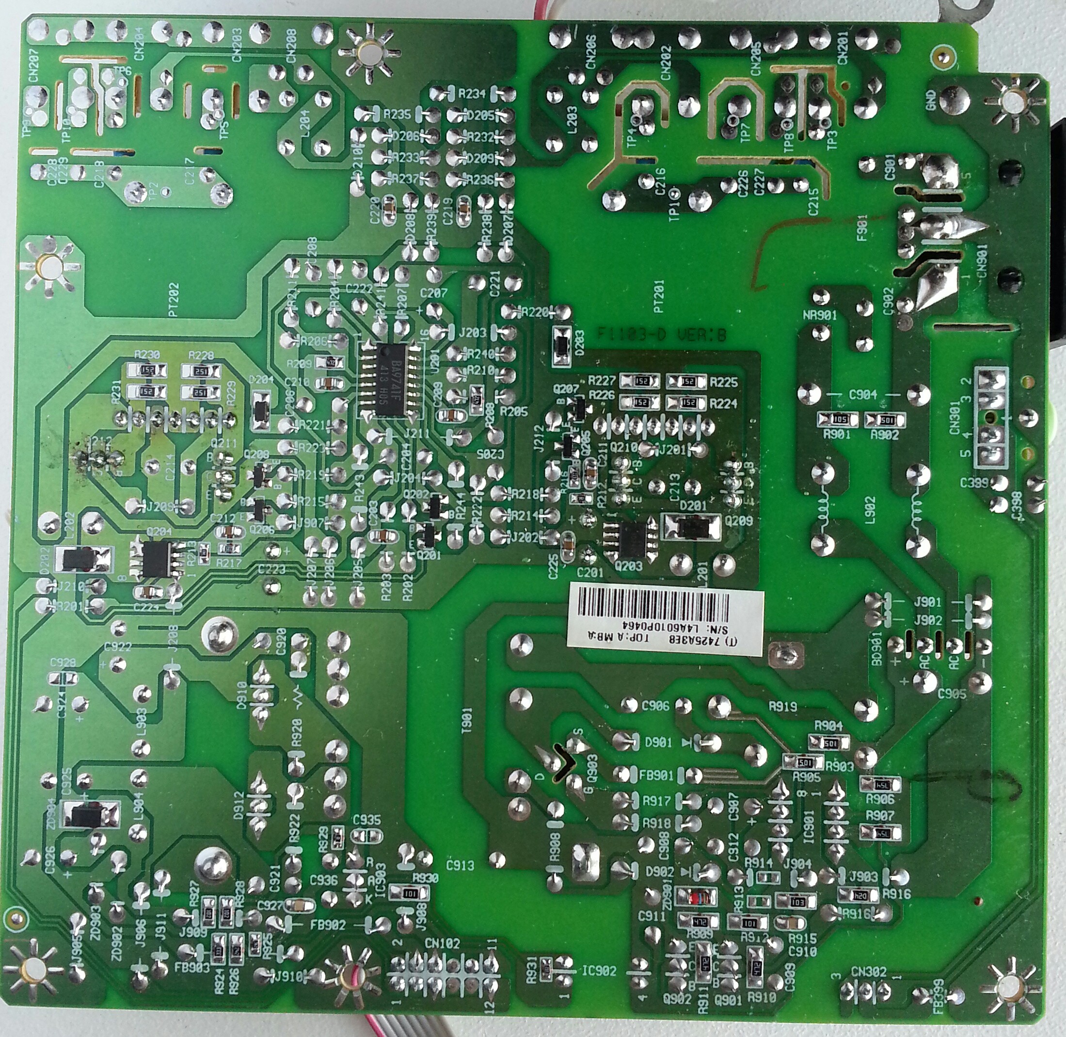

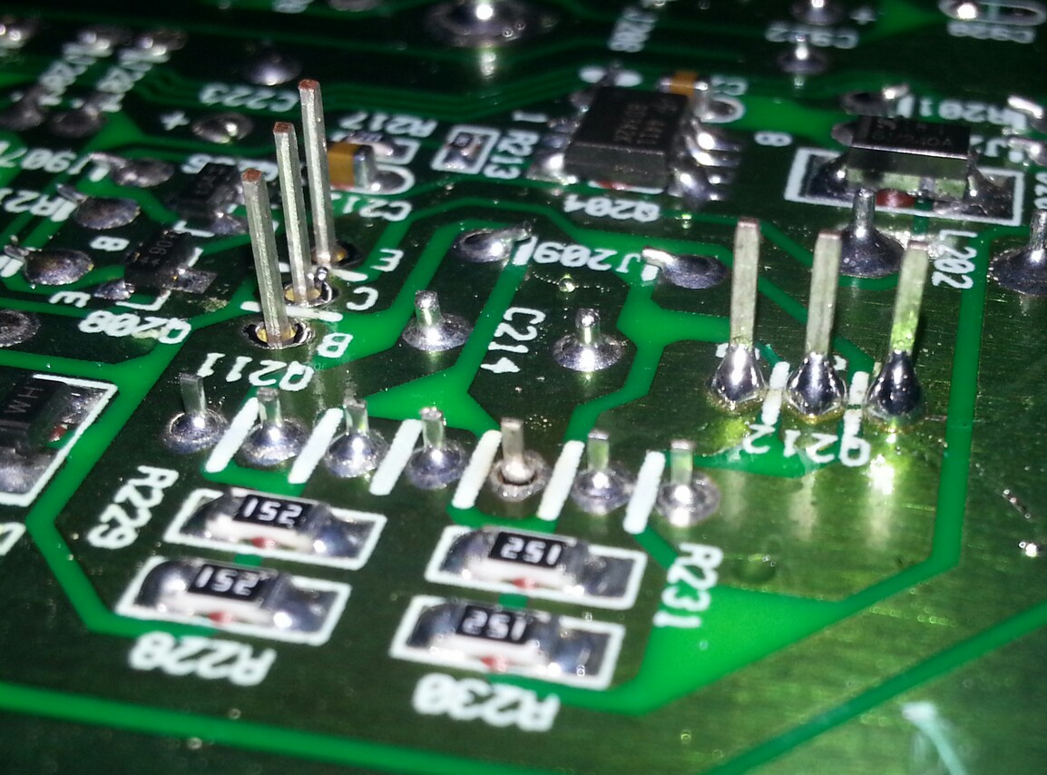

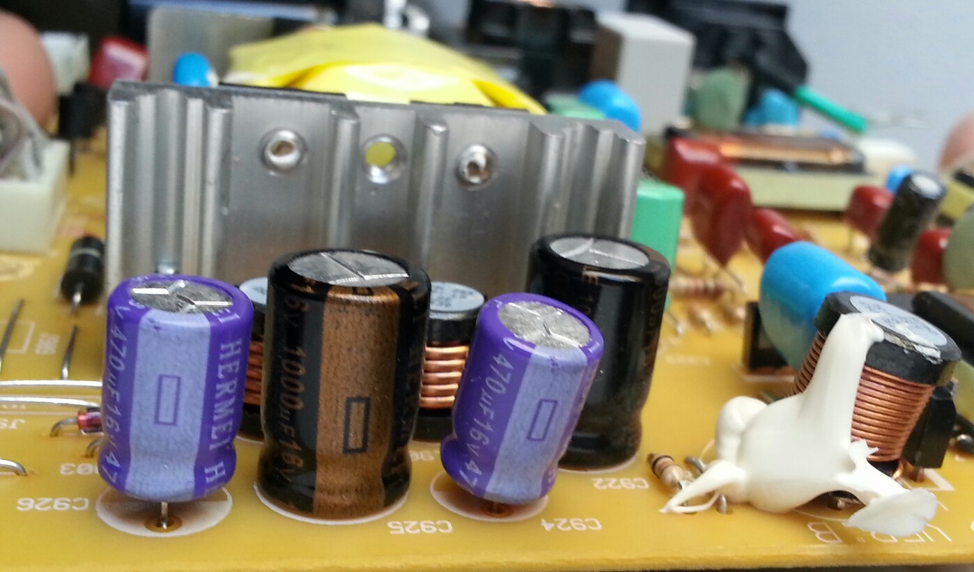

          I had the same problem, monitor works for 3-4s then screen goes black.
          I had laying around this one for long time, and bought the 5706 off ebay while ago.
          So without testing, I swapped all 4 5706 for new ones and 2 caps (green ones) and the screen not even turned on, always black (power light works)
          Then I put again old caps and same black screen.
          So desoldering transistors for checking I saw this:
          Soldered again two caps and four 5706 and fixed the transformer same black screen.
          This pictures as it is now:
          TOP:
          bottom:
          Should I replace this caps too?
          Thanks!

            #45
            Re: AOC LM725 screen goes blank
            Please update your profile with Country and Mains voltage.
            Many members do not like images posted in line or offsite - they should be posted using
            manage attachments
            • Falipene
              • Mar 2013

                #47
                Ok Better check further with a magnifier for cold joints.
                Can you also check q212, q209 and q210 again for solder bridge on the legs. Probably just the pic but better check.
                You should also resolder (Remove the old solder and replace)
                on C213 and C214 and C201.
