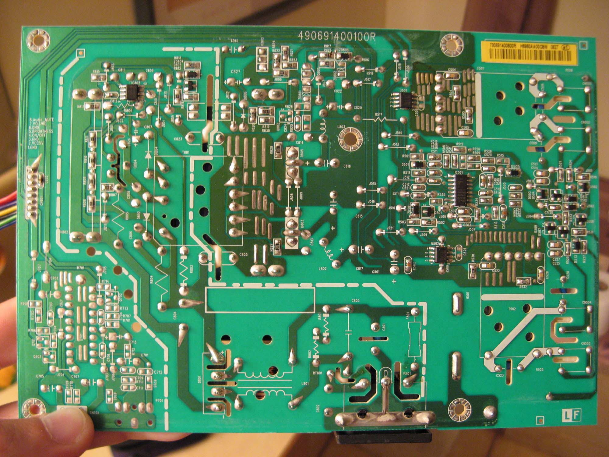

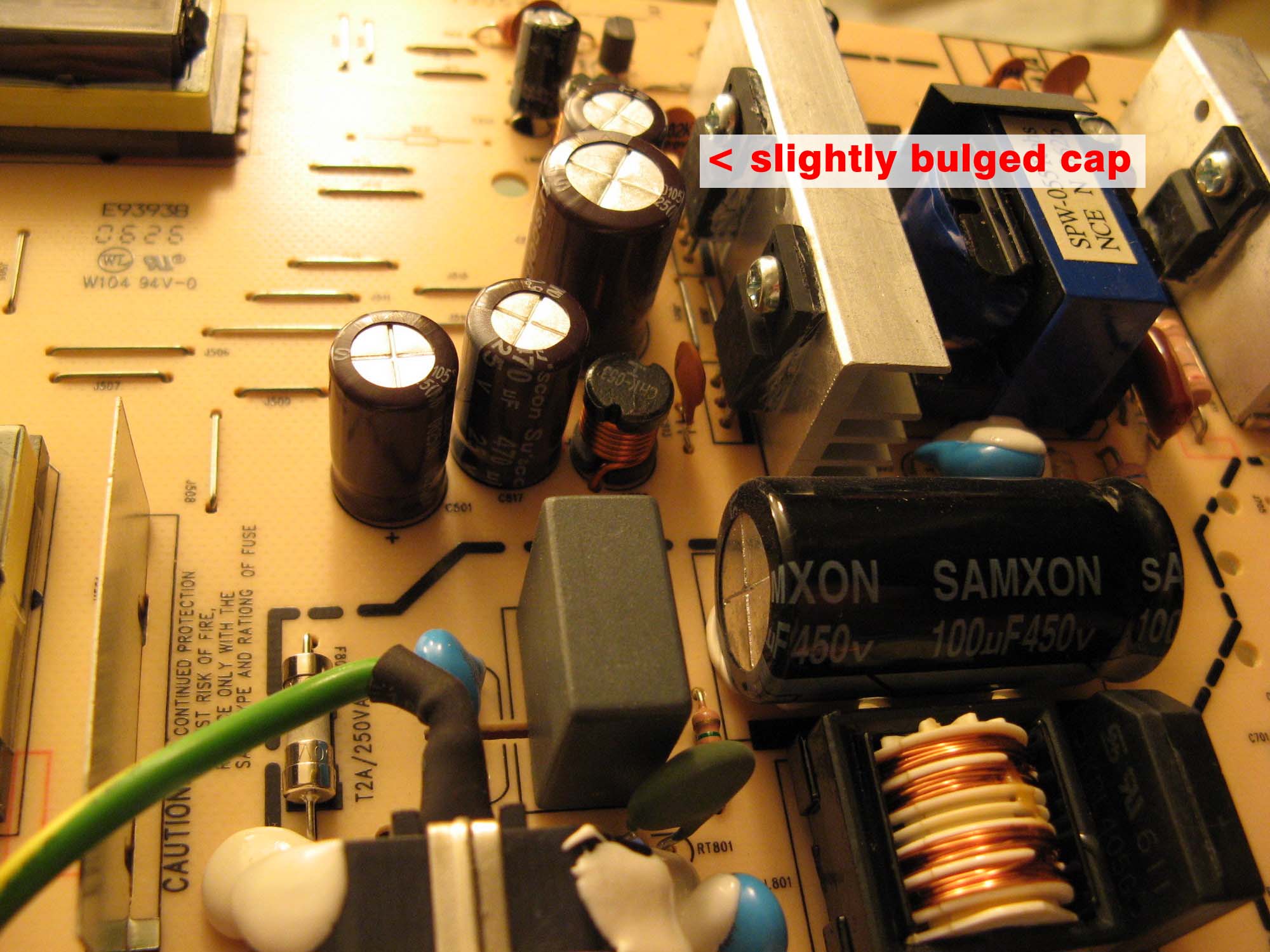

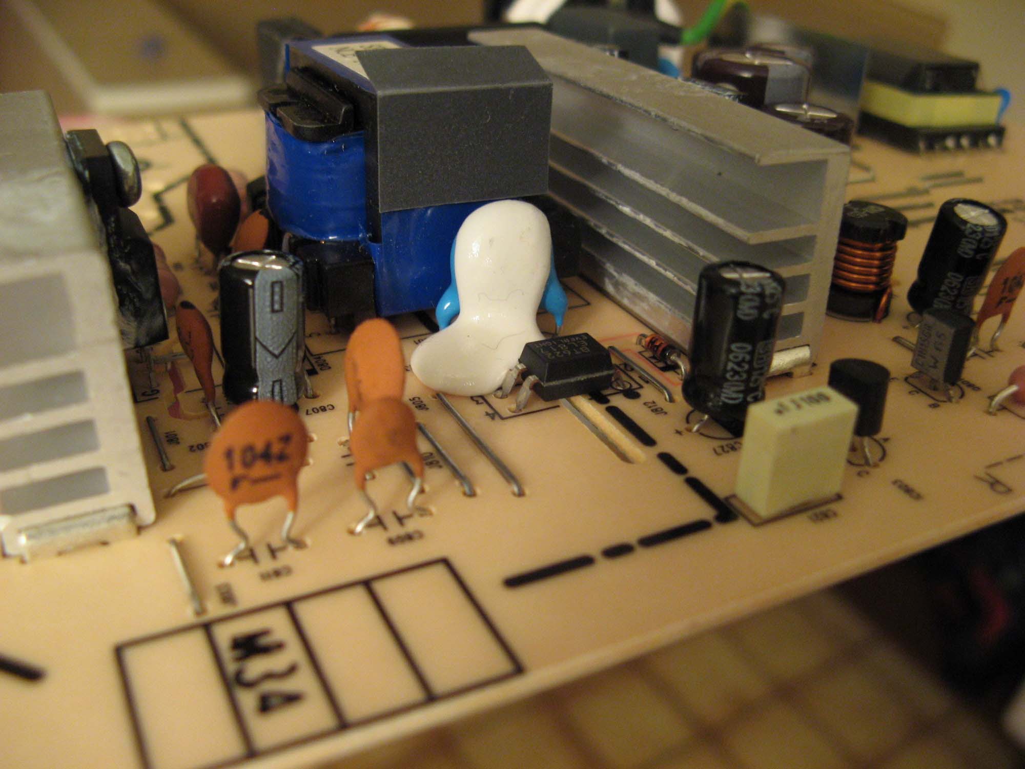

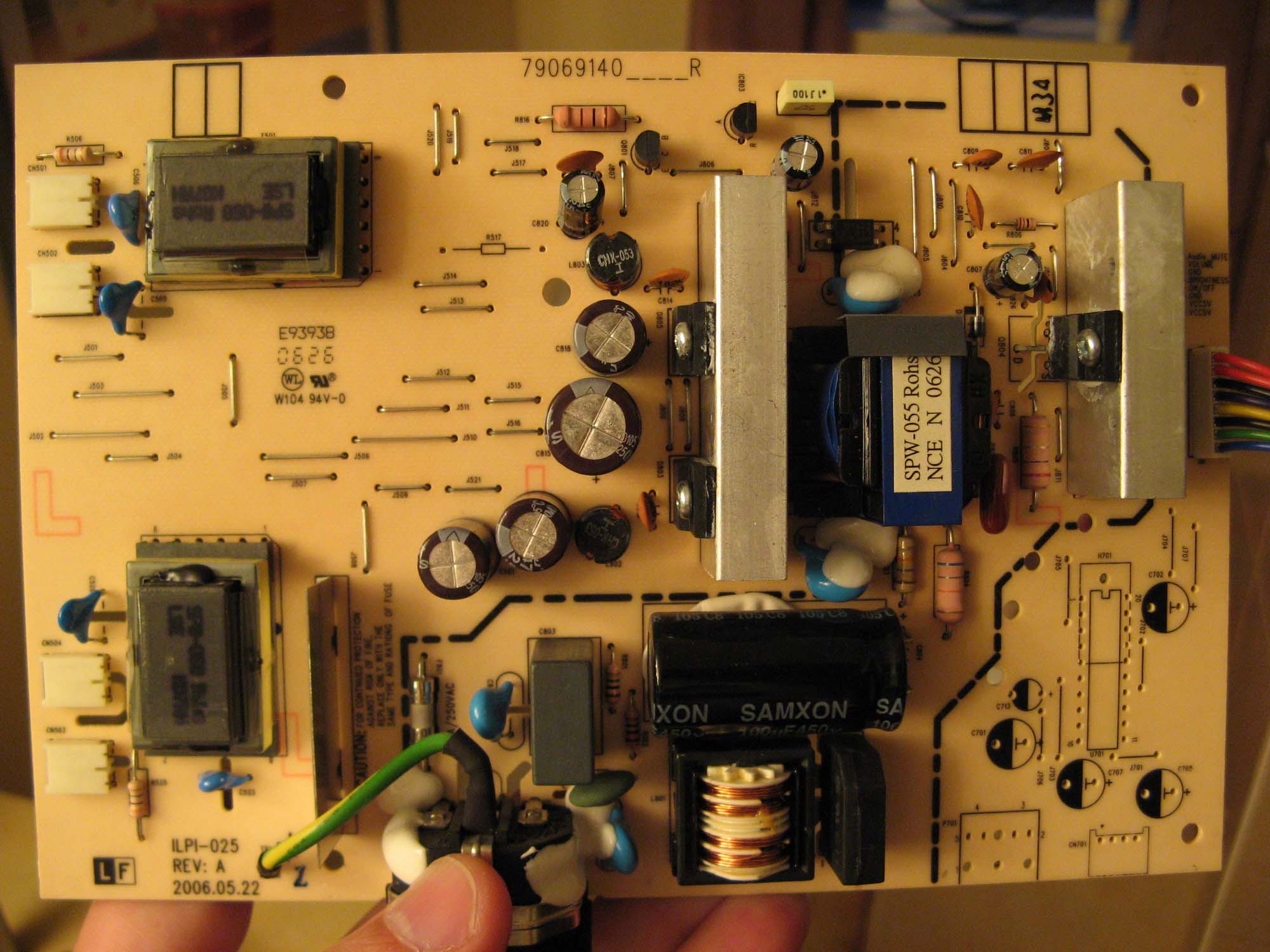

    Typical situation here -- another power board with a problem not obvious to me. This monitor is from my office and was going to the landfill, but I thought I should see if a fix is possible.
    When I first tried it after it had been sitting for several months unused, it worked for 10 minutes before the backlight went off. I did notice a bit of flicker in the screen. Now, it stays on for a second or two before the backlight goes out. The image is still on the screen, just no backlight, and the power LED stays green.
    See what you folks think. This is an interesting BB; it seems one can fix anything provided you have an internet connection and some basic tools ;-)

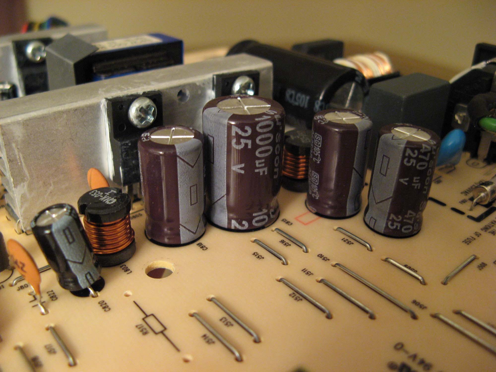

    Re: AL1916W: backlight goes deed after 5s
    Welcome metanoia
    About your problem I would try to replace those Su'scon caps, they are not good brand and even if they look OK it is possible they are deteriorated.
    I would also replace those small black caps while the big Samxon should be ok.
    Check also for dry joint.
    I usually use Panasonic FM but also Panasonic FC are suitable for this board. There are others good brands: Nichicon, Rubycon, Sanyo, UCC ... it is important to choose a low ESR type and 105°C temperature.

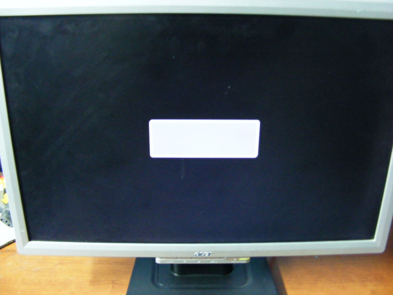

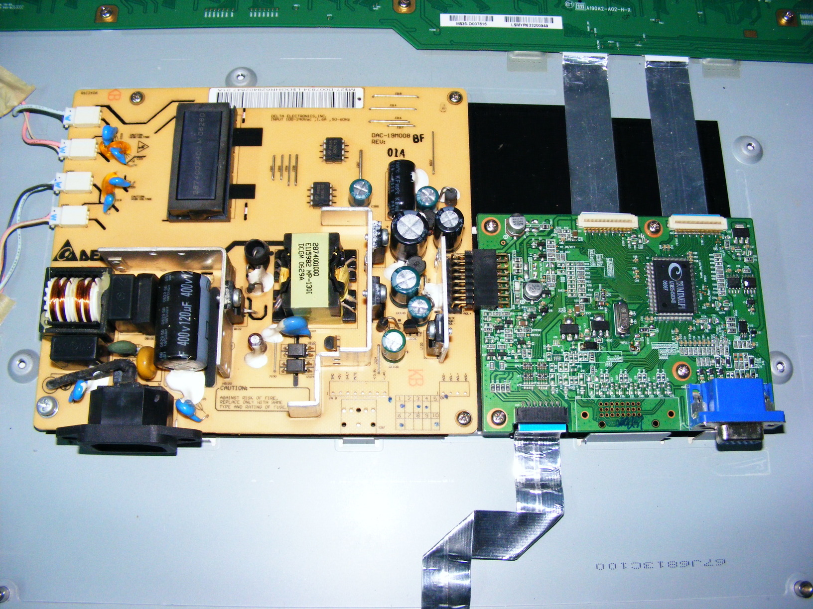

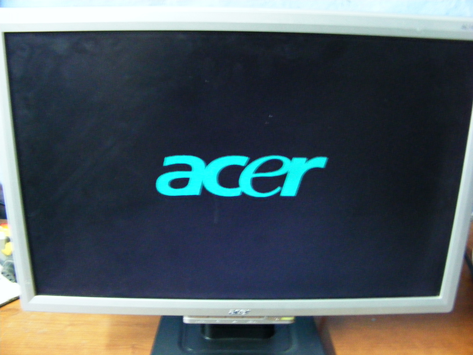

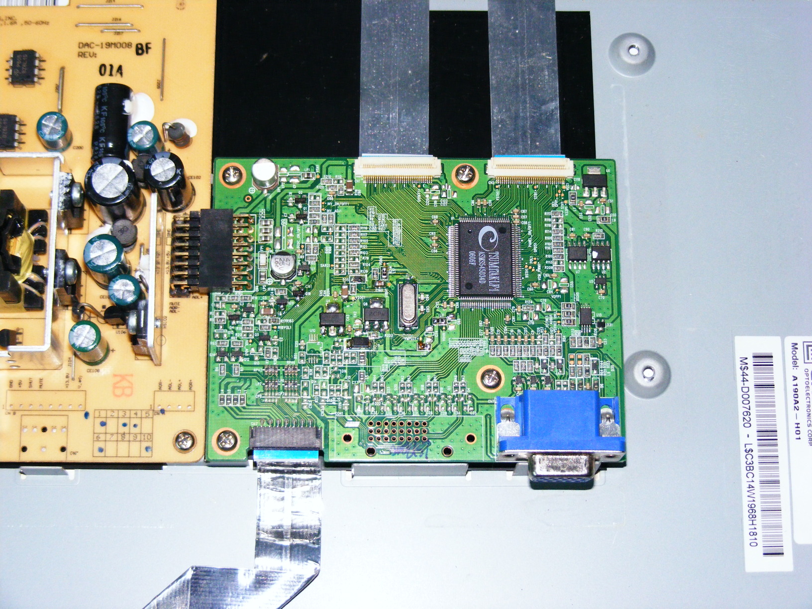

      I figured that I'd resurrect this thread, just because the pictures have already been posted by someone else.
      I have the same monitor, with the same power board assembly. I also have the exact same problem.
      Turn on the monitor, it receives signal, throws up the ACER logo, and blanks out in seconds. All but the 100uF 450V capacitor have been replaced (okay, anything larger than 47uF), and as you can see by the pictures, it doesn't have normal MOSFETs, but does have bridge rectifiers.
      Now, where I might expect to see MOSFETs, there are two giant bricks, marked
      SPW-068 Rohs DARFON 2041M 622010_
      Again - power _is_ getting into the unit. The picture does display correct. The CCFLs appear to be just fine. The issue is that the CCFL's aren't getting enough power to stay charged. If the screen frequency changes for some reason, they _will_ blink back on, then off again as the power is discharged.
      Any suggestions on where to go from here?

          Hello Bookworm
          Gongratulations on the new family member
          The original posting by Metanoia said his had stayed on for 10 Mins after it had been left for some time, and flickered suggesting to me bad caps or CCFL or bad solder joints but we will not know untill he Posts back
          Yours however sounds like the B/Lights are shutting down with the 2 seconds to black problem, As you have replaced caps that leaves bad solder on the Inverter transformers (what you called bricks) bad CCFLs or Mosfets
          You will find the mosfets on solder side of board U501 + U502, one may have short

              OZ9938GN, from what I can see.
              Here's the problem. Looking at _both_ boards (the video controller board, as well as the main inverter board), I see _no_ MOSFETs.
              None.
              The closest I can find is that on the video controller board, there are two LD1117A voltage regulators that look like tiny MOSFETs, but obviously aren't
              There are also two Schottky Barrier Rectifiers (SP10100c and SP1040c) and another similar semiconductor labeled 2761I.
              I'll agree that it sounds like MOSFET problem (I don't think it's the transformers, as then I'd have the top tube running, and not the bottom, or vice versa, rather than both going out together), but I just can't seem to find a MOSFET on the top, bottom, or anywhere else on either board.
              I can try to take larger pictures, but my camera isn't that good in Macro mode.

                          • PlainBill
                            • Feb 2009
                            • 7034
                            Originally posted by raisdfist
                            so did anyone was able to solve this problem? I have two of these monitors here with the exact same problem, all the capacitors looks fine, not bulged at all, backlight and pictures comes on for about 5 secs, anyone can help? I can post pictures if needed
                            5 seconds is an unusually long time, but try this. I've marked up a picture metanoia had posted. If it doesn't match yours, post pictures of the front and back of the power supply / inverter board of your monitor.
                            One of the likely causes is the transformers. Measure the resistance between the points labeled S1 and also between the points labeled S2.

                                    First, a quick summary of how the backlight system works. The inverter controller is the 'brains' of the system. When the logic board sends a 'backlight on' signal the inverter controller drives the CCFLs at full power for a brief period of time - typically 1-2 seconds. but that depends on the designer. After the 'full power' period the controller reduces the power and begins to check the voltage across and current through each CCFL. Error conditions can include voltage too high or too low, current too high or too low. Some designs monitor only one parameter, some monitor more. If any parameter is out of range the controller shuts down the backlights.
                                    This problem is usually referred to as the 'two seconds to black' symptom. Possible causes include an open or shorted transformer, a bad ccfl, a break or arcing in the CCFL wiring, or a problem with the monitoring circuitry.
                                    Now for the fun part. Reassemble the boards so you can perform the following tests with the power on. Plug the CCFL leads into their connectors It is strongly recommended you fasten the inverter / power supply in it's place with the screws. And be careful, in particular the area around the large cap has voltages high enough to knock you on your ass. It is helpful if you have an assistant (one who is not a benneficiary of your life insurance policy) for these tests.
                                    As a precaution, set your DMM on it's highest DV voltage scale. Reduce it's setting if the reading is too low. I would expect all readings to below 10 volts, but we don't always get what we expect, do we?
                                    The process will go something like this. Plug in the monitor. Put the ground (?black) lead of the DMM on one of the mounting screws. Put the red lead on one of the six test points I have marked. (You may find it more convenient to work from the top side of the board. Some of the contact points are at the rear corners of the CCFL connectors.) Have the assistant push the monitor's power button until the CCFLs come on. Note the voltage (reduce the range if the reading is too low). Repeat until you get two readings at the same range for each test point.
                                    Post the readings. Because of the design, I can't predict the readings, but a reading of 0 at the 2 volt range is an indication that something is wrong.
                                    And one last point - what is the part number on IC501 - the inverter controller?
