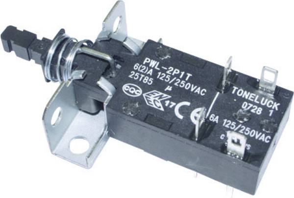

      btw, can you take a picture of the power switch?
      i want to see if it's like the one on the phillips CM8833-II (commodore 1084-s)

        These switches are a nuisance and I can't find replacements anywhere and end up bridging the contacts and turning it on/off at the mains wall plug.

            does that switch normally solder to the board, or have wires on it?
            if it's wires then a replacement wouldnt be hard.
            on the 8833-II i removed the pushbutton from the case and fitted a rocker switch instead.
            i'll get photo's over the weekend if you want.
            not exactly original, but on the 8833-II the switch is at the back out of sight.

              Yes it has wired connections and the switch assembly is screwed onto the plastic casing.

                https://www.rapidonline.com/power-pcb

                      If the small spst part of the switch is not used, this might work: https://www.conrad.com/p/pwl-2p1tl-6...h-1-pcs-701606

                        there is no standby trigger on the CBM monitors, just DPST mains switching.
