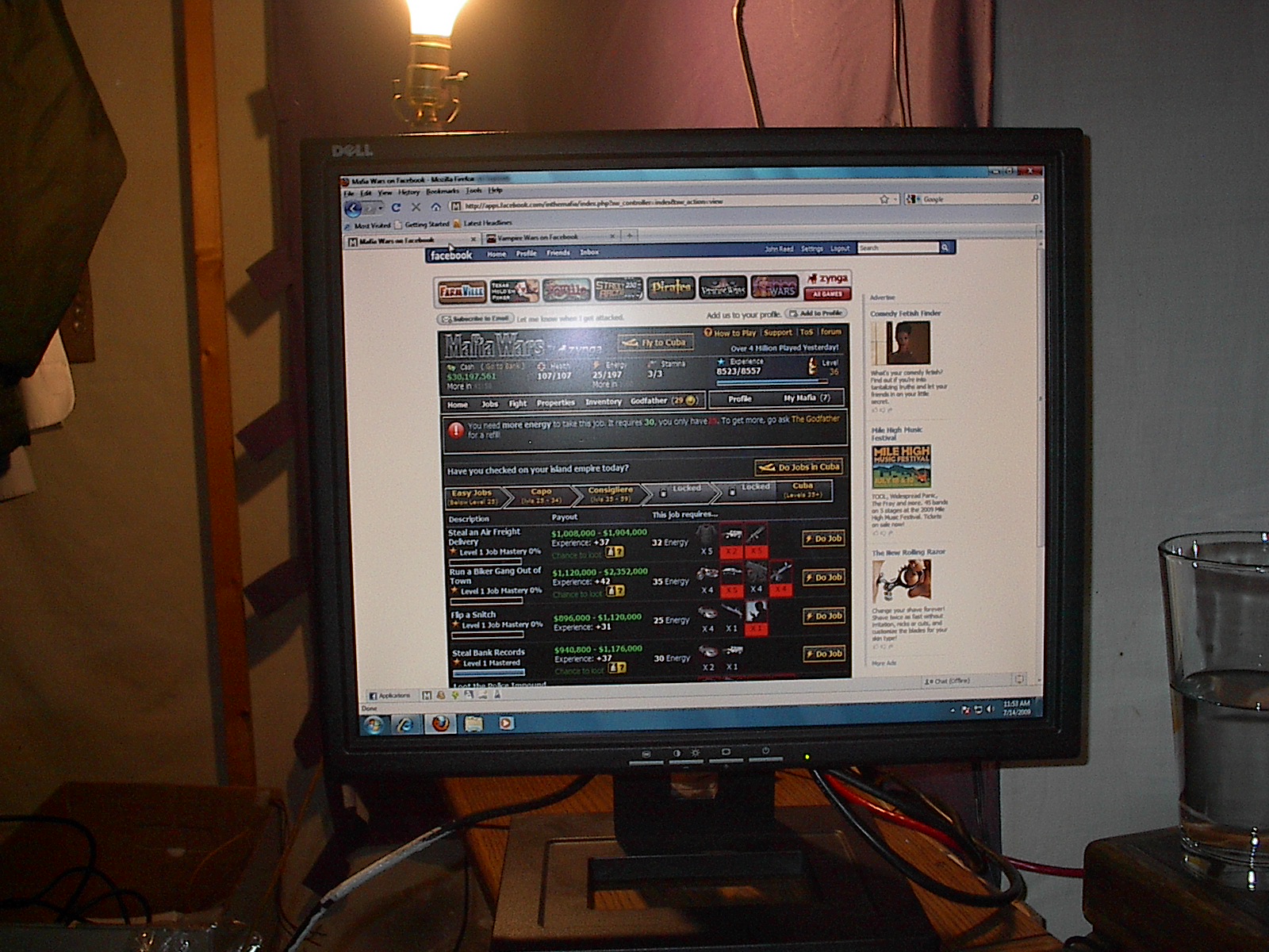

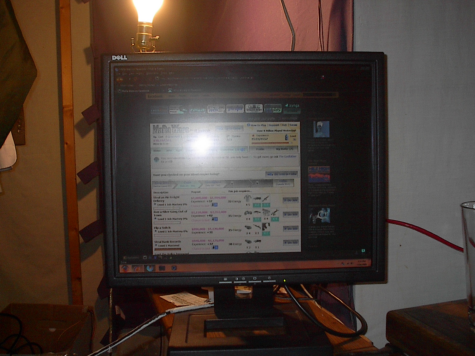

    I've got an older dell 17" monitor that will sometimes change its color. its running in 1280x1024@60hz. I am fairly sure its not the video card or vga cable because I have ran a samsung (710 mp) 17" on the same exact system earlier in the day.
    sometimes it will switch back and forth rather quickly, sometimes the picture stays good and sometimes it look like its monochrome (of course now that I am trying to get a pic of it in "monochrome" its staying good, with a few teases). there seems to be no pattern in the color switching, i.e. it can be bad immediately after turn on or stay good after it has been on for hours. sometimes the screen will just flicker.

    Here are the pics

      Looks like negative film look on that defanged image.
      Well, good idea to open it up (this is Samsung 170n/171n series). Opening case is started by taking the stand off (4 screws at VESA mount) then front up, carefully get under the bezel edge where LCD is and pull up carefully to unsnap hook, work along long sides, till you can get top two corners freed up. Then rest comes easier on bottom, when now apart, don't lift out yet, you have ribbon cable for the buttons snaking over the metal frame to the controller board is in the way. Make sure there are no screws left on back.
      Then carefully flip over on bath towel, lift out the back case. Gently unplug all the stuff except the power switch. Carefully lift LCD/metal frame out of the front bezel carefully because of fragile ribbon cable. Put LCD still facing down on towel. Undo 4 screws to get frame free from the LCD. Lift part-way, Feel around the LVDS cable plug for 2 tan color glue, carefully work these glue off and unplug the connector. Now you can seperate both power supply and controller as a unit from metal frame.
      And can see how the capacitors on the power supply are. (bloated or replace them).

        I've replaced all the caps on the inverter, power supply, and I guess the logic board, I would send pics but my camera really sucks at fine detail
