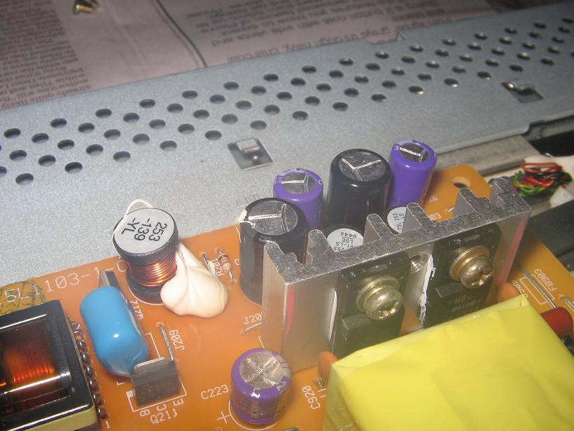

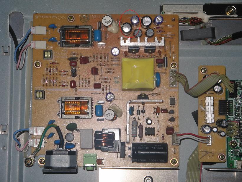

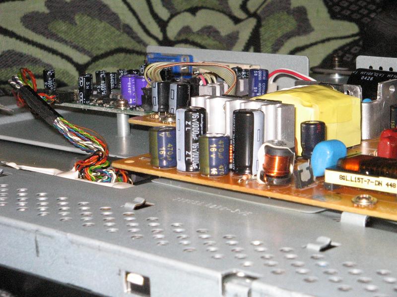

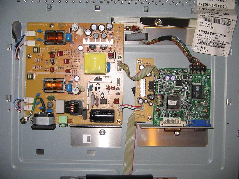

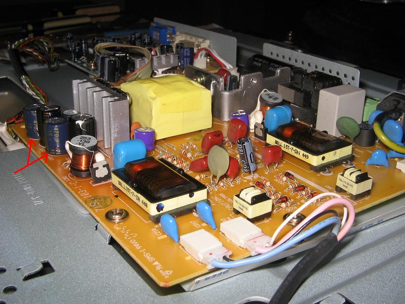

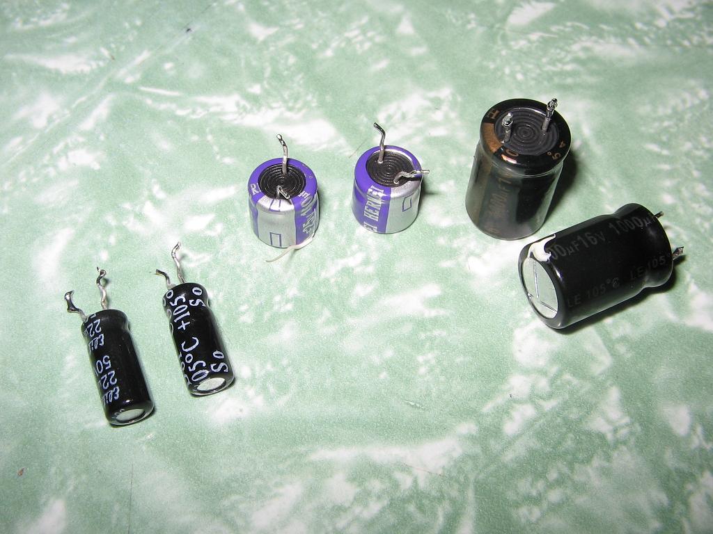

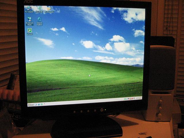

AOC LM726 Power cycling but picture seems OK (when it's displayed) + 2 bulging Hermei
  • Agent24
    I see dead caps
    • Oct 2007
    • 4959
    • New Zealand
    AOC LM726 Power cycling but picture seems OK (when it's displayed) + 2 bulging Hermei
    I have here an AOC LM726 / TFT1780PSA+
    When the picture comes up it seems fine (although this only happens for less than a second)
    Symptoms:
    At plug in, with no signal input I get:
    Green LED for a few seconds
    Changes to Orange LED
    Screen/Backlight flashes/Speakers click
    LED goes off
    Repeat.
    With Signal:
    Green light comes on
    Picture flash on screen and light goes off
    Repeat
    My first thought was that it's a PSU problem but since I have never tried to repair an LCD monitor I'm unsure if this behavior points to a fault in the backlight/inverter or not.
    I opened it up and found 2 bloated Hermei on the PSU/inverter board. 470 uF and 1000 uF. There are actually 2x each of these caps but only 1 of each was bloated.
    I replaced both 470 uF as that was all I had, but I noticed no change in the fault.
    I have attached some photos
    Can I unplug the backlights and power on to see if they are a problem? (Blue and pink wires on left side) Or will this cause damage to the inverter circuit?
    -David VanHorn
  • PlainBill
    • Feb 2009
    • 7034
    Re: AOC LM726 Power cycling but picture seems OK (when it's displayed) + 2 bulging Hermei
    Originally posted by Agent24
    I have here an AOC LM726 / TFT1780PSA+
    When the picture comes up it seems fine (although this only happens for less than a second)
    Symptoms:
    At plug in, with no signal input I get:
    Green LED for a few seconds
    Changes to Orange LED
    Screen/Backlight flashes/Speakers click
    LED goes off
    Repeat.
    With Signal:
    Green light comes on
    Picture flash on screen and light goes off
    Repeat
    My first thought was that it's a PSU problem but since I have never tried to repair an LCD monitor I'm unsure if this behavior points to a fault in the backlight/inverter or not.
    I opened it up and found 2 bloated Hermei on the PSU/inverter board. 470 uF and 1000 uF. There are actually 2x each of these caps but only 1 of each was bloated.
    I replaced both 470 uF as that was all I had, but I noticed no change in the fault.
    I have attached some photos
    Can I unplug the backlights and power on to see if they are a problem? (Blue and pink wires on left side) Or will this cause damage to the inverter circuit?
    It's not recommended, and is unnecessary. Hermei is a known bad brand of cap. The 470 uF are probably for the 12V (inverter) supply, the 1000 for the logic board.
    Remember, a bulging cap is always bad; one that isn't bulging isn't necessarily good. I STRONGLY suggest you replace all of the Hermei caps (except the large 450 volt cap) with new Panasonic FCs. I recommend buying from Digi-Key, you'll get fresh product and quick shipping. The whole set of caps should cost you about $10.00, including shipping.
    PlainBill
    • Agent24
      I see dead caps
      • Oct 2007
      • 4959
      • New Zealand
      Re: AOC LM726 Power cycling but picture seems OK (when it's displayed) + 2 bulging Hermei
      Why is it (unplugging the CCFL) unnecessary?
      After reading some other posts, I would have thought that a faulty lamp drawing excess current could be tripping protection circuitry? (or is this not possible?)
      If unplugged, I would assume the monitor may start but without backlights
      I know Hermei are rubbish and this board also uses Elite and maybe some other junk too (didn't look too closely)
      Do you really think even just 2 bad caps could cause this kind of problem? (I think it's the way they're positioned - right above the heatsink for the rectifiers, with the monitor standing up heat would rise right up onto them)
      -David VanHorn
      • Bobdee
        • Jun 2008
        • 461
        Re: AOC LM726 Power cycling but picture seems OK (when it's displayed) + 2 bulging Hermei
        Originally posted by Agent24
        Why is it (unplugging the CCFL) unnecessary?
        After reading some other posts, I would have thought that a faulty lamp drawing excess current could be tripping protection circuitry? (or is this not possible?)
        If unplugged, I would assume the monitor may start but without backlights
        I know Hermei are rubbish and this board also uses Elite and maybe some other junk too (didn't look too closely)
        Do you really think even just 2 bad caps could cause this kind of problem? (I think it's the way they're positioned - right above the heatsink for the rectifiers, with the monitor standing up heat would rise right up onto them)
        yes it will shut down if it draws excess current, but the reverse applies as well
        It will shut down if too little is drawn
        disconnect 1 or 4 tubes it shuts down
        take Bills advice those caps are your problem, they are bad and no doubt the problem
        • Agent24
          I see dead caps
          • Oct 2007
          • 4959
          • New Zealand
          Re: AOC LM726 Power cycling but picture seems OK (when it's displayed) + 2 bulging Hermei
          I'm compiling an order for various capacitors to send off to RS. Since they have a minimum order of 5 of any type of capacitors, I'd rather do a whole lot at once. Plus then I only have to pay for shipping once.
          I'll post back when I've done that and see what happens...
          -David VanHorn
          • EGuevarae
            • Nov 2008
            • 1336
            Re: AOC LM726 Power cycling but picture seems OK (when it's displayed) + 2 bulging Hermei
            Originally posted by Agent24
            I'm compiling an order for various capacitors to send off to RS. Since they have a minimum order of 5 of any type of capacitors, I'd rather do a whole lot at once. Plus then I only have to pay for shipping once.
            I'll post back when I've done that and see what happens...
            RS?
            Radioshack?
            Man, go to DigiKey instead.
            There are 10 kind of people in this world: those that understand binary, and those who don't.
            • ASUS ROG Maximus IX Code
            • Intel Core i5-7600K 3.8GHz
            • 16gb GSKILL TridentZ RGB DDR4-3200
            • 1 M2 SSD + 2 WD Blue 1TB (Mirrored)
            • Windows 10 Pro x64
            • GeForce GT1050
              2 x Acer KA240H + 1 Vewsonic VP2130 21 (a cap replacement job )
            • Agent24
              I see dead caps
              • Oct 2007
              • 4959
              • New Zealand
              Re: AOC LM726 Power cycling but picture seems OK (when it's displayed) + 2 bulging Hermei
              Not Radioshack, RS Components. http://newzealand.rs-online.com/web/
              Also known as Radio Spares, Radionics and Allied Electronics (in USA)
              Pretty much the only place to get decent brand (Panasonic/Rubycon etc) capacitors here in New Zealand.
              Jaycar might still do Samxon but per capacitor the price is higher, so if I do a bulk order (because of the 5 piece minimum qty) from RS it's cheaper
              Last edited by Agent24; 07-16-2009, 08:51 PM.
              -David VanHorn
              • EGuevarae
                • Nov 2008
                • 1336
                Re: AOC LM726 Power cycling but picture seems OK (when it's displayed) + 2 bulging Hermei
                Originally posted by Agent24
                Not Radioshack, RS Components. http://newzealand.rs-online.com/web/
                Also known as Radio Spares, Radionics and Allied Electronics (in USA)
                Pretty much the only place to get decent brand (Panasonic/Rubycon etc) capacitors here in New Zealand.
                Jaycar might still do Samxon but per capacitor the price is higher, so if I do a bulk order (because of the 5 piece minimum qty) from RS it's cheaper
                Ohh. Sorry, but I would have hated me until the end of the time if it was RadioShack and I didn't warn you... it was in the better of the intentions.
                There are 10 kind of people in this world: those that understand binary, and those who don't.
                • ASUS ROG Maximus IX Code
                • Intel Core i5-7600K 3.8GHz
                • 16gb GSKILL TridentZ RGB DDR4-3200
                • 1 M2 SSD + 2 WD Blue 1TB (Mirrored)
                • Windows 10 Pro x64
                • GeForce GT1050
                  2 x Acer KA240H + 1 Vewsonic VP2130 21 (a cap replacement job )
                • Agent24
                  I see dead caps
                  • Oct 2007
                  • 4959
                  • New Zealand
                  Re: AOC LM726 Power cycling but picture seems OK (when it's displayed) + 2 bulging Hermei
                  No worries, I appreciate your concern. I know I wouldn't want me to buy from RadioShack either
                  My fault really I guess, though, since I know most people here say RS when they mean RadioShack
                  -David VanHorn
                  • Agent24
                    I see dead caps
                    • Oct 2007
                    • 4959
                    • New Zealand
                    Re: AOC LM726 Power cycling but picture seems OK (when it's displayed) + 2 bulging Hermei
                    I decided to do some more tests... (note: this is with the bad capacitors still in there)
                    I tried all the backlights with my case mod inverter and they all seemed to be OK
                    I tried disconnecting the audio board but this didn't change anything
                    Then I tried disconnecting the signal cable that goes to the LCD panel and noticed this:
                    Power on -> Light goes green
                    Then light goes orange
                    Then screen comes on bright white (but for longer than before, maybe 4 seconds)
                    Then turns off BUT orange light STAYS ON and there is no repeat cycling of power etc.
                    Plug that connector back in and then the same problem as before.
                    What can this mean?
                    -David VanHorn
                    • EGuevarae
                      • Nov 2008
                      • 1336
                      Re: AOC LM726 Power cycling but picture seems OK (when it's displayed) + 2 bulging Hermei
                      Originally posted by Agent24
                      I decided to do some more tests... (note: this is with the bad capacitors still in there)
                      I tried all the backlights with my case mod inverter and they all seemed to be OK
                      I tried disconnecting the audio board but this didn't change anything
                      Then I tried disconnecting the signal cable that goes to the LCD panel and noticed this:
                      Power on -> Light goes green
                      Then light goes orange
                      Then screen comes on bright white (but for longer than before, maybe 4 seconds)
                      Then turns off BUT orange light STAYS ON and there is no repeat cycling of power etc.
                      Plug that connector back in and then the same problem as before.
                      What can this mean?
                      With caps like the ones installed, it can't be told. That is the first step to rule out a PSU failure. You just reduced the load the PSU is under (you removed the +5v load that goes from Logic board - which in turn draws from PSU- to the pane itself). Good thing is that the lamps are good (or so it seems).
                      There are 10 kind of people in this world: those that understand binary, and those who don't.
                      • ASUS ROG Maximus IX Code
                      • Intel Core i5-7600K 3.8GHz
                      • 16gb GSKILL TridentZ RGB DDR4-3200
                      • 1 M2 SSD + 2 WD Blue 1TB (Mirrored)
                      • Windows 10 Pro x64
                      • GeForce GT1050
                        2 x Acer KA240H + 1 Vewsonic VP2130 21 (a cap replacement job )
                      • Agent24
                        I see dead caps
                        • Oct 2007
                        • 4959
                        • New Zealand
                        Re: AOC LM726 Power cycling but picture seems OK (when it's displayed) + 2 bulging Hermei
                        I know it's been a long time... 4 months! but I bring an update: eventually got around to doing this today...
                        So, I replaced everything on the PSU/Inverter board (except the main filter capacitor) with a mixture of Panasonic and Rubycon
                        Fired it up and it worked first time! Still going even several hours later too...
                        Attached are some photos for your viewing pleasure
                        (Pity the design sucks though, with the rectifier heatsink directly underneath the capacitors )
                        But then the lamps will probably die before the new capacitors do
                        -David VanHorn
                        • Wizard
                          • Mar 2008
                          • 2296
                          Re: AOC LM726 Power cycling but picture seems OK (when it's displayed) + 2 bulging Hermei
                          Always replace all if you cannot check with ESR meter especially on generic monitors (even it is HP, acer etc) due to monitor made by some one else.
                          Cheers, Wizard
                          • Agent24
                            I see dead caps
                            • Oct 2007
                            • 4959
                            • New Zealand
                            Re: AOC LM726 Power cycling but picture seems OK (when it's displayed) + 2 bulging Hermei
                            Do you think I should replace that 400volt capacitor too?
                            It IS a Hermei but I thought these ones usually didn't need it - that and the fact they cost $15 from RS with a minimum qty of 5 put me right off...
                            -David VanHorn
                            • Agent24
                              I see dead caps
                              • Oct 2007
                              • 4959
                              • New Zealand
                              Re: AOC LM726 Power cycling but picture seems OK (when it's displayed) + 2 bulging Hermei
                              I have another question, do you think it's OK to replace the Hermei 150uF 25v LZ with this:
                              http://newzealand.rs-online.com/web/...duct&R=3150704
                              The thing is the Hermei apparently can take 700mA ripple while the Panasonic only 555mA...
                              -David VanHorn
                              • Bobdee
                                • Jun 2008
                                • 461
                                Re: AOC LM726 Power cycling but picture seems OK (when it's displayed) + 2 bulging Hermei
                                Originally posted by Agent24
                                Do you think I should replace that 400volt capacitor too?
                                It IS a Hermei but I thought these ones usually didn't need it - that and the fact they cost $15 from RS with a minimum qty of 5 put me right off...
                                I have never replaced a big filter cap ever, it has always been accepted and
                                recomended on this forum to leave out the big cap as they very rarely fail, only recently in the the last 6-8 wks have one or two members recomended replacing it, At the cost you got to pay is it worth it, you will know what to fix if it Ever failed (no doubt now I have started something)
                                • PCBONEZ
                                  Grumpy Old Fart
                                  • Aug 2005
                                  • 10661
                                  Re: AOC LM726 Power cycling but picture seems OK (when it's displayed) + 2 bulging Hermei
                                  That's right. - Those caps hardly ever go bad.
                                  When they do there's usually a power surge involved or some other AC power problem.
                                  Sometimes I replace them anyway just to have done every cap.
                                  Sometimes I replace them to get a 105c rated cap in there if the unit looks like it might have heat/cooling issues.
                                  Most of the time I just leave them alone.
                                  Mann-Made Global Warming.
                                  - Dr Seuss
                                  • Agent24
                                    I see dead caps
                                    • Oct 2007
                                    • 4959
                                    • New Zealand
                                    Re: AOC LM726 Power cycling but picture seems OK (when it's displayed) + 2 bulging Hermei
                                    What do you think about replacing the hermei 700mA with panasonic 555mA though?
                                    I should probably get some better ones shouldn't I?
                                    -David VanHorn
                                    • PCBONEZ
                                      Grumpy Old Fart
                                      • Aug 2005
                                      • 10661
                                      Re: AOC LM726 Power cycling but picture seems OK (when it's displayed) + 2 bulging Hermei
                                      Yes. Get better caps.
                                      Mann-Made Global Warming.
                                      - Dr Seuss
                                      • high-tech
                                        Samsung UN55F7050AFXZA ver. TD01 power cycling
                                        by high-tech
                                        Hello everybody, I could use some help on this one... It's got me guessing...
                                        I took pictures of all the boards and the pin out of the connector on the power supply that goes to the main board... I measured all the pins in relation to chassis ground, here are the result.
                                        (B13v)1. 12.7 volts cycling (Vamp) 2. 12.7 volts cycling
                                        (B13v)3. 12.7 volts cycling (PWM5) 4. 1.0 volts cycling
                                        (OD_LE)5. 2.8 volts cycling (PWM4) 6. 0.9 volts cycling
                                        (OD_ON)7. 2.8 volts cycling (PWM3) 8. 0.9 volts cycling
                                        9. ground (PWM2) 10. 0.9 volts cycling...
                                        09-15-2020, 03:39 PM
                                      • usbdevice
                                        Acer X223HQ (Version Bbd) on/off-power-cycling
                                        by usbdevice
                                        Hi all
                                        There's two other threads about this monitor with seemingly the same problem. The problem was resolved in one case by replacing the entire PSU board and in the second one by replacing an unknown IC.
                                        https://www.badcaps.net/forum/showthread.php?t=50657
                                        https://www.badcaps.net/forum/showthread.php?t=40512
                                        The first one has pictures of the pcbs and I noticed that there's one IC and assorted caps not populated on mine (but the PCB itself looks identical) so I thought that'd warrant a new thread.
                                        It's my dad's old monitor. He...
                                        08-05-2022, 02:21 AM
                                      • dbuergi
                                        MacBook A2141 one USB port dead and one power cycling
                                        by dbuergi
                                        I got a 16inch MacBook Pro showing 5v and 0,3a on the left ports and right side has one power cycling and one showing nothing. The one cycling shows 30c under thermal camera. Surrounding components show no corrosion or any shorts.
                                        Any ideas what to check next? The whole board looks clean compared to the other A2141s i saw....
                                        04-25-2025, 11:40 AM
                                      • mon2
                                        A2141 820-01700 Power cycling (DFU worked ok)
                                        by mon2
                                        Hi. Working on an A2141 that is power cycling. Powers up fine (20V @ 3.1A peak) -> fan spins ok and then at a higher speed (after we removed the trackpad so the sensors are missing) -> chimes ok but after the high fan spin -> power cycles and repeats this loop. We did manage to DFU the unit with revive mode (4/4 steps completed ok) -> resulted in a brief padlock graphic before power cycling. Unable to toggle the keycaps led since the boot does not reach this far of the cycle.
                                        Q: Does the DFU process validate that the nand flash is OK ? We do not wish to restore this board...
                                        11-24-2023, 12:17 PM
                                      • valvashon
                                        Samsung UN55FH6030: random power cycling
                                        by valvashon
                                        Samsung UN55FH6030, perfect size for my office and does OTA well but isn't a smart TV. That's OK because I am a TV station engineer and only need it for OTA monitoring.
                                        About a month ago it started power cycling itself once or twice a day and now it's nearly continuous once it's been on for a few minutes. Changing channels would really start it cycling and it would take several minutes to stabilize but now it's just doing it almost non-stop without changing channels.
                                        Once I disconnected the antenna I found that I could change channels with no issues. My guess is...
                                        10-20-2023, 09:59 AM
