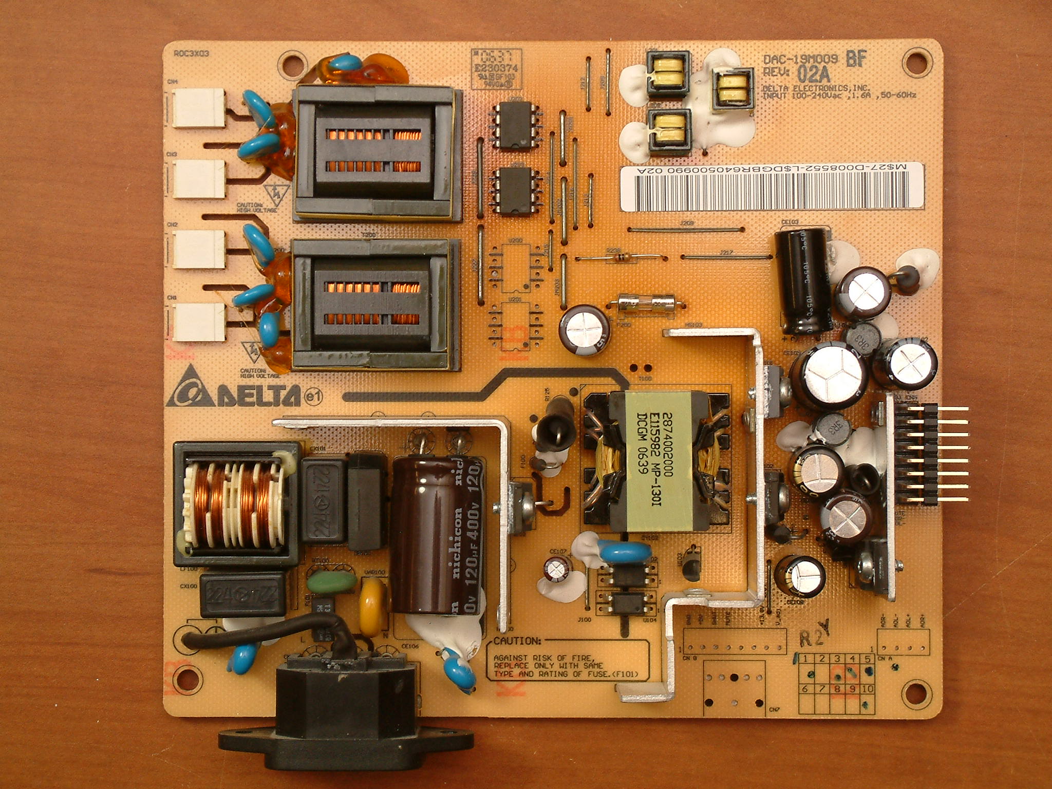

    There are a few threads on the forum which talk about bad caps in the 19M009. Initial issue in July 2015 was a bad rectifier which was replaced along with the main 120uF 400V cap. Since C200 and CE103 were questionable bulging they were also replaced with Nicicon's from Digikey in July 2015.
    In July 2018 the monitor stated going black after about 3 to 5 MINUTES. There is also a momentary buzzing/chirping sound when the monitor first starts until an image is displayed and when it goes black. I've opened the unit again and pulled the DAC. There are no obvious bad caps. Notice the heat discoloration around U202 and U203, it was there before the repair also. When powering the unit the temp on U203 runs about 92 F while U202 is 105 F. I've read that these P605's are like the HOT of the inverter and can generate a lot of heat. Should they be running different temps? But they seem to check ok with resistance in circuit. I have a 19M008 schematic, not a 19M009 but I believe the layouts are similar and only the component labels are slightly different.
    I'm not sure where to start. Should I test voltages with digital VM?
    Looking for help on this reliable daily user from my spouse. She is using a Dell 19" 4:3 in the meantime and misses her wider 16:9 screen. Happy wife is happy life, and my wife is not happy right now... So any help is appreciated.
    Cheers, BrianA_MN

              So in this monitor it appears a CCFL set is failing after further testing. The failing unit is probably the top set because the screen is not as bright on top. I had a spare old twin lamp set, which I plugged in to replace the top set. I then turned up the brightness to 90/100 and the monitor stayed on in excess of two hours. The interesting thing is if I turn the brightness down to 30/100 and the contrast up to 90/100 the lamps will still stay on in excess of two hours also. My wife tends to have her monitors blank-out after one hour.
              I'm still trying to figure-out the chirping. There is still a chirp when powering up or the monitor goes to sleep even with the replacement set in place. If I touch the outer lamp transformer in the dark I do see a discharge between my finger tip and the winding, which I don't see with the lower transformer. Perhaps the transformer is reading correct resistance but failing only under higher voltage demands and the internal short finds my finger or maybe I should attempt out-of-circuit measurements?
              This Westinghouse LCM-22w2 (note corrected model) has a Chi Mei A220Z1-H01 LCD screen assembly. It uses a Chi Mei M220Z1-L03 lamp set from CCFLWarehouse dot com. The lamp set is made of 2 lamps with total length of 490mm including silicon end caps.
              This monitor is the similar to both ACER2216W or ViewSonic VX2235W. I have used the available online service manuals to help, along with CapLeaker's help of course.

                        I did find a cracked bulb on the upper, which was causing the screen to blank as if it was two seconds to black. Interesting that it was still lighting with a lower voltage. I order replacement bulbs from CCFL Warehouse. Actually found the correct bulb with leads in Closeout section. I replaced the two upper bulbs and now the top is brighter than the bottom! Probably means that the lower bulbs are starting to fail also, so I'll replace them next.
                        I'm also seeing a bright spot in the corners for the new bulbs, can that be the result of not getting the bulb in the right place behind all fresnels?
                        I also still have the chirping and an unsolved problem.
                        First the chirping. I'm going to try soldering any potential cold joints. But think the output transformer may have a issue. I'm just trying to figure out where to get a replacement, since the 19M088 uses one transformer not two?
                        The unsolved issue: When the monitor goes in to energy saving mode then on wake (by pushing the mouse) the image comes back but the image is shuifted left by 2 inches. On switching to VGA terminal mode and then back to XOrg mode the image shifts back to normal. The image shift doesn't happen with a Dell 1908 monitor. Is that a power issue also?

                              So I ordered replacement caps from Digi-Key for the ones not previously replaced. I didn't want to tear down the monitor so relied on a listing from another site of the size for the caps and the Delta DAC 19M008 schematic parts list. The DAC 19M008 was built with 220uf 25v caps for c200, ce101 and ce108. But the same capacitors on the DAC 19M009 are all 330uf 25v as found when I removed the board.
                              So I need a little help. Can I use the 220uf or do I need to re-order to the 330uf caps?
                              These caps are all part of the power supply, but appear to be used for establishing power voltages. One friend who works more on timers, thought the 220uf would be ok but the ripple of the voltage wouldn't be as clean. Maybe that is one of the improvements Westinghouse requested for this 19M009 PSU compared to ViewSonic and Acer monitors using the 19M008 PSU?
                              Thanks in advance.

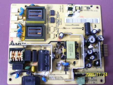

                                  • John Graham
                                    • Jun 2024
                                    • 16
                                    Cheers, BrianA_MN
                                    Hi BrianA_MN,
                                    I also have a Delta DAC-19M009. You mention that you changed CE103. Do you by any chance remember the value of the cap? I'm trying to repair my board but the glue that holds CE103 down stripped the value of the cap. All I can read is the voltage (10V). But I can see a 2 (then reading stripped) and F and 25V. The schematic I got for the 19M008 shows a 1KuF 25V. The photo you posted is the exact one I have of my PSU board including the Rev. I know this is an old post, but any help will be appreciated.
                                    Sincerely,
                                    John Graham.
                                    • bvamunds
                                      • Jun 2015
                                      • 25
                                      John, sorry about the delay in responding. I pretty much relied on the repair from a site ccl-la.com, which isn't online now, but I give them credit for creating the original repair.
                                      Check the picture for which capacitor you are trying to repair. The capacitors you need to replace are circled in the picture attached. Use solder braid and remove the bad caps and solder in the replacement caps. Be sure to replace them in the proper polarity, you will see a stripe on the side. The stripe is the negative lead. Just reinsert the new caps with the stripe going the same direction as the old ones come out. The DAC-19M009 and DAC-19M005 are the same, one has the audio and the other does not. The values and part locations are listed here:
                                      220uf 25v – Number 1,3 and 7
                                      1000uf 25v- Number 2 and 5
                                      1000uf 10v- Number 6
                                      2200uf 10v- Number 4
                                      330uf 25v – Number 8
                                      Cheers, BrianA_MN
