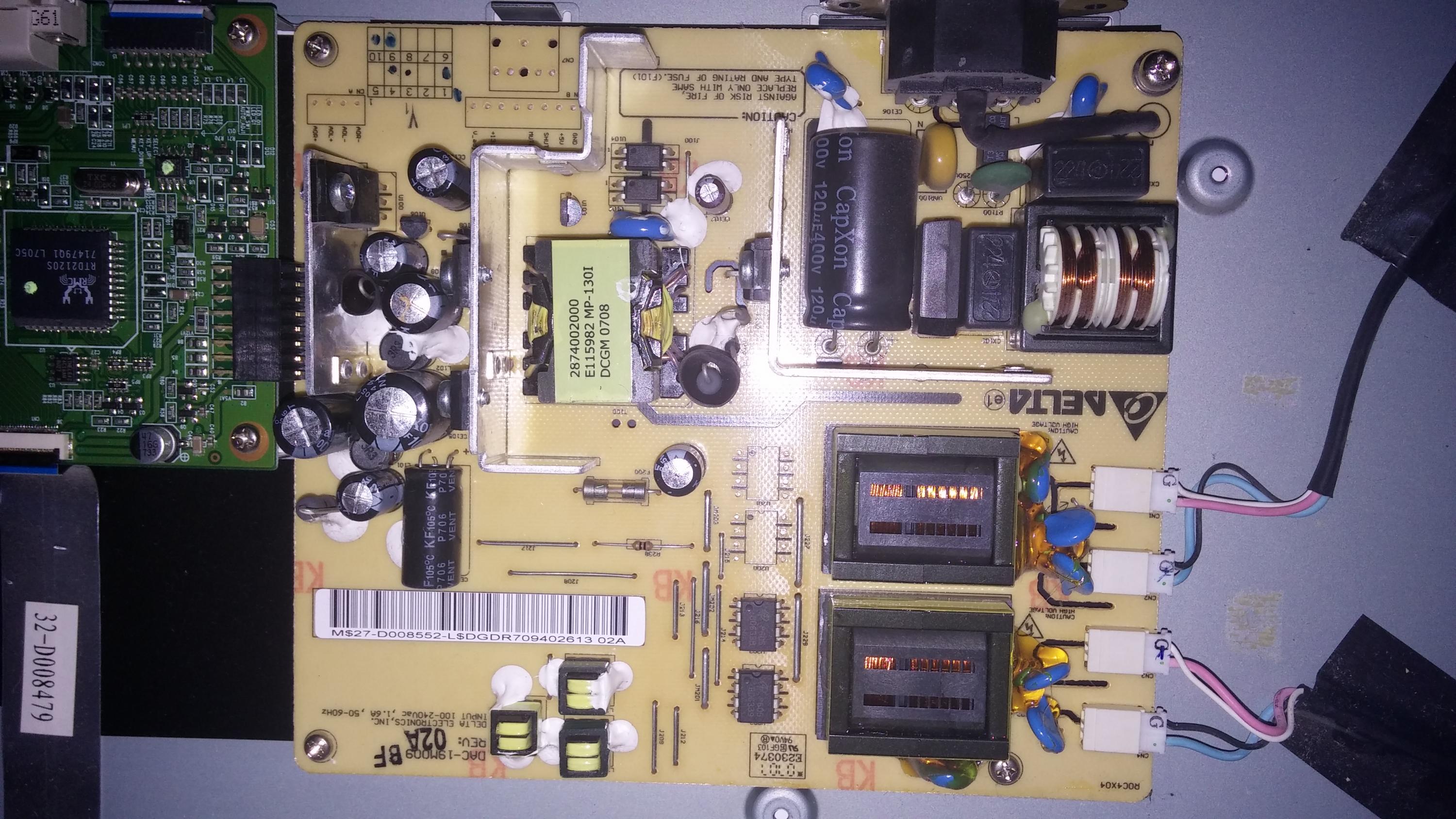

    Hey everyone,
    This monitor is making a high pitch sound when the display is on.
    Here is the list of visible caps:
    • (1) 400v 120uF - 31.3mm tall x 18.2mm diameter / 0621(M) 105C - (AQ)P
    • (3) 25v 220uF - 12.6mm tall x 8.25mm diameter / CapXon KF P620 Vent
    • (1) 25v 330uF - 15mm tall x 8.31mm diameter / 0613(M) 105C - (HD)P
    • (1) 10v 2200uF - 20.4mm tall x 13.2mm diameter / CapXon KF P608 Vent
    • (1) 50v 22uF - 11.95mm tall x 5.22mm diameter / GL 105C P616
    • (2) 25v 1000uF ( one is also on its side) - 20.78mm tall x 10.58mm diameter / CapXon KF P620 Vent
    • (1) 10v 1000uF - 17.11mm tall x 10.28mm diameter / 0619 (M)
    I also made a short youtube video where I am finding the source of the sound
    https://youtu.be/xFAf7cpOU4U

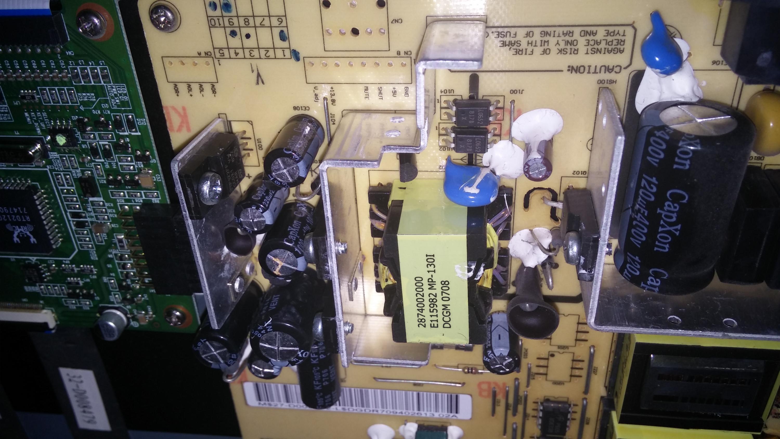

    Obviously you need to replace all those CapXon caps that are bulging and leaking electrolyte everywhere!
    • cangerules
      • Mar 2016
      • 7
      • canada
      Re: ACER AL2216W high pitch sound, DAC-19M009 inside
      Should I replace all of them?
      • Per Hansson
        • Jul 2005
        • 5895
        • Sweden
        Yes, they all appear to be bulging so replace with good caps of equal ESR & Ripple rating.
        In any case when replacing caps all of the same brand/series are always replaced.
        Otherwise you will just need to go back in a month and redo the job...

              How much can I change the ripple current? for example
              I am looking up options for the first capacitor
              Capacitor on my board I need to replace
              Options to choose from
              I can choose from a 730mA or a 1.22A capacitor, 730 is closest to my current 780mA capacitor but it still sounds kinda high compared to it. Should I match the mA perfectly and choose a different size?
              • Per Hansson
                • Jul 2005
                • 5895
                • Sweden
                With ripple current you can always go up, higher is better. (But never go down).
                It's the ESR that you need to match more closely. (Ideally don't drift more than 20% unless you know the circuit can handle it).
                But for an input capacitor it does not matter, they are general purpose caps.
                Also realize you can go up in voltage, Digikey has one at 420v and 3 more at 450v

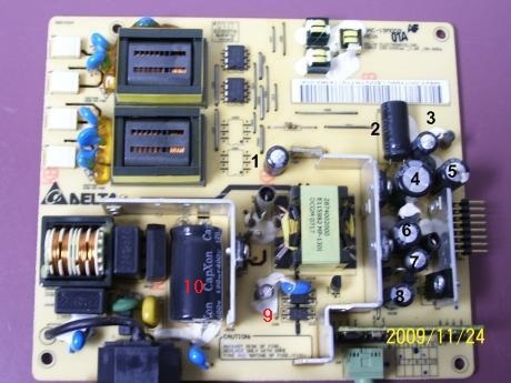

                      I have taken the liberty of adding notes beside your list of capacitors for people (like me) who stumble on this site and come across your post - the notes are clarifications for the cap Numbers on the board (specifically the DAC-19M009 BF, Rev 01A (other boards will differ).
                      • (1) 400v 120uF - 31.3mm tall x 18.2mm diameter / 0621(M) 105C - (AQ)P - Ripple Capacitor CE106 (10) (see photo attached)
                      • (3) 25v 220uF - 12.6mm tall x 8.25mm diameter / CapXon KF P620 Vent - Capacitors C200, CE103, CE101 (1), (3), (7) (see photo attached)
                      • (1) 25v 330uF - 15mm tall x 8.31mm diameter / 0613(M) 105C - (HD)P - Capacitor CE108 (8) (see photo attached)
                      • (1) 10v 2200uF - 20.4mm tall x 13.2mm diameter / CapXon KF P608 Vent - Capacitor CW105 (4) (see photo attached)
                      • (1) 50v 22uF - 11.95mm tall x 5.22mm diameter / GL 105C P616 - Capacitor CE107 (9) (see photo attached)
                      • (2) 25v 1000uF ( one is also on its side) - 20.78mm tall x 10.58mm diameter / CapXon KF P620 Vent - Capacitors CE103, CE102 (2), (5) (see photo attached)
                      • (1) 10v 1000uF - 17.11mm tall x 10.28mm diameter / 0619 (M) - Capacitor CE109 (6) (see photo attached)​
                      Credit is due to BrianA-MN for the photo attached. - see https://www.badcaps.net/forum/troubl...2w3-dac-19m009 Post #19
                      Credit is due to cangerules for identifying all the (electrolytic) caps - see https://www.badcaps.net/forum/troubl...-19m009-inside Post #1
                      My gratitude to both BreanA_MN and cangerules for making a daunting project, much easier.
                      Sincerely,
                      John Graham.
