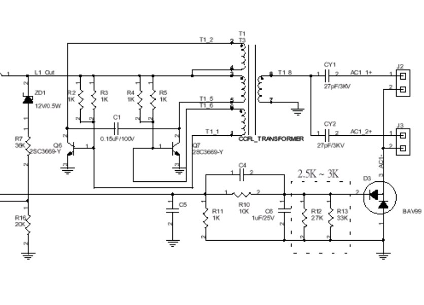

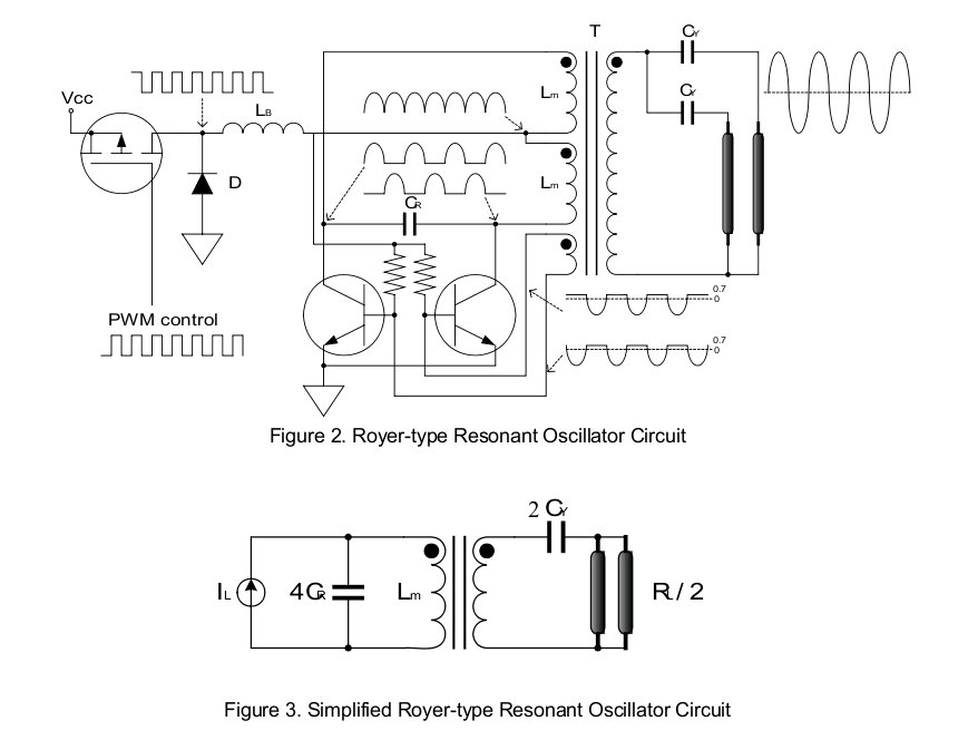

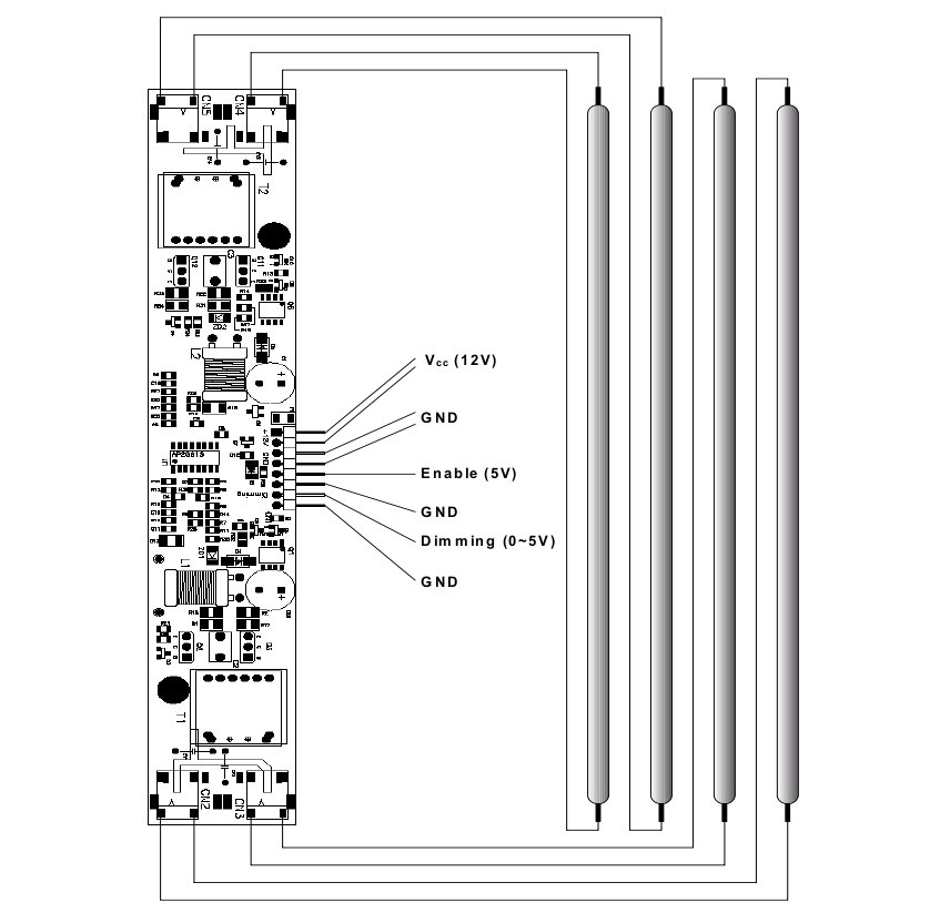

    I also found a few photos that would be of help to folks new to CCFL's,
    Inverters, and LCD Monitor Internal hardware. I wish I had stumbled across
    them before my journey began.
    I have attached the photos for others to view, in hopes they help.
