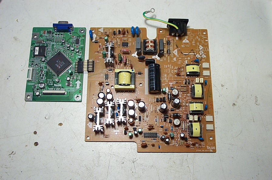

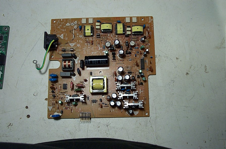

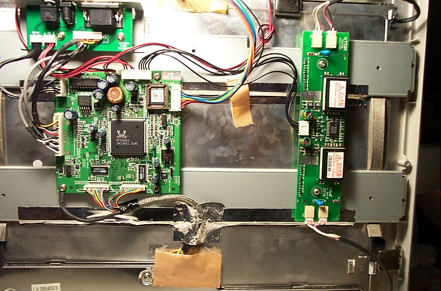

      Hi eguevarae, thanks for the welcome and reply, here are some images, the ADI one, I could be wrong and no dought am, but I think the small board to the right could be my trouble, and of course there is the BenQ I replaced the fuse today I couldn't get the ceramic one so I just got the glass one, any way still only getting the green led to say it is on but black screen, I hope these pics are what you were asking for, if not please let me know. Peace

        Right. The right side board is the inverter (ADI). What brand/series/rating are the two caps at the inverter's input? I fixed a similar inverter changing the caps for two Nichicons 150uf 16v. The monitor just flickered a lot, and after a while it just turned off. After the recap, no problems , and it has been working 24/7 for a month.
        As for the BenQ, you should check the 5707s, check the fuse at the inverter's section input, and resolder all the transformer's pins as a start. I can't see any bulged cap on the pics. If you post the info on them, someone will jump in with a replacement suggestion in no time.
        There's a great thread in the forum for the Q7T3/4 around. I think the credit goes to Davmax for that one.

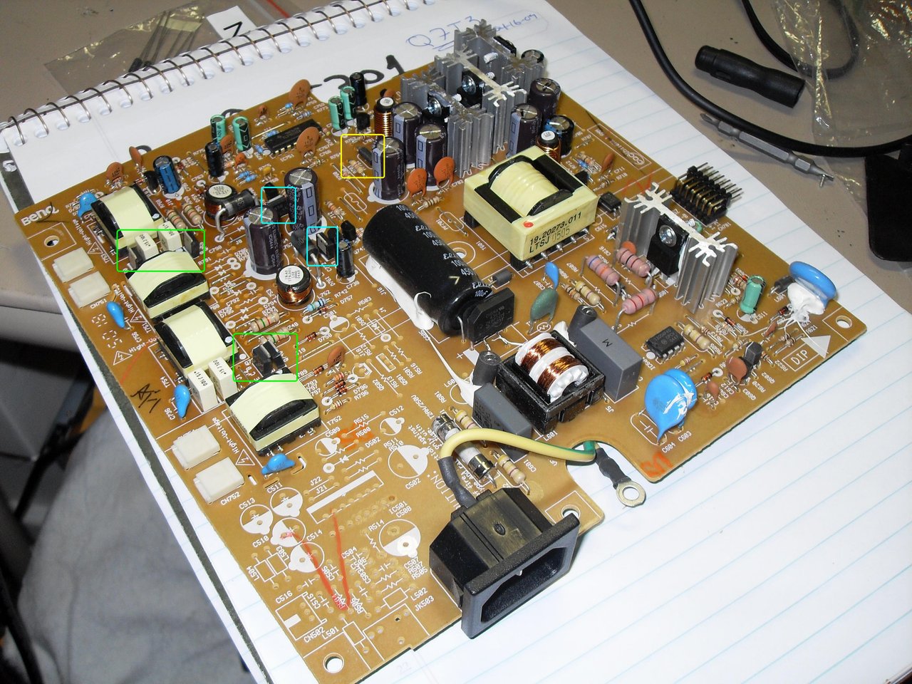

            5707 is the part no. of the transistors that drive the transformers.
            Look at the picture (is a bigger/better picture of your board). Green ones are the 5707. Blue ones are something you should check too. And yellow is the picofuse you must see if it is open or not.
