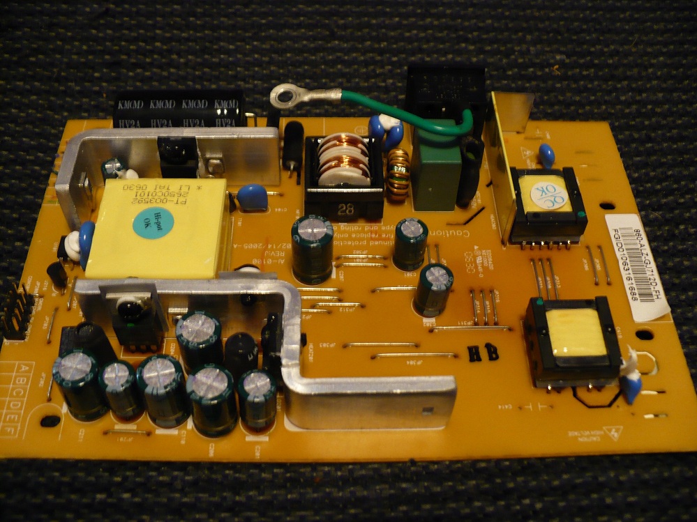

                  just disassembled my fpd1975w; has been shutting off after a few minutes...
                  replace all the capacitors, right?
                  http://www.flickr.com/photos/43312216@N06/4728623602/
                    #69
                    Re: Gateway fpd1975w
                    You can attach a pic here (see FAQ). Take one that is directly above the board (front and backside).
                    Shutting down after a few minutes could be the one or more caps being bad (having high ESR or not enough capacitance), some sort of IC getting too hot, bad/cold solder joints, CCFL going bad, etc.
                    Do the board look burnt or discolored in one area? It might give a clue as to what area/component is getting hot?
                    You can also try lowering the contrast/brightness to say 25/25 to see if the monitor will stay on longer.

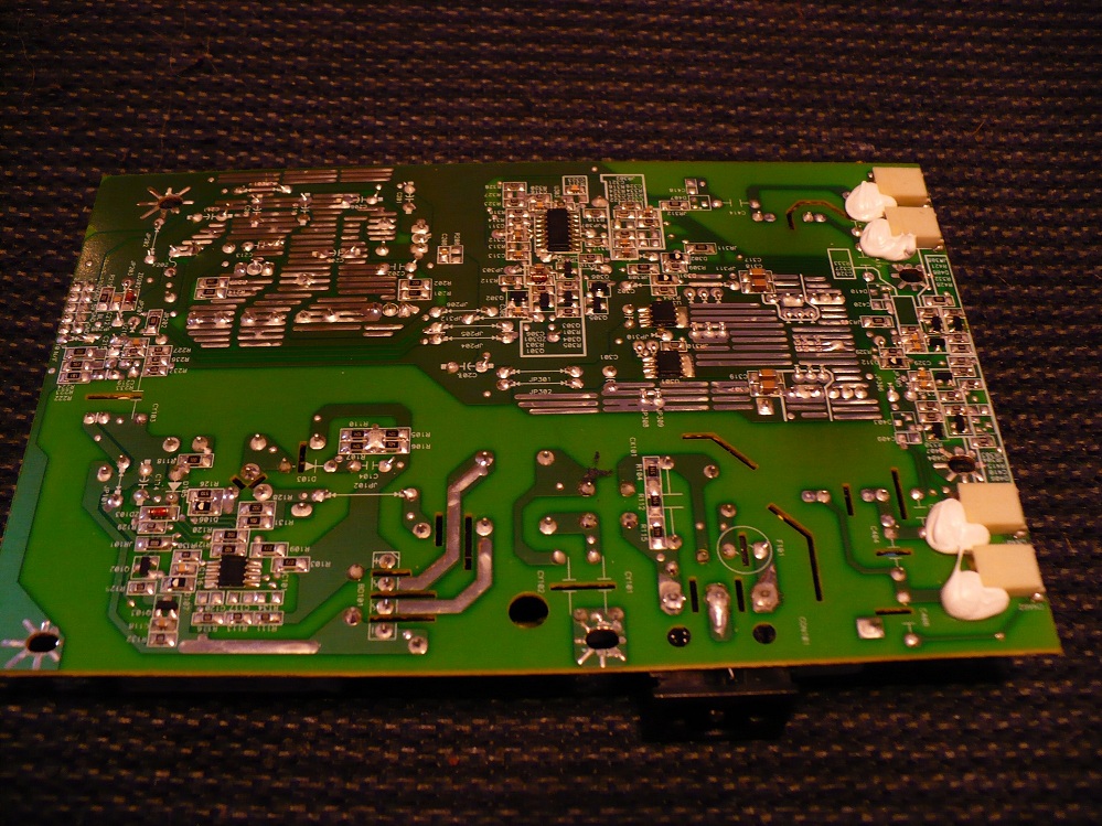

                      #70
                      pics attached
                      Don't recognize signs of overheating.
                      Would like feedback on pics b4 reassemble and adjust contrast/brightness.
                      Thanks!
                        #71
                        Kind of looks like there is minor heat related discoloration around the inverter drivers (let me guess, they are marked AOD405 and AOD408?). Please try to take a more top-down picture instead of at an angle, it will make it easier to mark test points.
                          #72
                          Take your board next to a window on a sunny day and take the picture top down. Put your camera in macro mode and you should get clear pics with enough light from the window.

                            BTW, who makes the caps? It should list a name, series, and a date. Something like
                            Samxon GF(M)
                            0732

                                i'll post better pics.
                                green caps are Samxon GF(M); large black cap is Samxon KM(M).
                                  #76
                                  See this thread re Samxon GF series.
                                  https://www.badcaps.net/forum/showth...ight=samxon+gf
                                  Personally, I would do more troubleshooting before coming to the conclusion that I should change caps first, but it is your call. It shouldn't cost more than $10 USD to recap your entire board.
                                  As I said, the shutdown after a few minutes could be due to a lot of other reasons other than bad caps.
