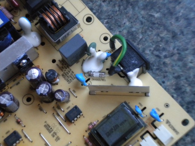

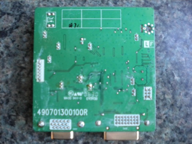

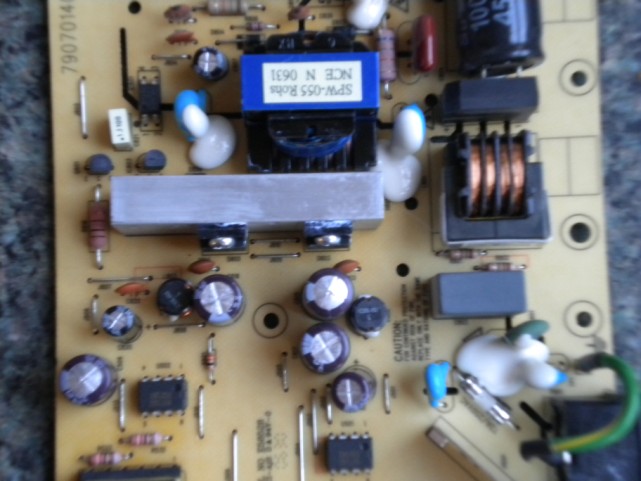

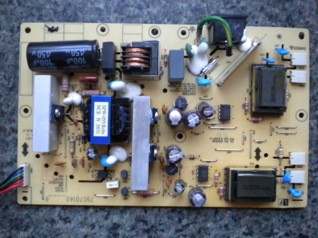

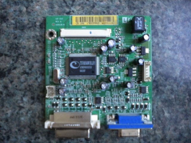

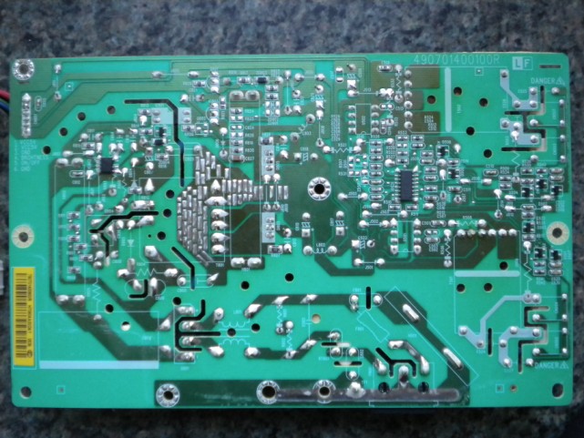

                  Hello All... First post here. I also have a Gateway FPD1975W that a friend of mine just gave to me because it seems to have some problems as well. With it plugged in, it will automatically try and turn on but won't stay on. It will flash the Gateway logo and go back to black over and over and over.. so I know the actual LCD screen itself works.. I have it all taken apart and I took pictures of both circuit boards inside.. I'm attaching pictures of both. I am just wondering if I need to try the capacitor replacement solution.. or what I need to do based on the pictures I've provided.
                  EDIT:
                  I tried to upload them as attachments and they were too large so I'm going to add links to them from my webpage..
                  Inverter Board Back
                  Inverter Board Front
                  Inverter Board Front1
                  Inverter Board Front2
                  Inverter Board Front3
                  Video Board Back
                  Video Board Front

                    Start by reading this FAQ. Then use some editing software to reduce the size of the pictures. I've already had one picture Paint couldn't handle today. I don't know what was wrong with it, but I'm not taking any more chances.
                    PlainBill

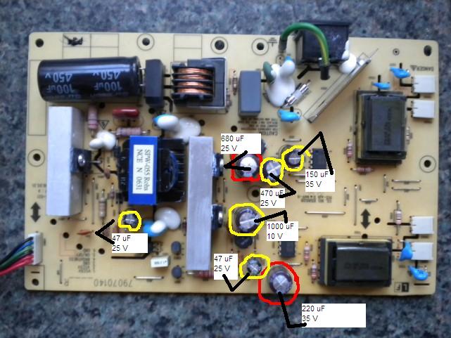

                      Thanks.. here they are again.
                      EDIT:

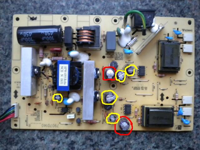

                      and the brand of the capacitors on the board are Su'scon

                        Su'scon are not known for their high quality. Two caps circled in red are obviously bad. The other caps circled in yellow should also be replaced because A: They are Su'scon; B: At least one of them is vital to the operation of the power supply; C: they are inexpensive and you'd rather not have to open the monitor up again in 3 months.
                        I STRONGLY recommend Digikey, and prefer Panasonic FM caps. If you use Digikey's first class mail option the entire order should cost under $10.

                          Alright, I've atleast got some sort of an idea on what to do now.. ok, so now that I know I need to replace the capacitors, I just need to know what capacitors to purchase.. Do I go ahead and just get the same ones(uf/v) just a different brand? I've attached the same picture but with the capacitors labeled.. Thanks again for your help and time.. I really appreciate it.
                          EDIT:
                          Yea.. I really need help on choosing capacitors because I just went to DigiKey and was looking around when I realized that I should probably wait and find out exactly what capacitors I need.. I know little to nothing about electronics circuitry.. Again.. thank you.

                            OK, what you have marked up will come in handy when you are replacing the caps. But most of us have better things to d with their time.
                            The next thing for you to do is make a list of the capacitors, showing capacity, voltage, height, and diameter. (You don't have to specify the height of all of them, just the maximum height that will fit.) Someone will then make up a list of recommended replacements.
