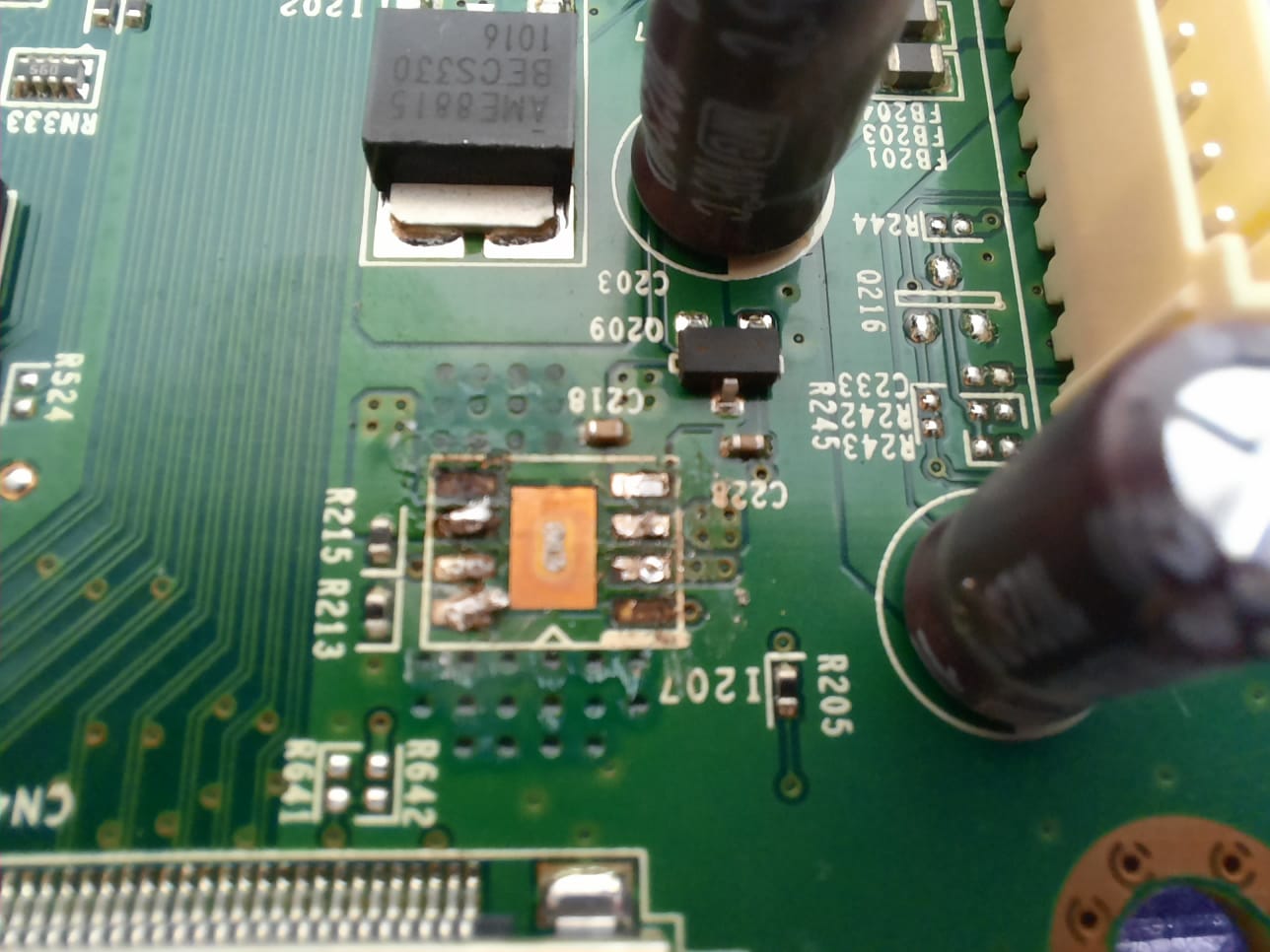

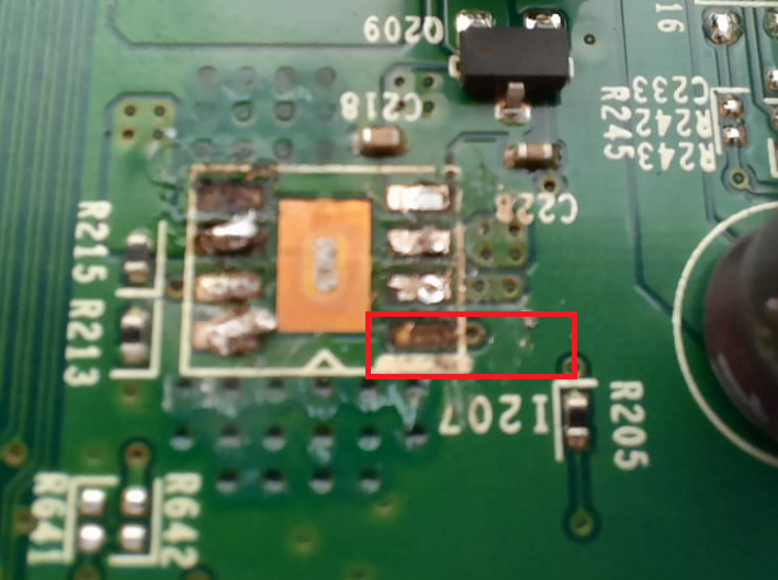

          Can someone tell me where the V5 (pin 1) is going? I see my ping 8 is off too but that one is a NC.
          All the other pins are fine (reaching the resistor and capacitors .
          Any help will be more than welcome..

            Pin 1 trace was likely connected to that feedthru next to it. Next time either use hot air station or carefully cut the pins off the ic body, then remove each pin separately.

              thanks for the advices.
              yes, the freedthru was there and it worked.

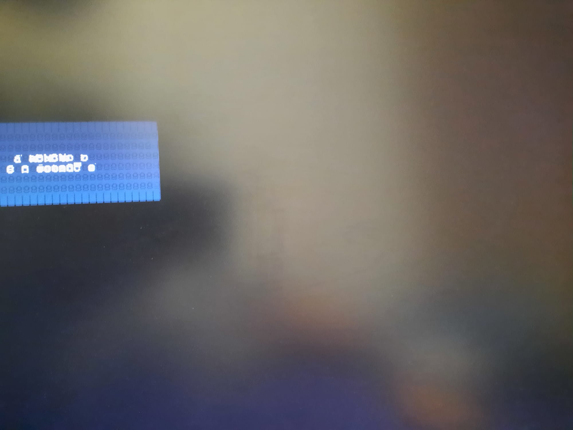

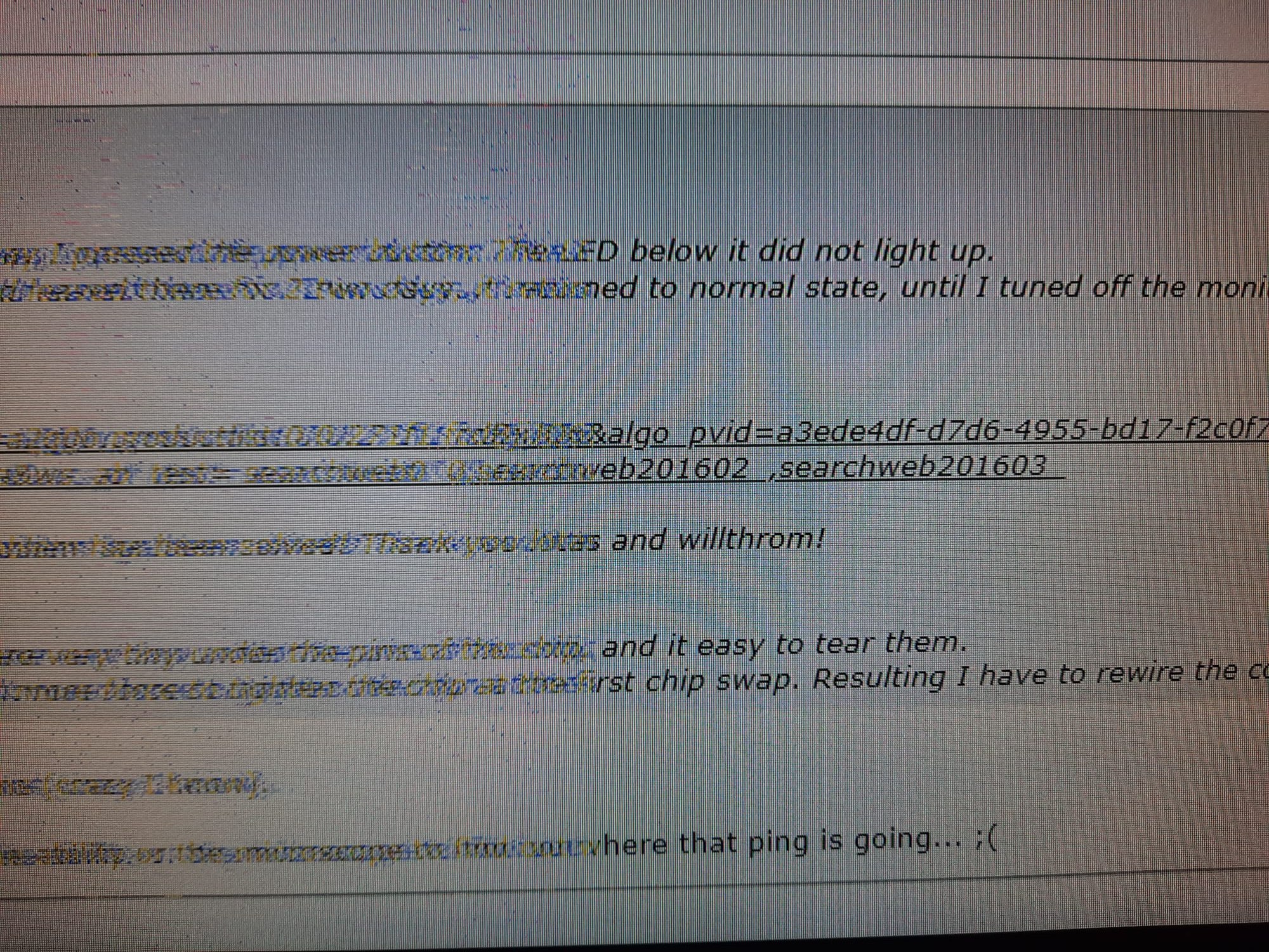

              Now the screen turn on (not sure if because I changed one of the chips).. but in my first try, half of the screen the image (Not Connected) is printed wrongly.
              • willthrom
                • Jan 2021
                • 15
                • spain
                Re: ACER GD245HQ totally dead no power
                This what I mean with the screen What can be wrong?
                Bad soldering for that chips?

                  I know by a fact it isn't the input as without it the floating "Not connected" message is only visible properly on the right side, not the left one, where it is flurry, like interference..

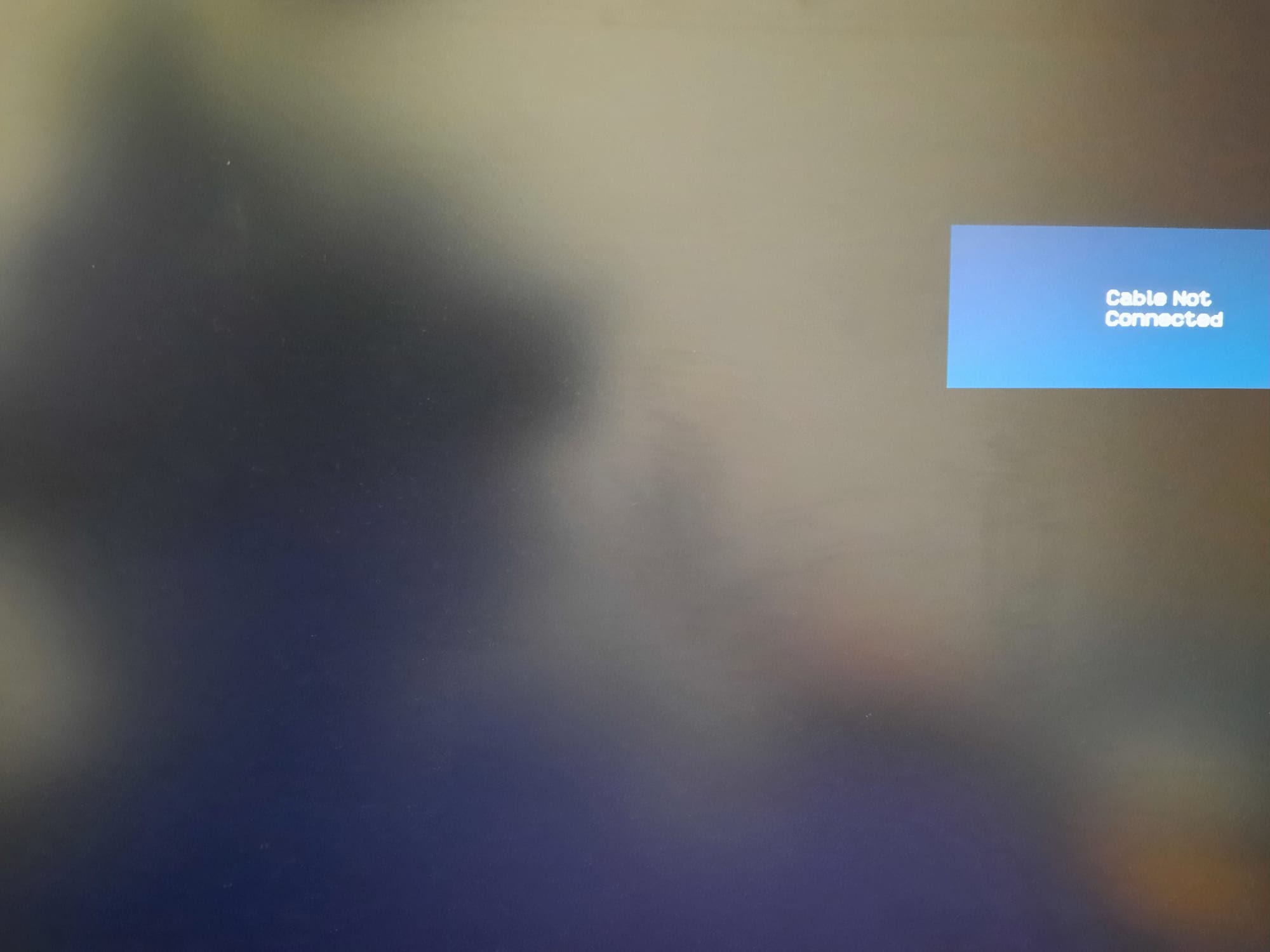

                    #29
                    Image without input..
                    What I have broken now? Any clue?
                    Thanks!!

                      I fixed!
                      It seems my soldering skill are awful now after so many years and some pins where not properly soldered. I used the multimeter and track all the pics with the chips schematic and board schematic and now it is back!. Proper pic.
                      I have disconnected the cords 20 times and still turning on so I guess the new chips is doing its work... lets see next eletrict sortcut.

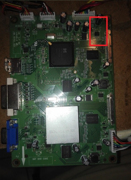

                          @bob I may be wrong but i think you can not just buy parts like this, your best best is to buy a used or even damaged one.
                          I just wanted to thank everyone on this thread for sharing their knowledge, thanks to i was able to repair mine. As many of you suggested the I204 and I207 could be the issue, i ordered some online and soldered the new ones in place and that feeling when you press the power button and it lights up is just like nothing else thanks again!!!
                          For those who want to attempt this and are scared about the desoldering/soldering process, i would suggest the 2 solder irons technique, that's what i used and it worked great, even with a very cheap solder iron: https://youtu.be/LL23ZJahcfY?t=454
                          I just wanted to share a picture i took from the inside for those wondering where exactly is the power supply and the electronic parts:
                            They are found on the main board.
                            Thanks a lot, ordered on "Ali" the chips, replaced those indicated on the scheme and it works fine now!
