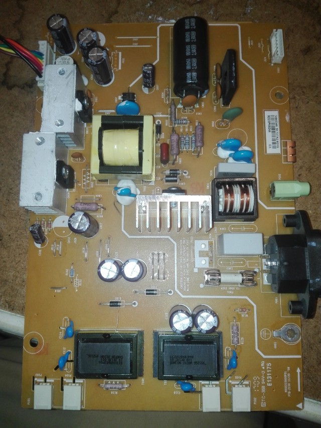

    ACER GD245HQ totally dead no power
    I have an ACER GD245HQ.
    After unplug the AC cable et replug it the screen is totally dead.
    No standby led and no power on when press power button.
    I check the power supply board 5V and 22V are ok.
    I try to reflash the eeprom MX25L1605A with an dump that i found it on web.
    I check the 3 DC converters on main board it seem ok .
    But always no power totally dead.
    Have you an idea?
    Thx

    Re: ACER GD245HQ totally dead no power
    upload some pictures so we can help you

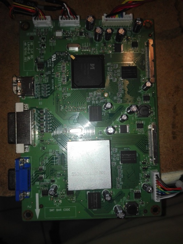

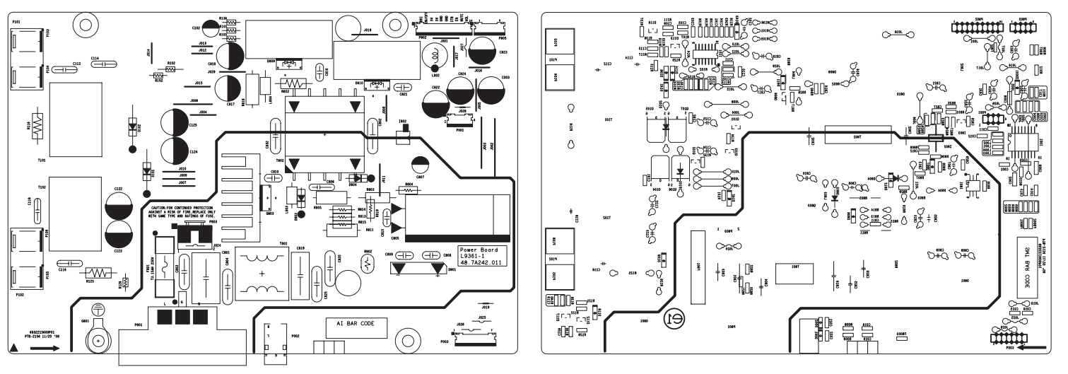

      I join the service manual with schematic
      And 2 photos of boards

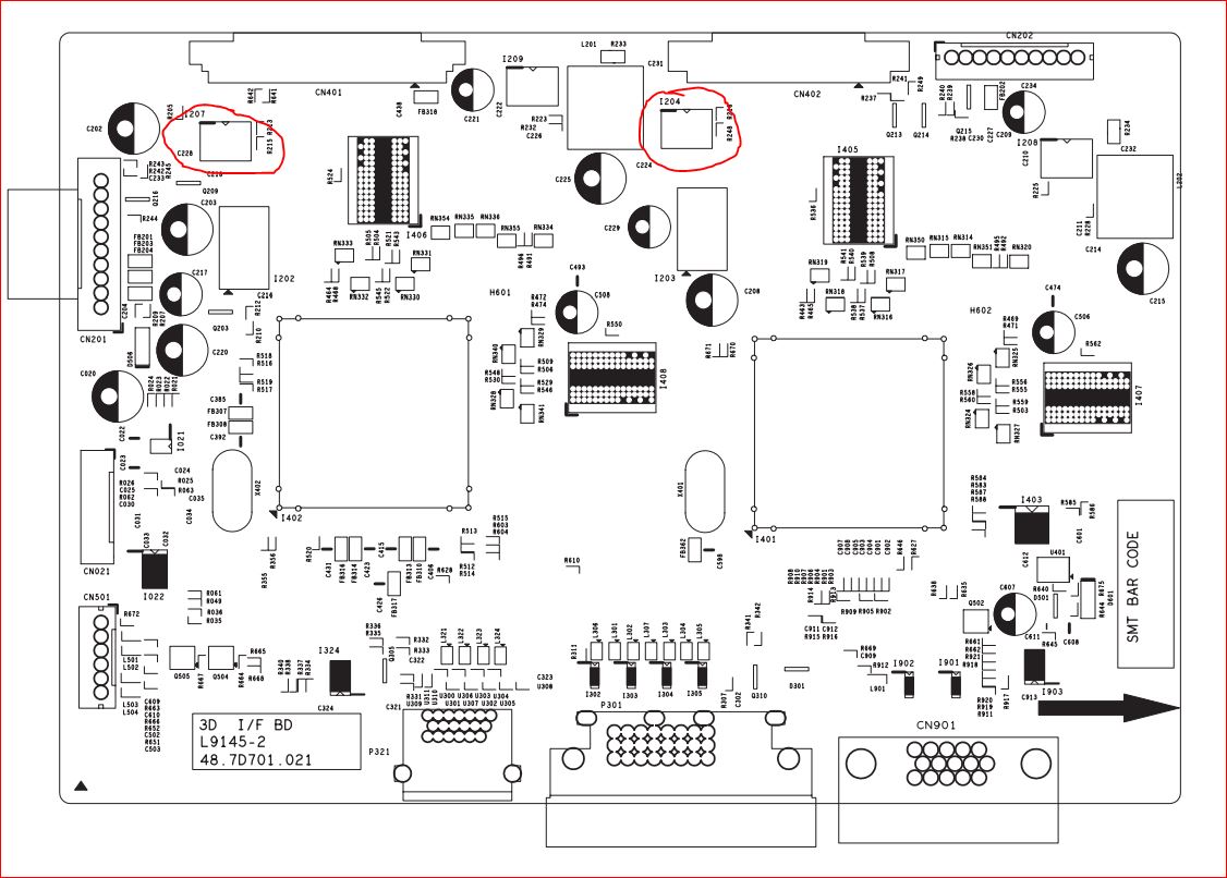

              The problem with this monitor is often in the Regulator G966A (SO-8) when it heats up, the power can recover.
                Thank you!
                I will check the both G966A (I204 / I207).

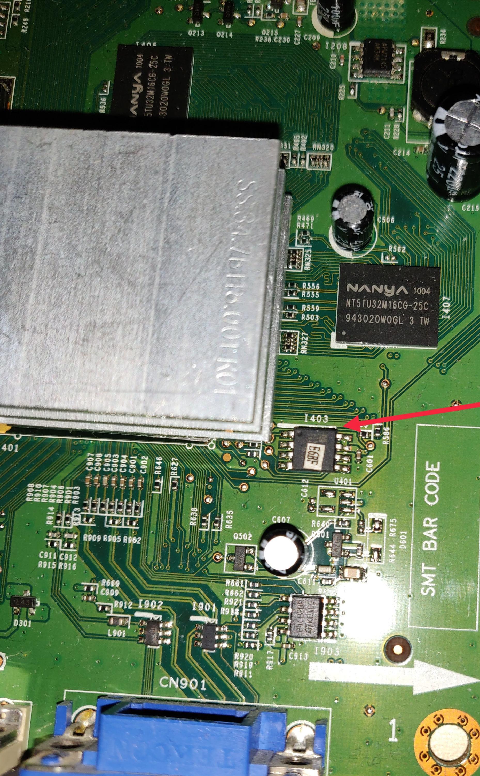

                For the BIOS file it's the I403 (MX25L1605DM2I-12G-GP) do you confirm ?
                Mine is labeled "E6BF" :
                  Yes, dump worker, downloaded from here:
                  https://****************/dump/mnt/gd245hq/12-1-0-18097

                            I cannot find the regulator G966A (so-8), I might be blind....
                            Where in the diagram I can find it??
                            • lotas
                              • Jan 2016
                              • 4540
                              • Russia
                              They are found on the main board.
