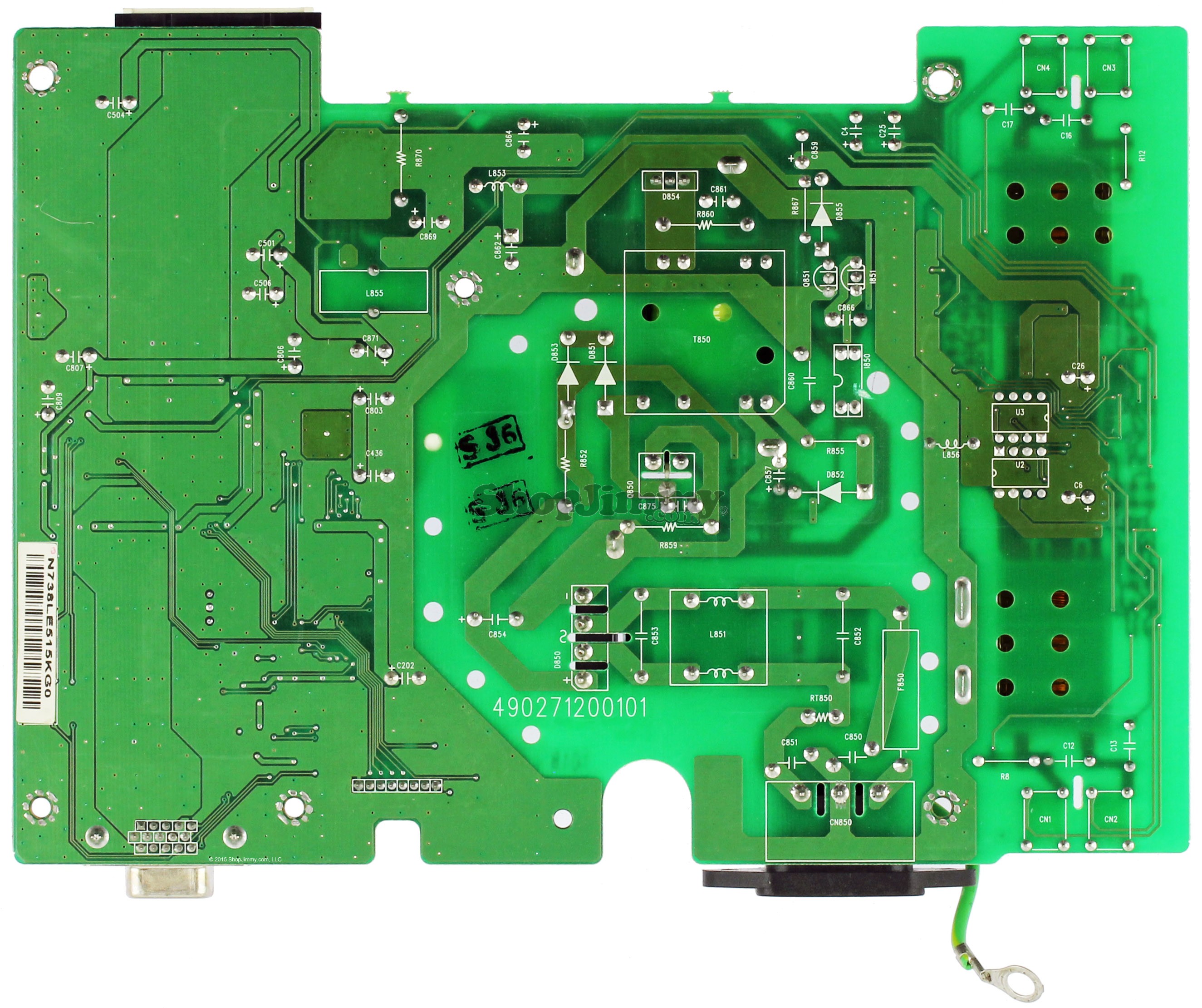

    Can we see the pictures of the bottom side of the board?
      Re: dell e176fpf ena pin
        The pictures of your Bottom side of the board you have DO NOT match the picture of the top side of the board you have shown in post #1, they are not the same board!
        You need to show us YOUR board not the picture of someone else board.

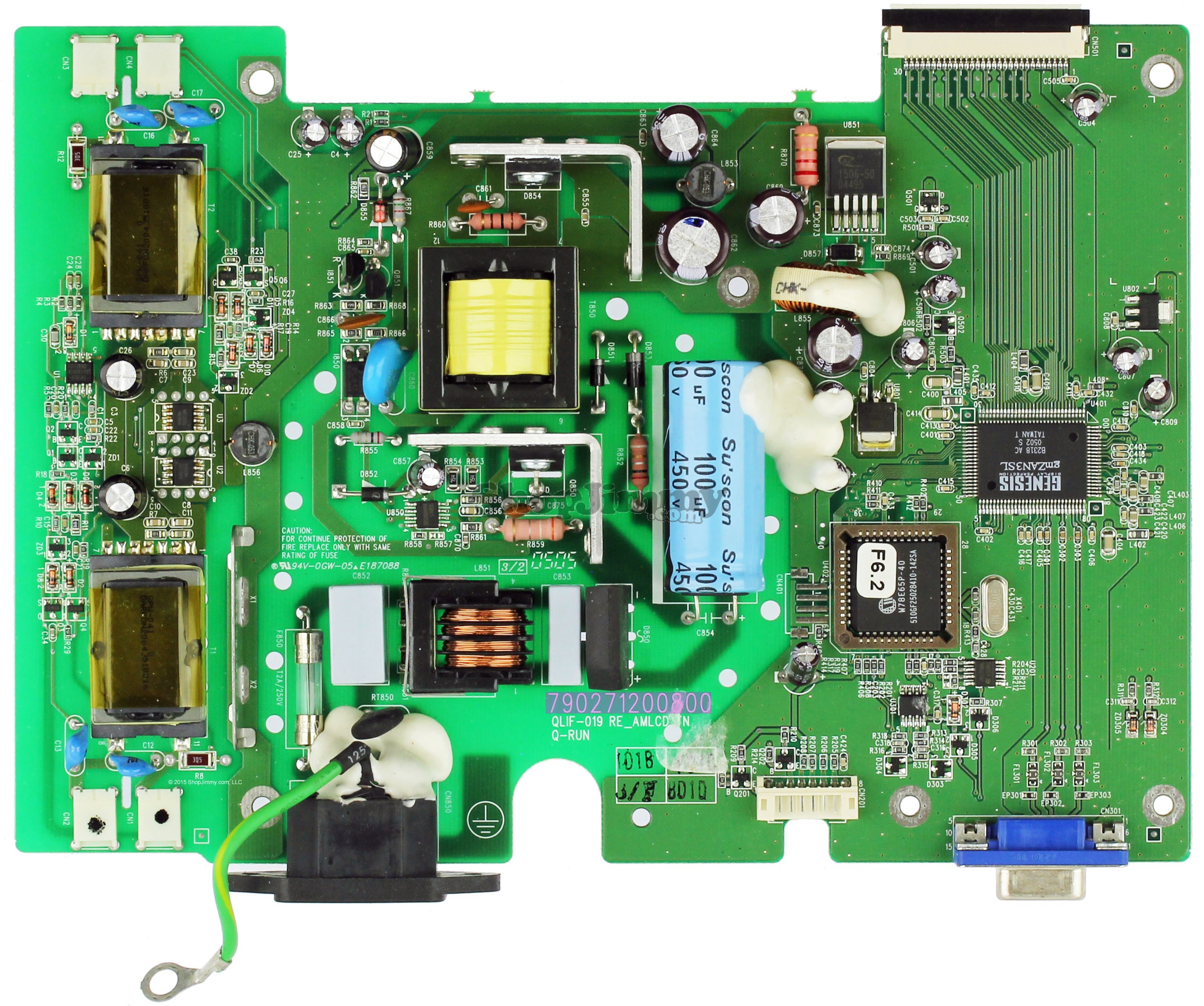

            Man! the pictures are not in focus at all, I cannot read anything on the board.
            BTW, are you sure this is Dell e176fpf, NOT E173FPF?
            I only see this board used in the E173FPF.
            The P/N as printed on the bottom side of the board is 490271200101 or 490271200100 , the number as printed on the top side of the board is 790271200800?
            Can we see the sticker on the back on the back of the monitor that shows model number and the revision number?
            BTW, what is the P/N as printed on top of the IC U1 in the inverter section?
            Please look at the attached pictures to see if it matches YOUR board or not.
            Pictures provided by shopjimmy.

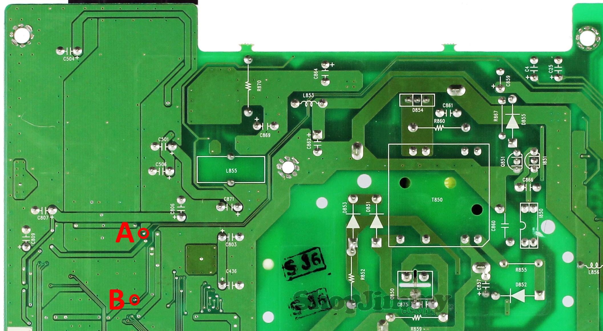

                So your board matched the pictures I post in my post #6. If they are then I believe I can see the two control lines that go to the Inverter section.
                  Check the DC Voltage at point 'A' with ref. to GND and point 'B' with ref. to GND when monitor is OFF and when the monitor is turned ON.
                  Report the results.
                    my dear budm
                    point a 1.8 v even off monitor or on
                    point b 3.3 even off monitor or on
                    but i'm under stand what do you want
                    we search the point that when on monitor volt appear on it
                    and when off monitor volt dont appear on it
                    and i search for all point in board and i found that tow point in the bottom of board beside key connector C and D lock at picture please
                    point C 3.3 volt when on ----- dont appear when off
                    poit D 2.02 volt when on -------- when off goes to 0.02 volt
