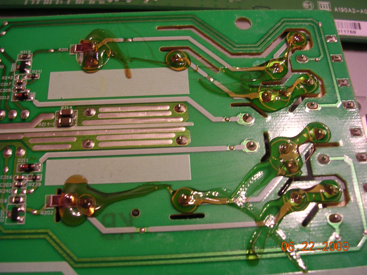

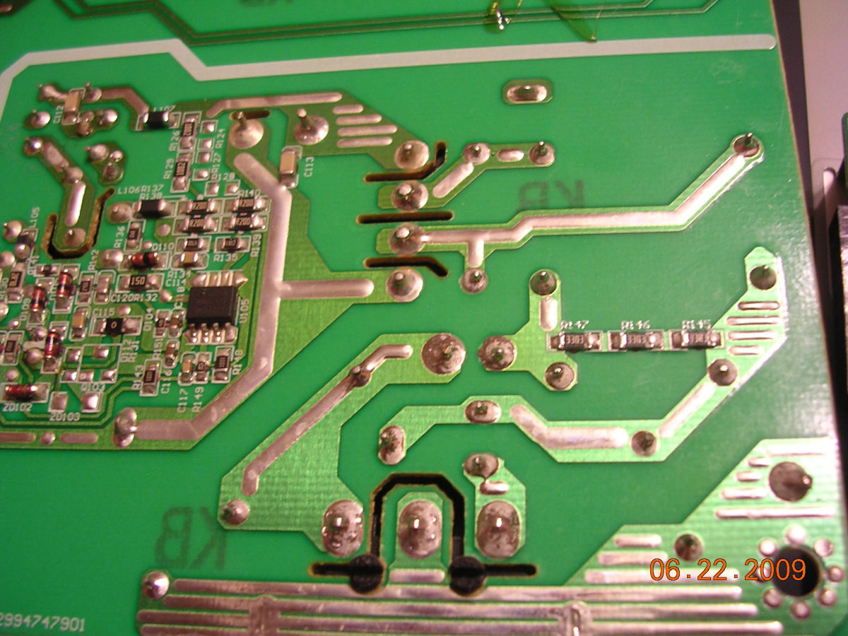

      I can see 2 fuses
      F200 on first pic, at bottom in middle
      F102 on fourth pic, top left with a M or W on it
      suspect there may be a third possibly F101 (not sure about that)

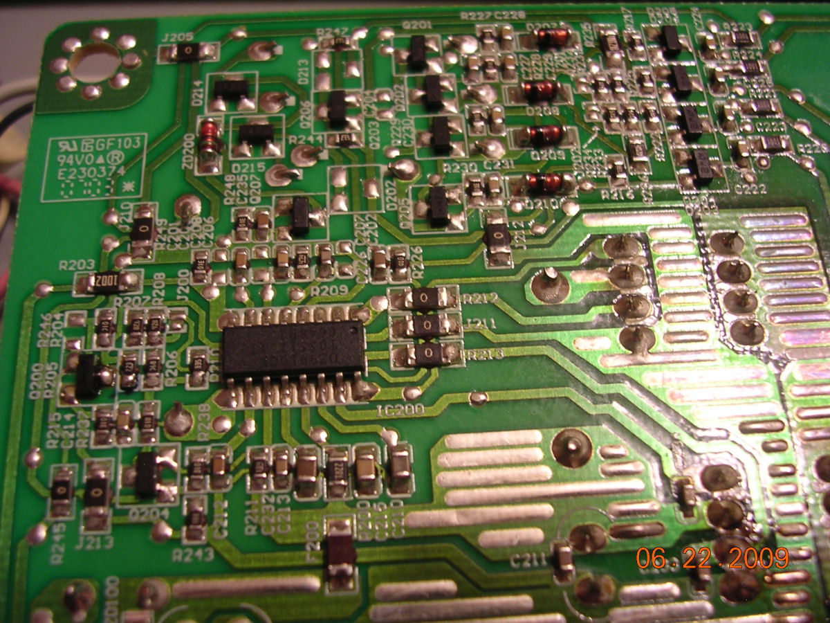

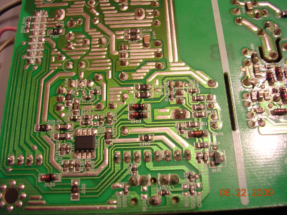

        He refers to the 8 legged ICs near the transformer.
        If you can, replace those Taicon for Panasonics as a preventive measure.
        And check the fuses Bob describe. On the model discussed here before, with the different PSU from yours, F200 was the culprit. Check them both, F200 and the "W"/"M" one ...

                That's Realtek logo. Not that one. This is microcontroller (aka minimalist cpu with few control outputs and few inputs).
                The IC they were referring is FET drivers in 8 pin DIP package (on the inverter/power supply board). Black square, dot or notch for pin 1, with 4 legs on each side in parallel.

                        I tested the two fuses. F102 is good. F200 is bad. It has a #3 on it as best I can tell. Where do I get one of those and how do I know the value of it?
                        A parts board would be great but I hope all I need are the caps, chips, and the fuse. I already ordered the mosfets off of Ebay.

                                F200 as in our models ....
                                Get new caps, MOSFETS and I think the fuse is either 3 or 4 amps (that info is around this or the L20146NV thread that I started). Mine is bridged with solder.

                                  Just an update, The caps and fuse are in. Waiting on the chips to come USPS. I thought they would be here today but not luck. Maybe Monday.
                                  Bob
                                    Re: Issue with Westinghouse 19" LCD Monitor (large pics)
                                    Got the mosfet's in today. The monitor works great!

                                        The fuse on the bottom of the power supply board is a 4amp surface mount fuse. Mouser.com carries them, they are part number
                                        652-SF-1206F400-2
                                        We have repair many of these units and every time its the caps, mosfets and the fuse.
                                        Buddy
                                          652-SF-1206F400-2
                                          Buddy
                                          Agree : caps going south kill the mosfets, that in turn blow the fuse.
