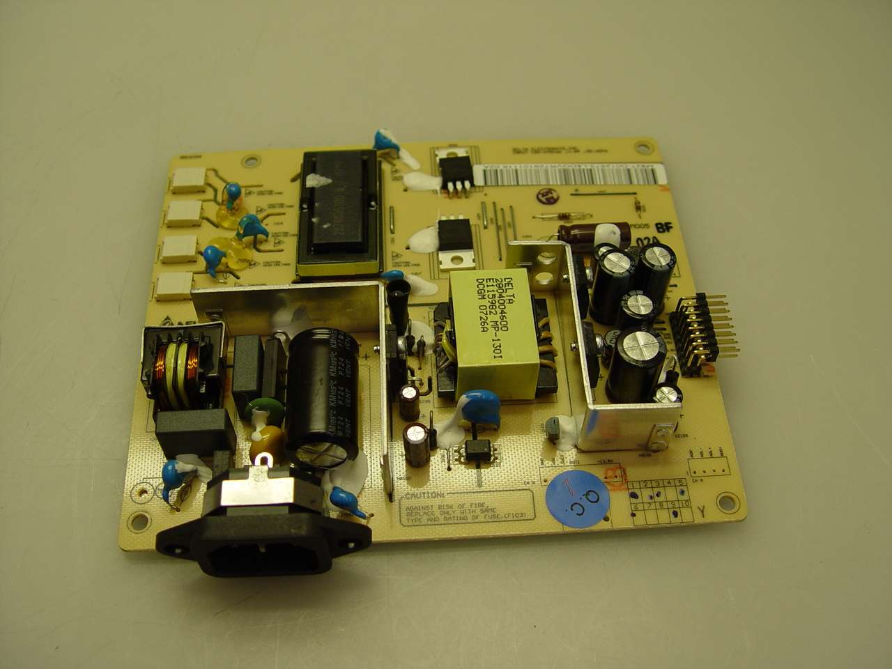

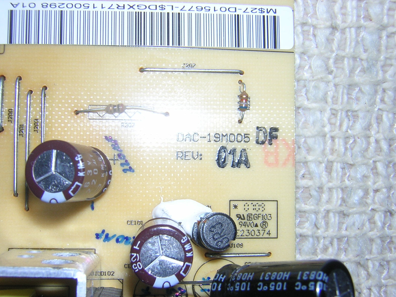

                I am back again with a question. I have not ordered the BIT3713 replacement part from Bluestar since I found what i thought was a replacement for the entire "PCB" board. But i wanted to ask a question.
                MY power supply board (which looks similar to the one shown in the pics above) has the part number: DAC-19M005 DF (note the DF is hand written).
                The part number of the power supply board in this posting above (which has the pics) is : DAC-19M005 AF (note the AF is hand written).
                My question is this: I found a place where i can get a replacement board part number : DAC-19M005 BF (note BF is hand written) for very cheap....$30.
                My question is can i use the BF board to replace MY DF board?

                  There are few guarantees in life, but this one sounds like a pretty safe bet. The hand written characters at the end of the part number are either version code, a revision level or a date code.
                  PlainBill

                      Define 'safe'.

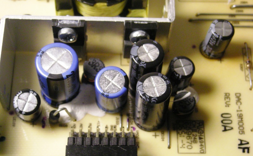

                      I would say there is a 90% chance that the DAC-19M005 (BF) is a slightly earlier version of the DAC-19M005 (DF), but functionally identical. The remaining 10% chance is that the two supplies are built on the same circuit board, but one version lacks some feature found on the other.
                      You state in an earlier post that the DAC-19M005 (AF) looks 'similar' to your power supply. What is the difference? Maybe a picture will help.
                      PlainBill

                        I second that. In fact, you can post a picture of the board you have, one of the board you're gonna get (if possible) and another of the board you reference from this thread.

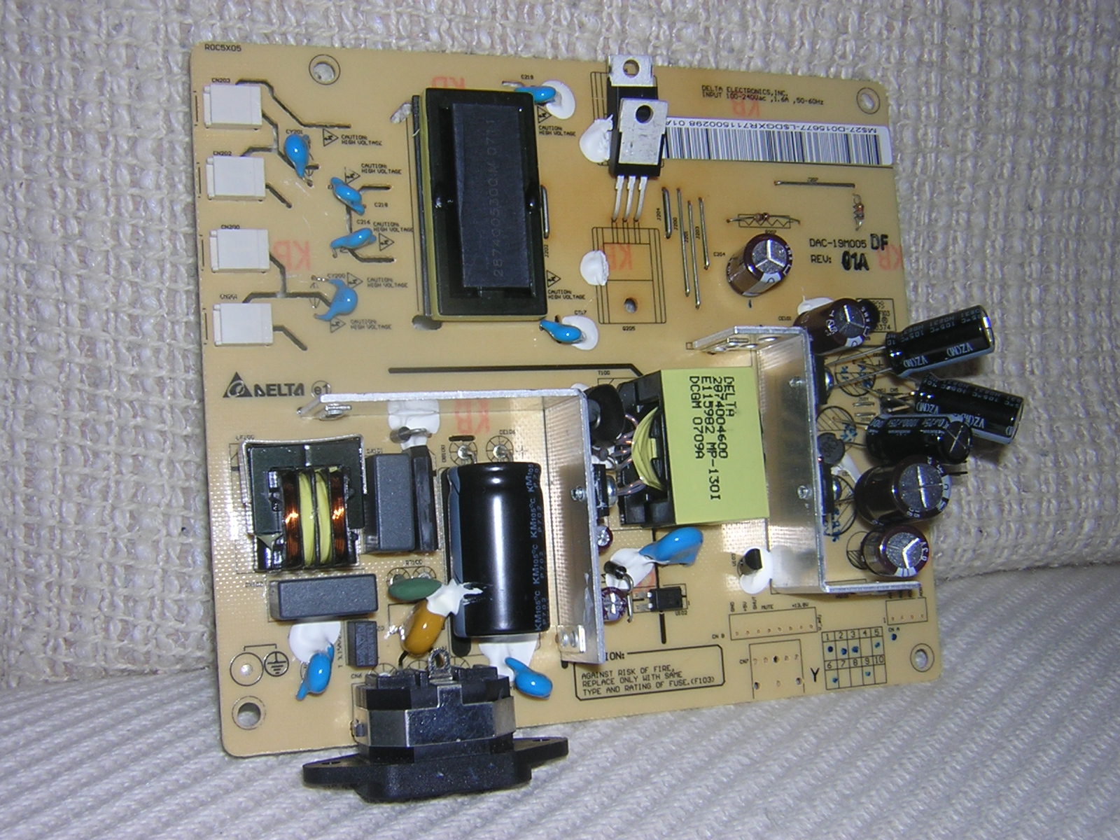

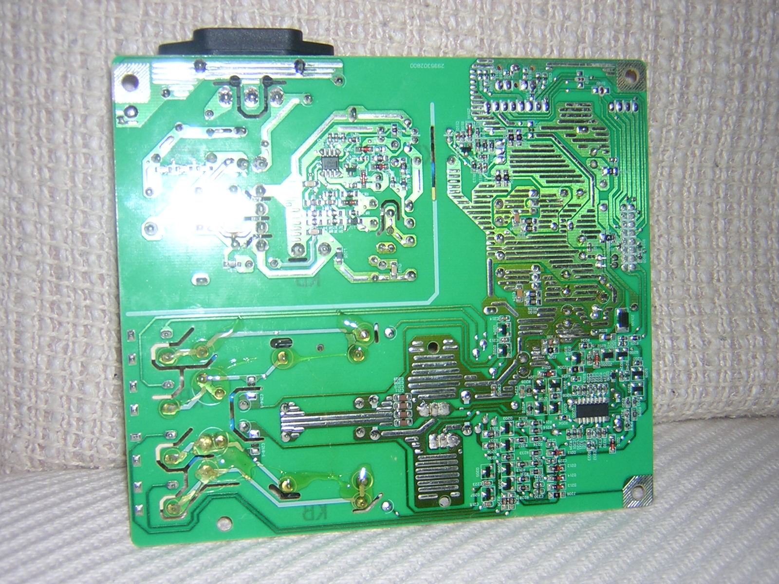

                          I am enclosing the pictures of my westing house (436,437,438,and 439). The other picture (1049456001) is a pic of the "BF" board. The (436,437, 438 and 439) are pictures of my "DF" board. They look identical except for the "BF,DF,AF" and revision numbers.
                          Are there any other pics you need?
                          Note: My monitor is a westinghouse L2046NV

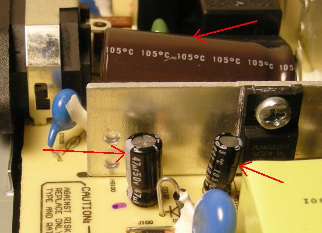

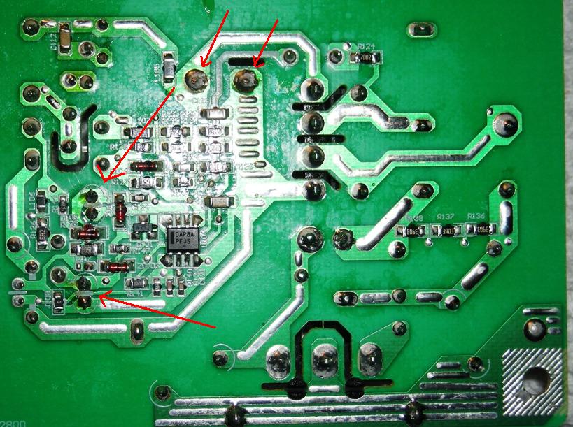

                            All,
                            I was able to get my Westinghouse Monitor working by using the information from this thread. I have attached pictures of the repaired board.
                            1. I used the capacitors from Mouser as described in post #23, there were corrections to this post in #24, but I didn't know my electronics well enough to translate into a change in the Mouser order. (Note that this post was modified since I got the list and appears to have been corrected. The 1000uF 25V that I ordered was the wrong size, so these 2 caps were the only ones I didn't replace).
                            2. I did NOT replace the MOSFET's, but your problem may be different then mine.
                            3. I did find that the small fuse on the solder side of the board was blown (tested with a multi-meter, so I soldered a wire over it, this is not recommended and I need to find a replacement fuse so if the capacitors go bad again I don't fry the board beyond repair.
                            4. The 100uF 420V replacement for the 400V that was their it fine, just a little longer.
                            5. The attached pictures show the front and back of the board with red arrows pointing to repaired areas.
                            My monitor model number is L1975NW

                              The 1975 and the L2046NV (just like the one I'm using now) use the same PSU. I say that you go for it. Also, please let us know where to get the PSU for $30 if possible. Maybe It can come handy later...
