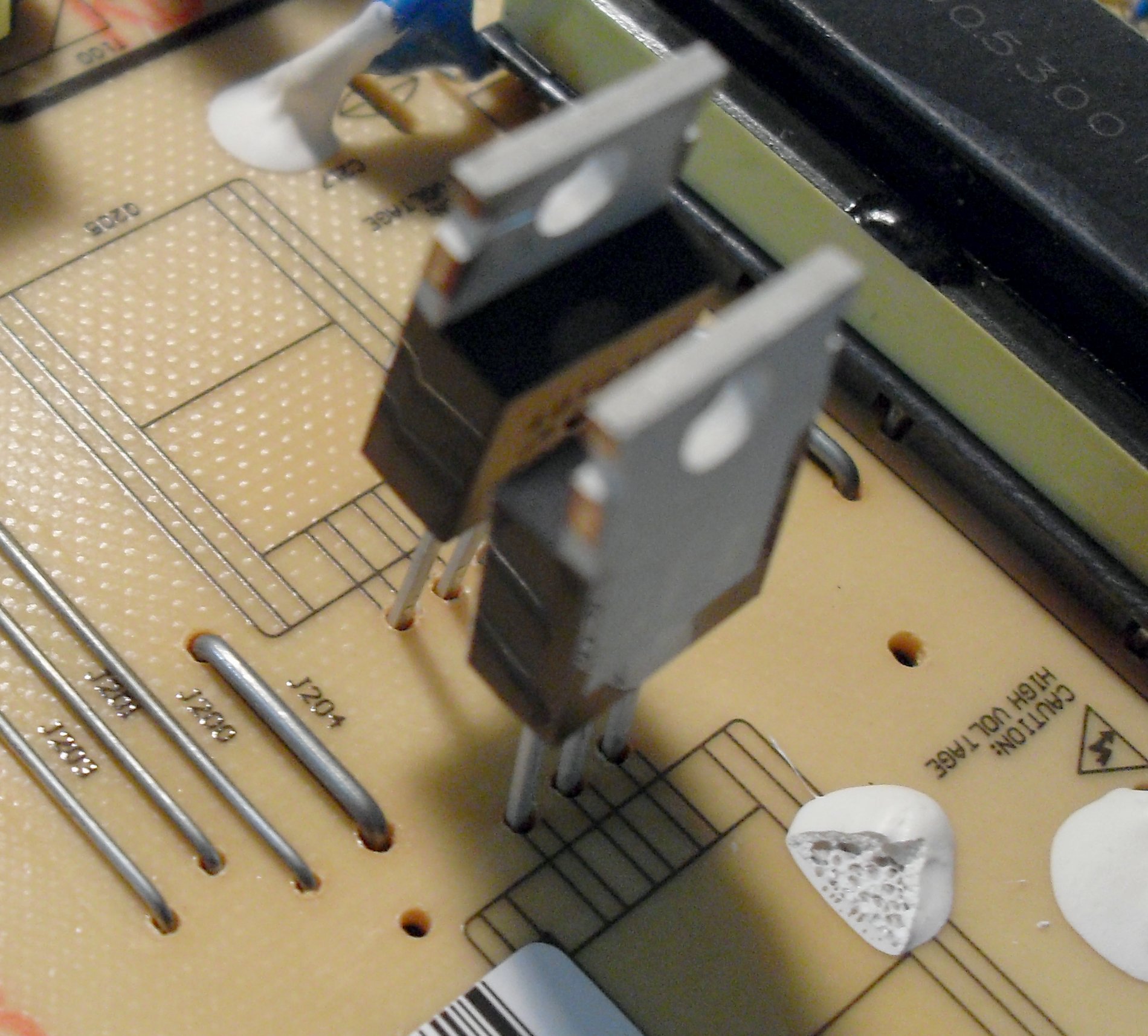

                  Since we have the same board, same problem, but just different LCD size (mine is 20.1", yours is 19"), I guess I can help. I'm about to pull that box in front of the line, so I can get it and see what can I suggest.
                  Here's a picture of my board, that is discussed on another thread :
                  Give me a couple of hours and I'll be back with you. Too bad that my MOSFETS have not arrived yet .....

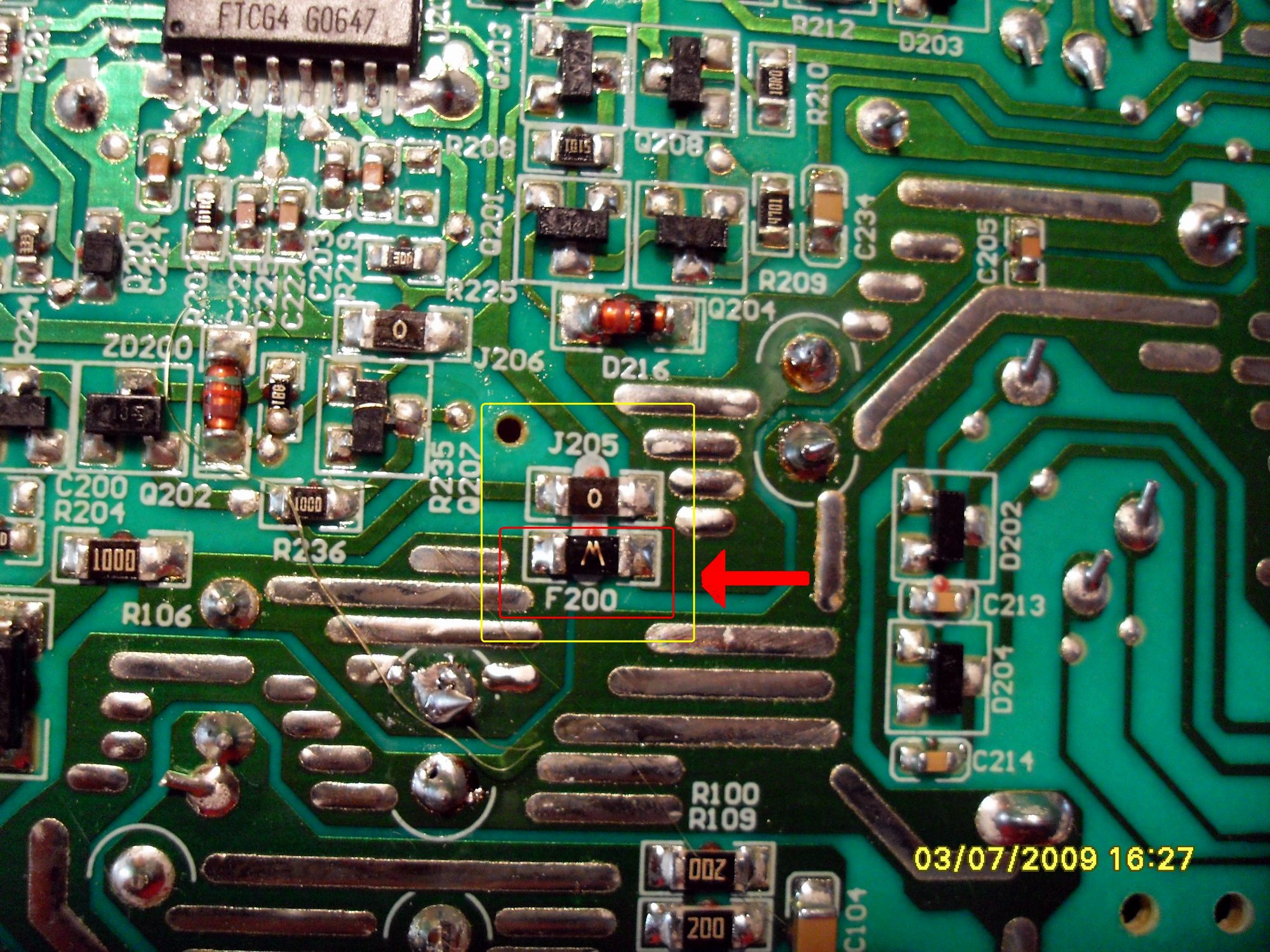

                        Before messing with the IC, look at this:
                        Right at the side of the MOSFETS, there's a jumper labeled J204.
                        I have 14v there, which I assume it is the voltage that feeds the inverter part of the board.If you don't have a V reading there, then move to the other side of the board.
                        There are small jumpers and fuses (SMD) there. The fuse highlighted was open in my board, so no voltage reached the MOSFETS. Replacing the fuse fixes the problem. Now I have image & backlight, but here's the question that you could answer me in case you fix yours too:
                        in the MOSFET at the left , I get the following readings :
                        S: 0.79v
                        D: 6.60v
                        G: 0v
                        In the MOSFET at the right, I get:
                        S: 6.54v
                        D: 14.06v
                        G: 4.14v
                        I replaced both of them, and after the readings, I switched them with each other. The readings remained the same (readings didn't move with the MOSFETS, so I guess they are not bad).
                        Any idea if this is normal, anyone?

                              I am more than willing to look into this fuse issue like you are suggesting, but I have 2 very very elementary questions to ask (remember, I am new at this whole circuit board stuff!)
                              1.) I have my multimeter and I'm ready to take some DC readings with it. Red probe on the jumper in question, black probe where? Supposed to go to ground, but I want to make sure I'm doing everything exactly right before I go probing around on the PCB.
                              2.) How do I know if a circuit board fuse is "open?" Is this something visible or do I just do a quick continuity test?
                              Thanks again. I'll get on that tonight once I get some quick directions
                                Collin
                                Red probe (+) on fuse, and black one (-) on GND. I first make the continuity test.
                                You can put the (+) on JP204 and the (-) on GND, and you should have a V reading (DC) if the fuse is OK.
                                There are 10 kind of people in this world: those that understand binary, and those who don't.

                                  #36
                                  Re: Issue with Westinghouse 19" LCD Monitor (large pics)
                                  Right. Where *exactly* is GND? I've heard too many conflicting cases of where exactly that black probe is going. Sorry, it's really a very basic question.

                                    #37
                                    Collin
                                    No problem.
                                    GrouND is any part of the metallic part of the chassis. You can put the probe in the screw hole right at the top of the barcode to the right. That's where I put the black probe when I was testing my LCD. That will serve to test on J204.

                                      #38
                                      Strange readings...
                                      Some of the time the jumper gave me readings of 0, but other times it would read exactly .375V (or .4V or .38V, depending on the setting of the MM). Continuity of the fuse was nonexistant.
                                      So if that proves that the problem is with that fuse...how in the world do I get one of those little things??? And how do I replace it? sheesh!

                                        #39
                                        Strange readings...
                                        Collin
                                        I got a variable ohms reading sometimes, and sometimes a complete open. What I did, while I can get a fuse, was bridge the two ends of it with solder, just to test. It is not recommended to do it, but that is what I did. you can do it just to see if that is your problem. And I will take the fuse from a dead board I have around here. Test it and then if that's your problem, we can ask someone to suggest a replacement fuse. I guess it opened/failed when the MOSFET shorted (it is the fuse that protects the Inverter). My unit has been operational for more than two hours, and is a nice screen, despite having one stuck pixel (green dot always on). I don't mind 1 in the middle of millions ....

                                          #40
                                          Holy crap....it worked.
