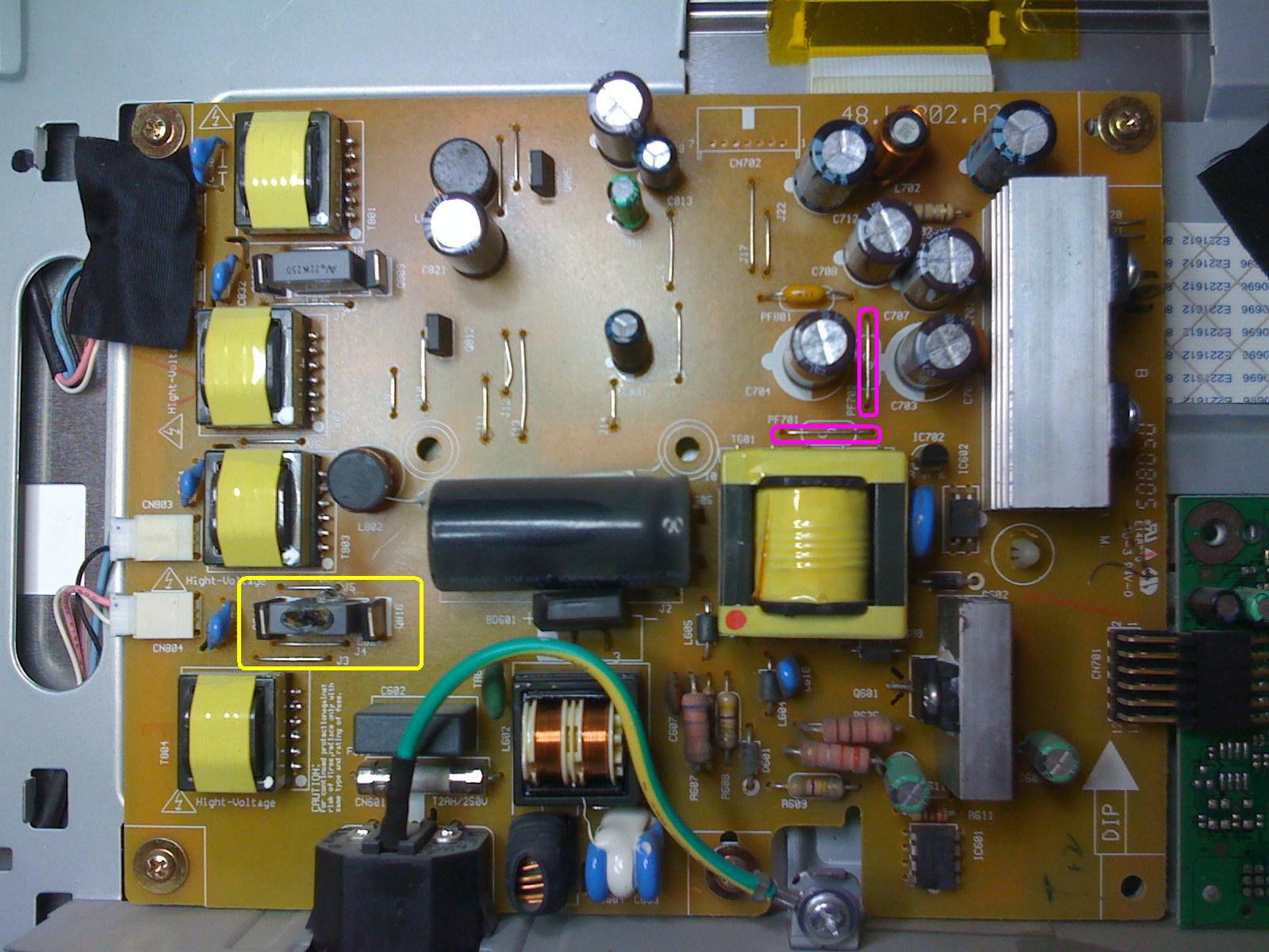

    Hi guys, just done 5 of these today, all with dud caps @ c703, c704, c707, c708, c709 and c712 - or a mixture thereof.
    This last one is different, it has burnt through, C824.
    Now, as a relative 'Noob', i'm not to sure what else would have been stressed and what i should replace as a "precautionary" measure in that part of the board.
    Have found lots of mention re: C826 and such.. but nothing on this one.
    Cheers, and thanks for any help you may offer.
    David.

        Sorry for the delay.
        This is the state when i opened the machine, has already had a few caps replaced judging from the repair stickers on the back.
        As said, ANY help is appreciated.
          Cheers.
          I guess that the Picofuses replaced by jumpers in the board might have helped to prevent this (just my idea. Someone more experienced here help us out).
          I guess you are referring to the part in yellow.
          - Have you checked the board? It powers up?
          - Have you replaced any caps yet?
          - Those look like Elites or CapXons. Can you give more info on them?
          - You said you've done 5 of those. Do you have any available that you can pull that part from to test this one?
          - Have you checked if the transistors at its side are not shorted?
          ... lots of questions. Well... that were the things that crossed my mind.

            I'd say obvious components to check would be Q816 and it's complement on the other end of C824 (the number isn't visible). Also take a look at the solder side of the board. The control IC and some associated transistors are there. Compare them to the companion circuit around C825.
            As always, work with the power OFF and one hand in your pocket. (Guess how I learned that.)

              Looks like .22uF 250V poly (not polymer) cap burned up. replace it should fix that. Remember to meter the 2 transistor between that grey capacitor for leak or shorts.
              These type of caps usually fail themselves on occasion. RCA uses these lot (grey box and blue boxes) and I seen them fail more frequently than anything else.
              Dipped poly caps do fine as well, use same rating: .22uF or 225 at 250V

                  Yes it powers up, has a "bloom" of light which disappears in 1 - 2 seconds, power light stays on, so i think the only real problem is the Inverter portion, TBH, i never looked at the others to see if they had the PicoFuses fitted or the links..
                  Unfortunately, the others i did have all gone back and be re-inserted into the "array" (there are 10 of them total, used for monitoring camera's throughout a factory.)
                  This was given to me to fix after the rest were done, otherwise i could compare them with each other.

                                      Sorry for my delay in replying to you all...
                                      I have ordered new 2sc5707's and will replace them when they arrive, also have new cap waiting to drop in.
                                      Will let you know the result when i fire it up.. Thanks to all who offered help..

                                        okay.. Partial success.. the backlights now turn on (got the 2sc's today) and then the monitor just kind of "pixelates" and fades off..
                                        Am recapping the rest of the board now, but anyone got any ideas on what else could cause it ?
