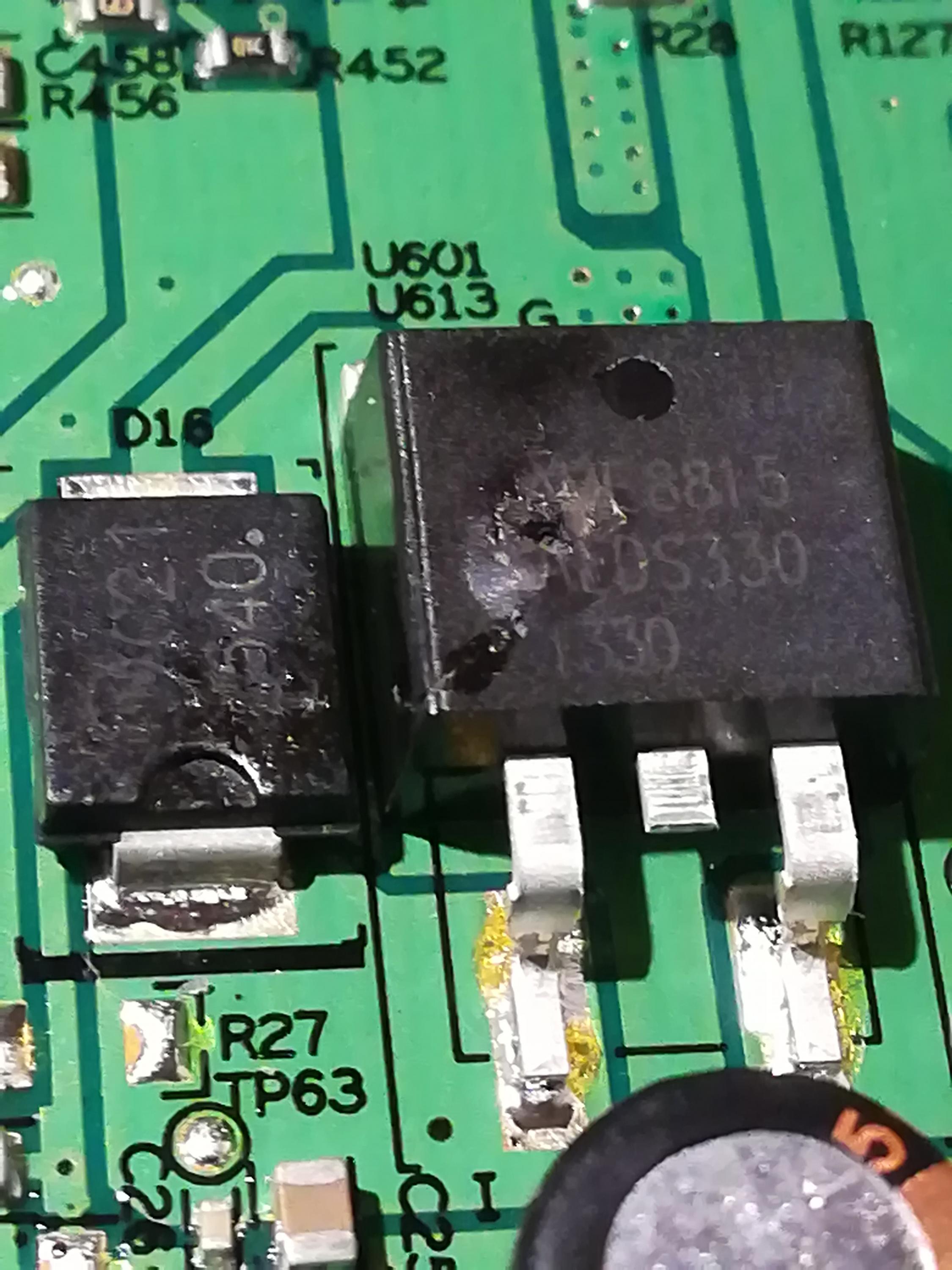

    I accidentally plugged in a POE PSU (48V) into a monitor (12V) Acer-G226HQL
    What appears to be a regulator , popped and fried with characters ( I think) :AME8815 AEDS330 T330 ?
    I cannot find this exact component and just wondered if there was a similar one for sale I could use to replace it ?
    I have a feeling the diode on the left also needs replacing , looks like 540 on that . I am thinking the monitor is salvageable

    that;s a nice hole in the 8pin chip on the left.
    is that regulator shorted by any chance??

      here is the pdf, I think the diode is a mbrs540t3g On the board you linked the diode is an "S54"

        Re: Fried this component , where to find replacement
        There's no blown ( with hole in ) 8 pin chip , unless I am mistaken?
        The regulator has a hole in it , Its pretty irrelevant if shorted or not don't you think? Its pretty much fubar
        Finding a replacement is the challenge here
          Do you know where I can find a suitable replacement ?
          The PDF shows many variants; I feel lost figuring which is needed
            I think I am beginning to understand
            AME8815 is the family of regulators
            AEDS means :
            A Pin config
            E Operating Temp ( 40 -85 )
            D Package 263
            S Number of pins ( 2 )
            The 330 in the part number is the output voltage 3.3 V
            Based on that information , I ordered this (below)
            https://www.ebay.co.uk/itm/LDO-VOLTA...72.m2749.l2649

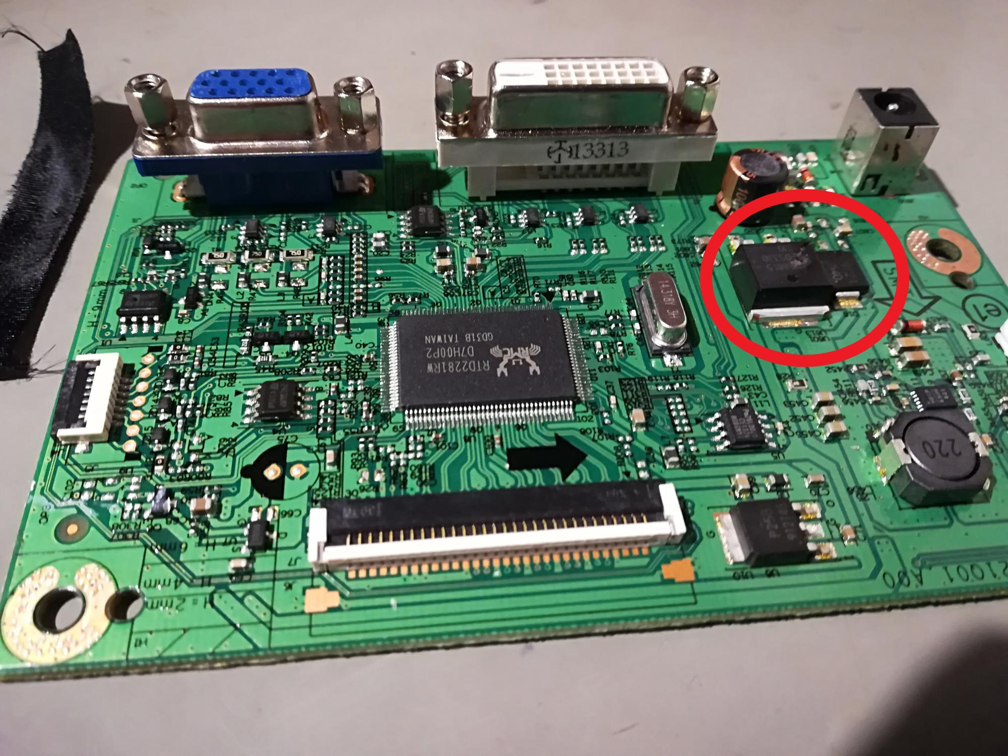

                Yeah I was staring at it a bit and it looks like it got a crater in it too:
                  It sure looks like big hole on that 8-pin device U1 to me too. 48V into 12V will sure cause lots of damages.

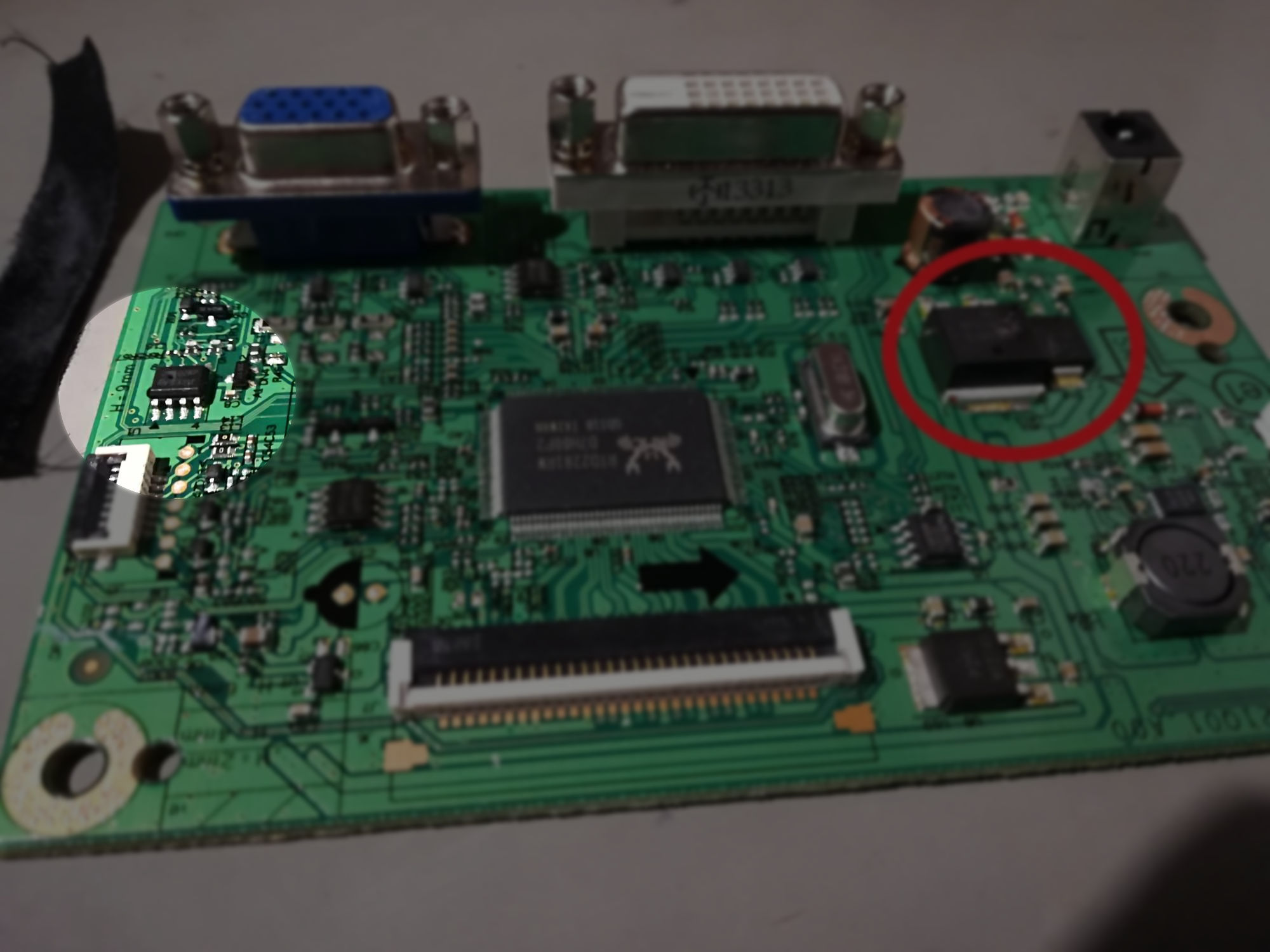

                      also, up and right of it.
                      3x 75ohm resistors - center one may be toast!
                      strange as i suspect they are load resistors for the RGB input to provide impedence matching.

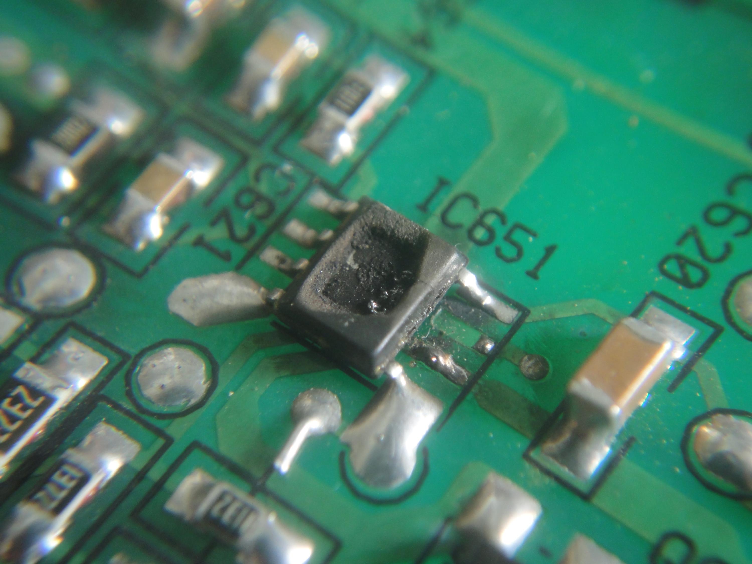

                        Originally posted by goontron
                        That crater is big enough to eat cereal out of..
                        You call that a crater? This is what I call a crater!
                        (PFC controller IC in Dell 2405FPW LCD)
                        That solder blob on the pad for Pin 6 ain't solder....
