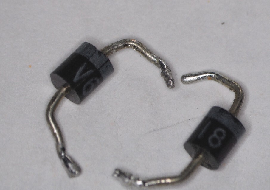

    Hi there, looking for a compatible replacement for a diode type labelled "V6 18" from a dead Panasonic plasma TV power source. Possibly a V6 600 volts diode as seen here: https://electronics.stackexchange.co...nt-diode-v6-88 ?
    Thank you

    D1F60 is the part in that other thread.
    https://www.aliexpress.com/w/wholesa...initiative_id= (photos)
    https://www.shindengen.co.jp/tools/p...ng=cn&no=D1F60 (datasheet)

      This listing suggests that the leaded part is a Shindengen diode:
      https://www.ebay.com/itm/275482477752
      https://www.mouser.com/ds/2/366/J534D1N-189239.pdf (datasheet for D1N60-4070)

        Thanks, that should be perfectly it
        • badcappo
          • Jun 2018
          • 20
          Might 1N4005 do the same job? Would be much faster available...

            That's seems OK to me.
