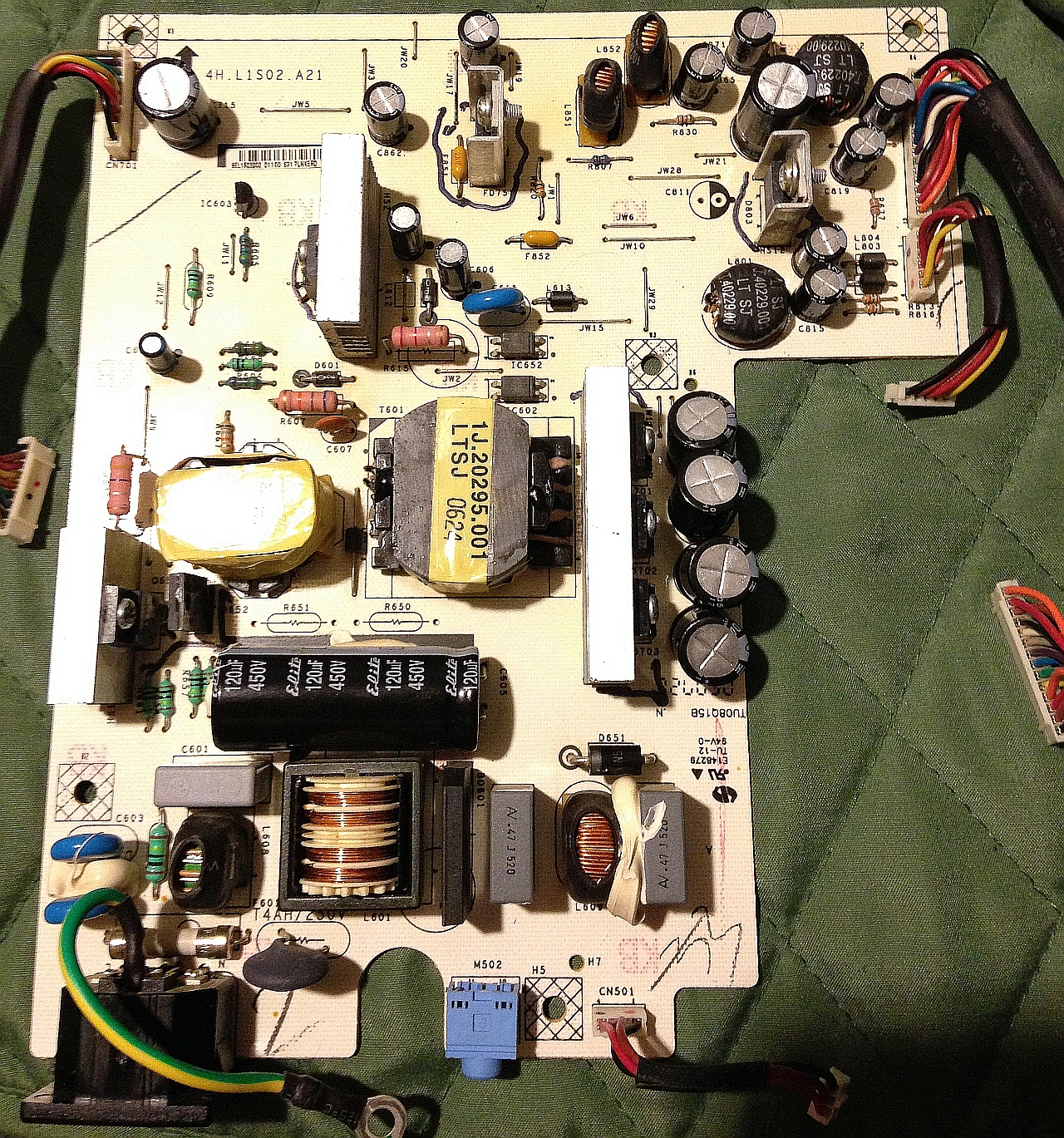

    First of all get the schematic. It will be much much easier when you have a diagram of faulty device.
    What is the board number of power supply? I couldn't find on the pictures.

      board number is 4H.L1S02.A21 im searching for a schematic as we speak, so far no luck yet.

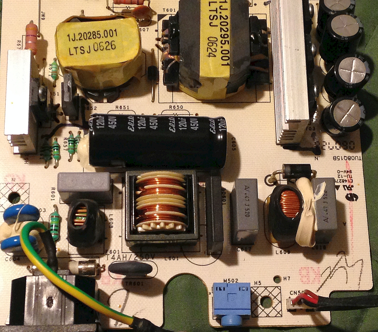

      here as some pics of the board
      • R_J
        • Jun 2012
        • 9594
        Re: attempt to repair power supply board
        If you can't find a schematic, provide very good high res. straight on pictures of both sides of the board, that way we can follow the traces and "maybe" help with the repair.
        We can't trace the circuit with only top views.
        Have you changed the small elecrolytics like c606 c611?

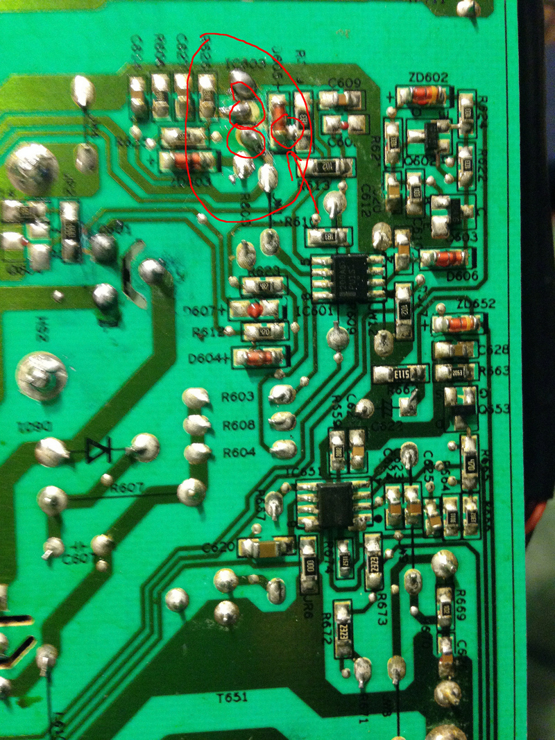

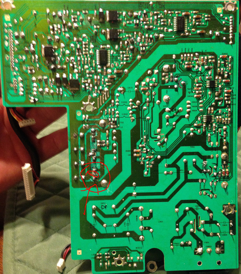

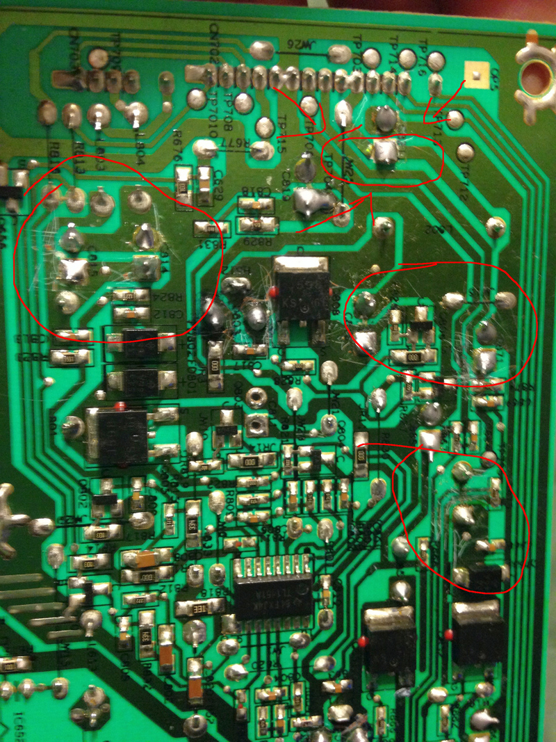

            here are some pics let me know if u need more

                        I think you caused some damage working on it.
                        I see several scratches on the pcb and a trace probably ripped near a cap.
                        Clean the board from all that dust/fur/hairs and check for continuity between solder points at the ends of all the traces that present scratches or you worked on.
                        • Dumah Brazorf
                          • Jun 2013
                          • 179
                          • Italy
                          Here the pads are gone. Make sure there's continuity between the soldering points of ic403 and the first component connected to that traces.
                          So again check all of your soldering for continuity.
                          I also see some solder between that diode and that resistor, check if it's ok on the other board.
                            What's that? Is there at least some solder on the central leg?
                            You're using too much heat and probably no flux, your solder pads/points are mostly destroyed.
                            If the solder point is destroyed jump wire to the nearest solder point.

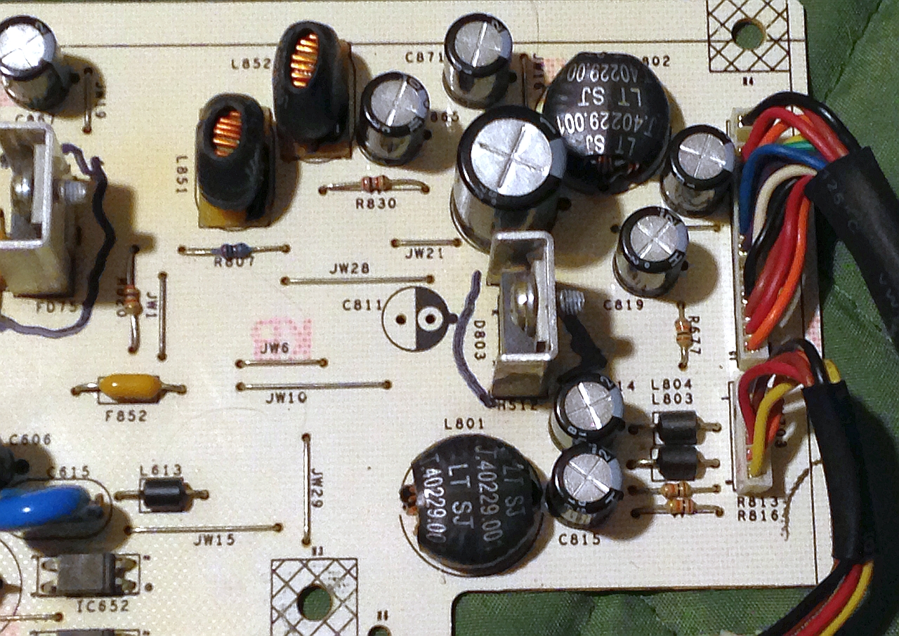

                                    Could you measure the voltages at the connector on the good board?
                                    And on the bad with the logic one disconnected.
                                    Is C811 missing?
