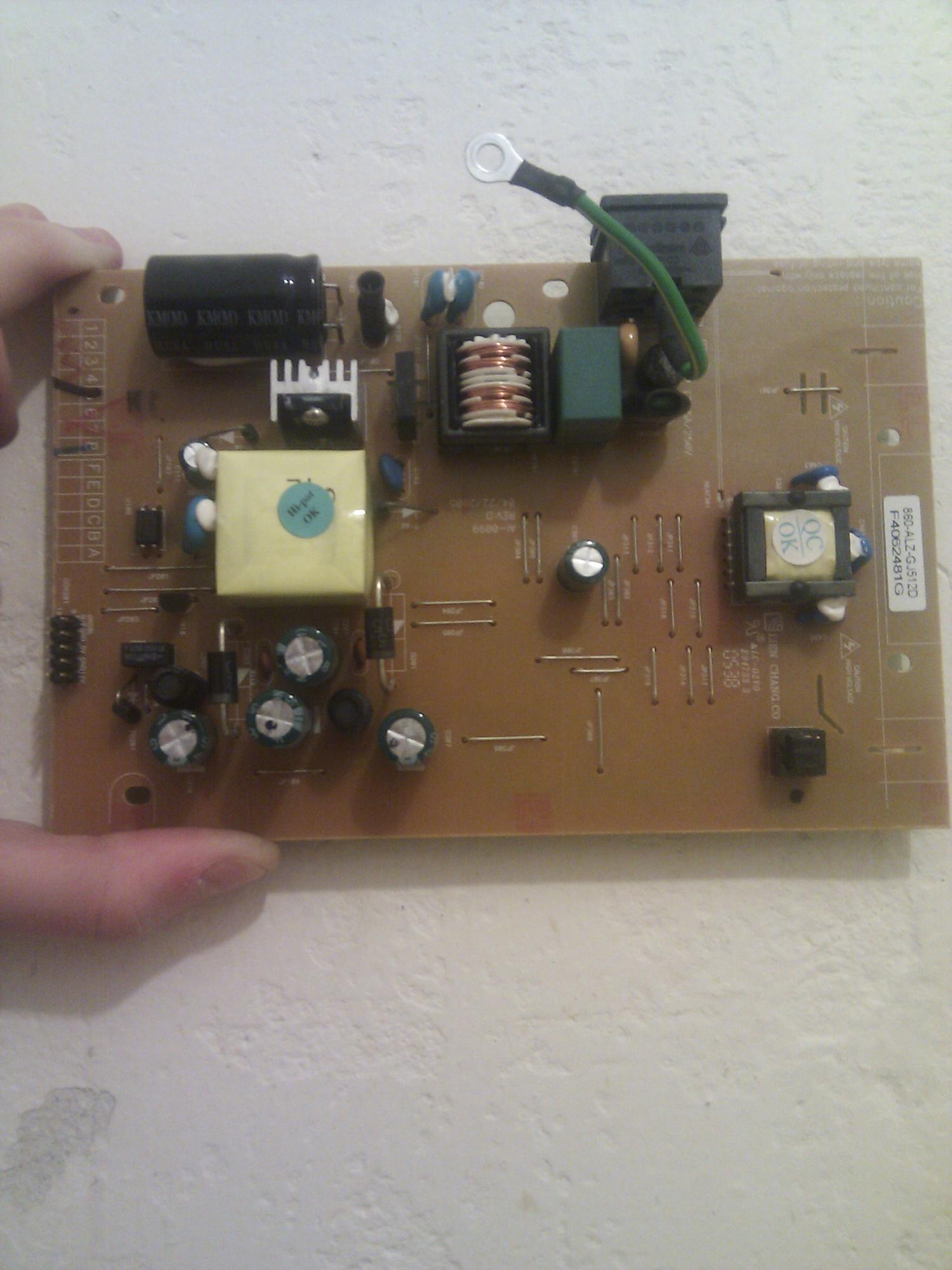

            I have the same board that I pulled out of a Emachines monitor that isn't working. I check my voltage ages and I'm getting 11.5v on the 12v and I'm getting 4.3 v on the 5v. I have one cap that is bulging but not blown yet. I found a replaced board for $34.95 online but I would rather try to repair it myself . Any Ideas?
            • PlainBill
              • Feb 2009
              • 7034
              Re: Gateway 700G repair didn't take
              Replace all the caps on the board (with the exception of the 100uF, 450V). The small caps will give you endless grief unless you replace them.
              PlainBill
              • masiril85
                • Mar 2010
                • 7
                My voltages are going up and down on my 5v and 12v outputs. I've order some new caps to replace all of them on the board. Let's hope that fixes it.
                • masiril85
                  • Mar 2010
                  • 7
                  After changing out all of the caps on the board my voltages leveled out. I reassembled everything and the monitor works great now! Thanks.

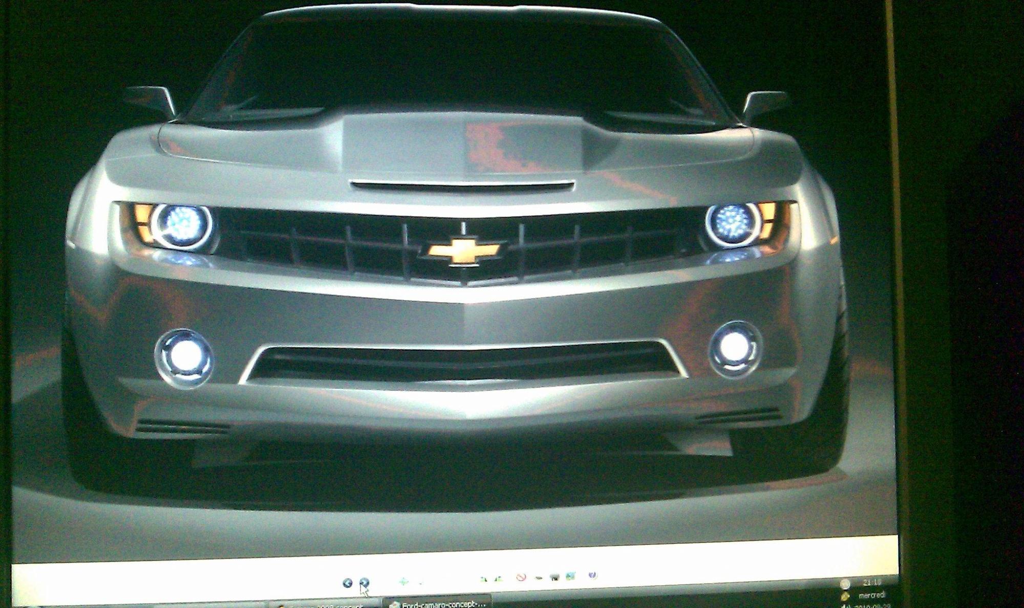

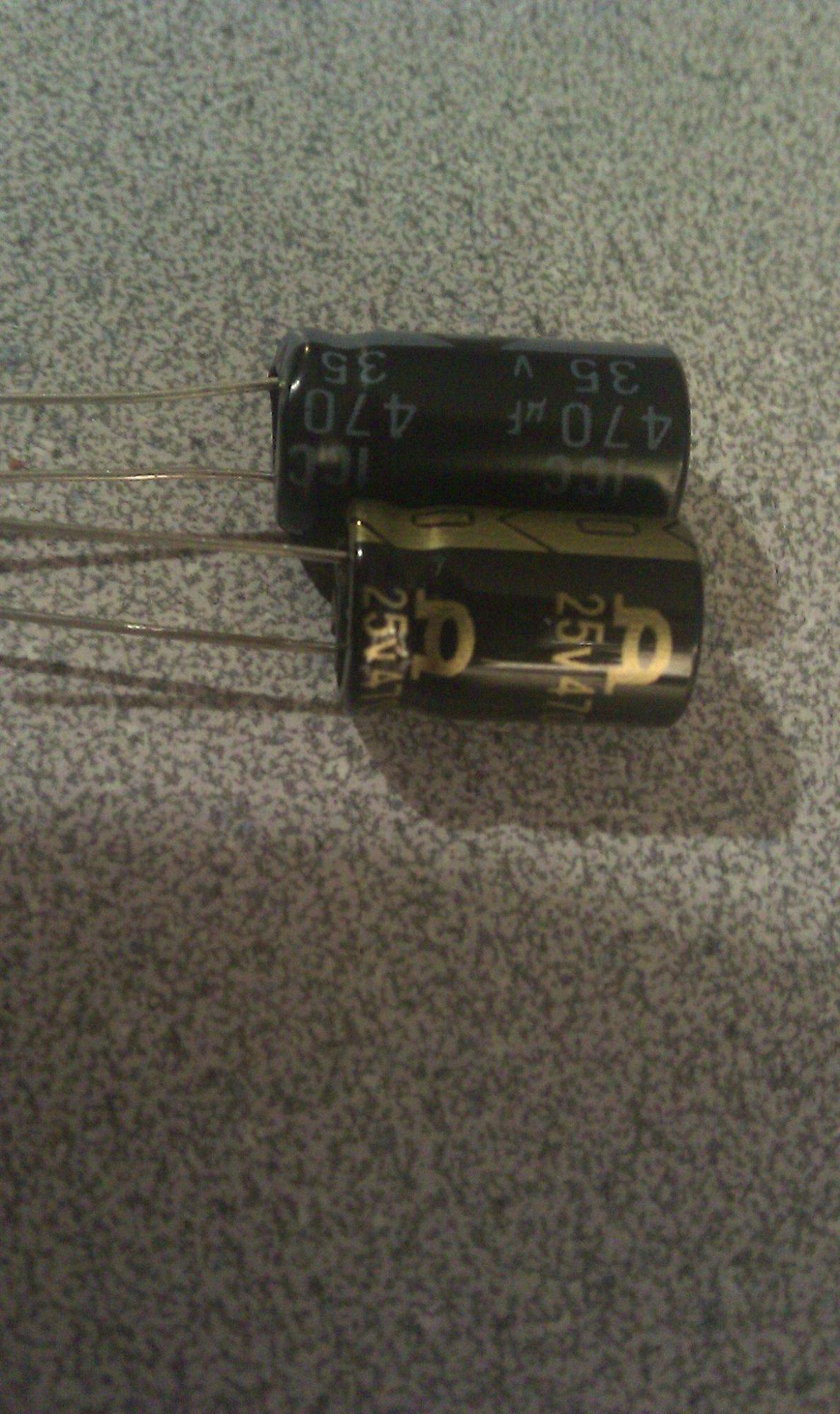

                        Hello Guy's ! I do have replace all of the capacitor but some of the 470 uf 25v to 35volt i did the 47uf to 35volt everything light's up but the thing is that that after 2 hours the red pixel come on staidy now!!!
                        anybody would have a clu about my problem ? i figure to change back all the capacitor to the original 25volt !!
                          You can use 35V to replace 25V without any issues. However, what brand and make of caps did you use? If you chose crappy quality caps, they will give you problems.

                            HI again ! Thanks to reply even after few month that the tread is open ... Here's a picture from a image of my screen to make you understand what i mean about the red Pixel.
                            I do have post the picture of the capacitor that i use because the screen is not dismount ! (No brand indicate) ,i really wish to find a clue about my problem

                              A list of recommended caps to use is listed at
                              https://www.badcaps.net/forum/showthread.php?t=2280
                              Since you are using no name caps, they could be causing your red problem.

                                ICC is the brand on the one.
                                The other is Partsnic [taken over by Daewoo].
                                Both are crap brands.

                                  Thank you guys !! i'll fix my problem ... the weird thing is this morning the screen is back to normal will see if it will change again loll

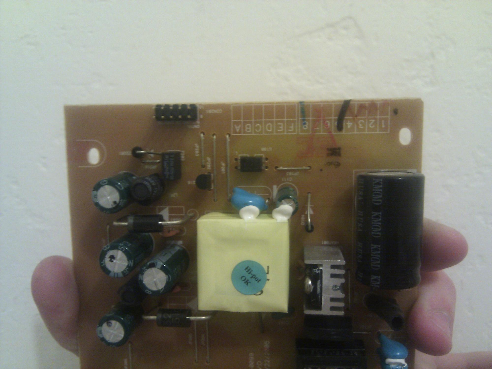

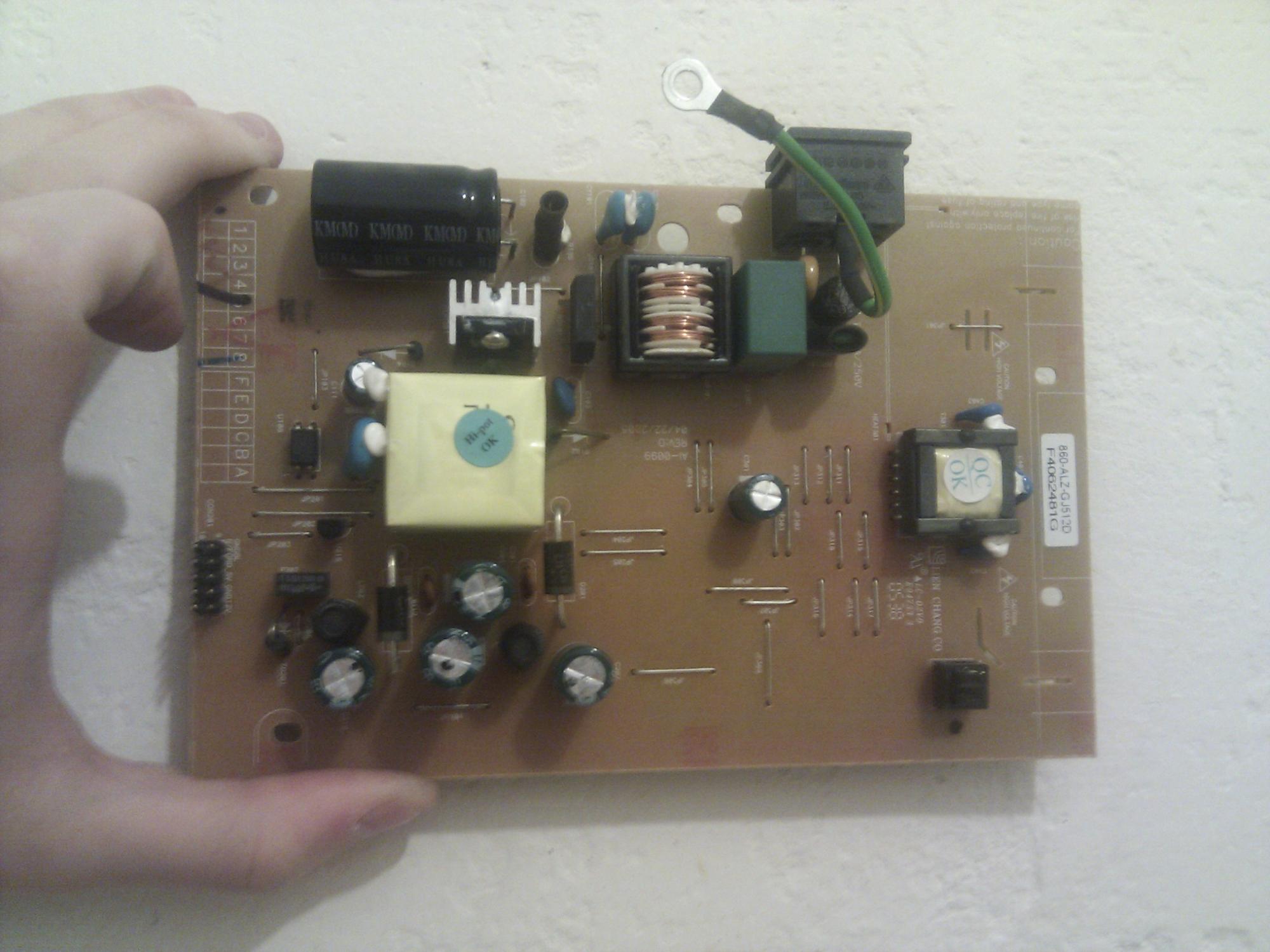

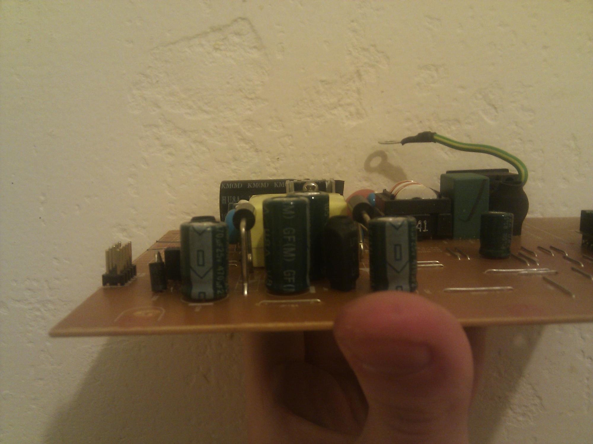

                                    Hello! Hope someone can help me with this, Didn't want to make a new thread if im honest,
                                    I found this page by searching the board number 2860-ALZ-GJ512D
                                    The monitor goes black quick, But after some messing with the settings if I have it set to around 60 instead of 100 it stays on, But its rather dull and useless becasue of that.
                                    Looking at this board I don't see any blow caps, Pictures to follow.

                                          Images now attached, Sorry for any inconvince now
