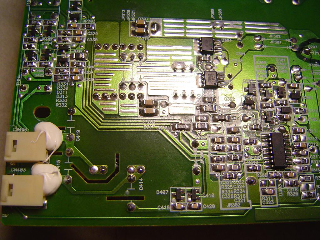

          It may not be the inverter; it could be the CCFLs. The scenario where any time you cycle the power button the display comes on for a few seconds can be either. IIRC, I've heard of one case where it was nothing more than the CCFLs were hooked up to the wrong connectors on the inverter after the cap replacement.
          I've heard of several troubleshooting approaches. One is to buy a case mod CCFL kit and use the inverter to power the monitor CCFLs one at a time to see if they all work. Another is to hook the kit ccfls to the monitor inverter and see that all outputs are working.
          I've even heard of an exotic approach where you use a scope to see why the inverter is turning off.

            ... I've heard of several troubleshooting approaches. One is to buy a case mod CCFL kit and use the inverter to power the monitor CCFLs one at a time to see if they all work. Another is to hook the kit ccfls to the monitor inverter and see that all outputs are working. ...
            I've done that. I took two narrow female CCFL connectors from a dead Proview/Sylvania 700P PSU/Inverter Board way beyond repair, and using them, modified a case CCFL kit using a two output inverter. I attach that modded inverter to a modded too ATX PSU to fire up CCFLs and see if they are the problem. It is a cheap and easy way to test CCFLs. I also have 15" LCD CCFLs to test inverters, taken from a dead Viewsonic VE500. That kind of things can ve very useful. I suspect too that you may have bad lamps in there.

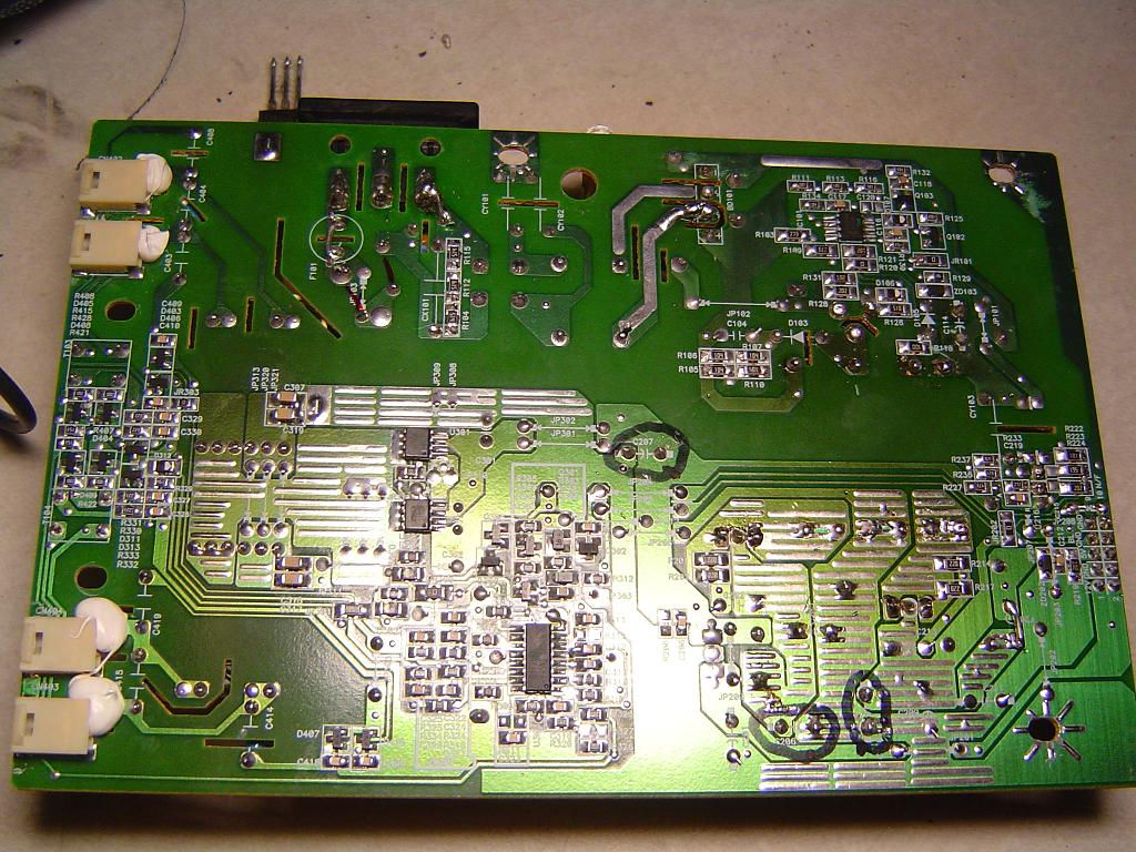

                            I have a 900G gateway monitor and it dies on me the other day... I took it apart and all the caps look fine, so I dont know where to go next. and I dont hear any ticking noises... How would I check the 5V and 12V supplies on the 2x5 pin header with a multimeter?
                            Koshposh
                              #34
                              Re: Gateway 900G frustration
                              Originally posted by koshposh
                              ... How would I check the 5V and 12V supplies on the 2x5 pin header with a multimeter? ...
                              Pins are marked for testing.

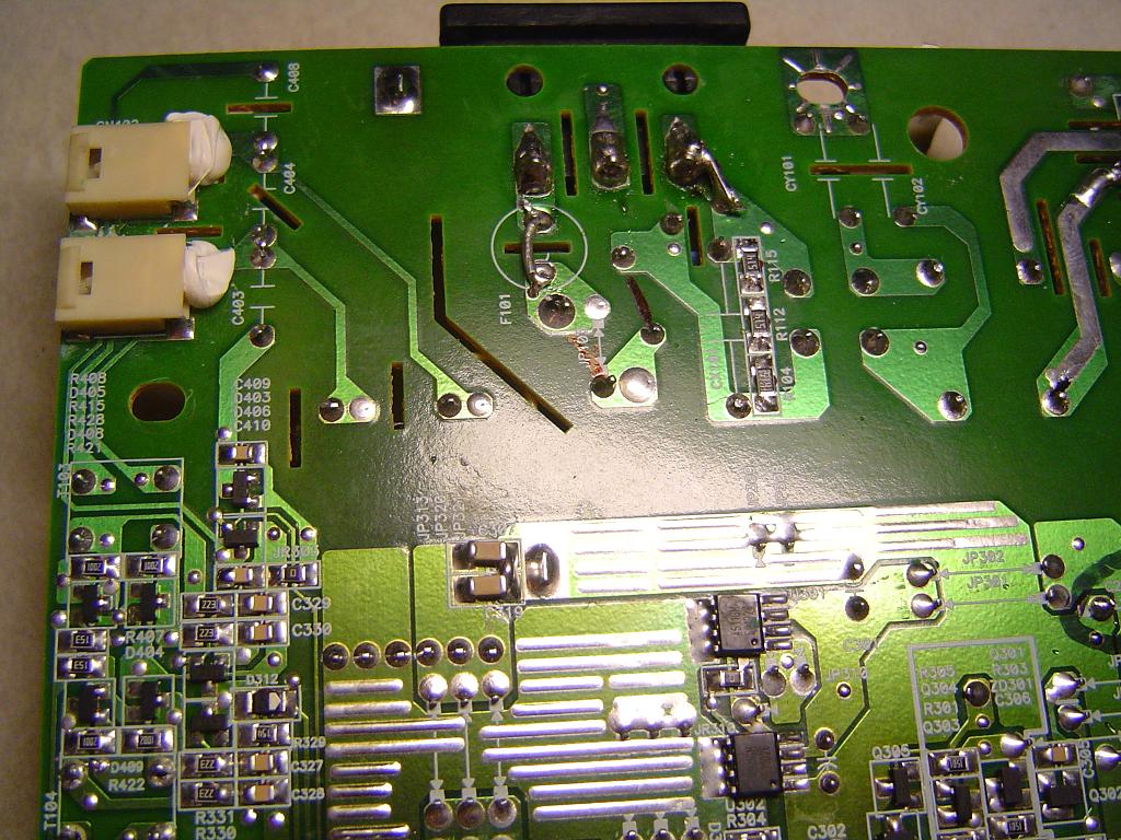

                                Koshposh
                                Plug logic card into power supply / inverter, hook up power. It may be necessary to prob from the solder side of the board.
                                Black arrow - black lead of multimeter
                                Red arrow - red lead of multimeter to read 5V
                                Yellow arrow - red lead of multimeter to read 12V
                                If 5V pulses every few seconds replace cap in blue circle. It would be a VERY good idea to replace all electrolytic caps on power supply / inverter.
                                If no 5V / 12V, with power unplugged check continuity of fuse.

                                  I've tested this PSU unhooked from logic board, to measure 12 & 5v outputs.

                                          ok so when unplugged from power, both 5V and 12V sit at 4 mV
                                          when power is plugged in the 12V sits at 4.4 mV and the 5V jumps randomly anywhere between 338 and 78 mV without any particular order...
                                          I'm getting volatages nowhere near 5 or 12 V
