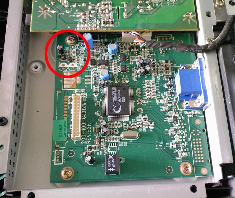

      Recaped the FPD1975W with Panny FC`s and monitor/backlight working perfectly....but...
      I have a resolution problem. At one point 1024x768 was fine but now at any setting I get a high pitched whinning and garbled image. I presume the video board is struggling somehow to display at the correct vertical and horizontal frequency.
      Googling this monitor shows it has both VGA and DVI, but not mine !...VGA only, strange.
      That being the case. I wonder if any of you chaps could confirm the Part No. of the video board.
      Thanks.

          #64
          Re: Gateway 900G frustration
          Good to hear there is a non-DVI version.
          Tried at the native res 1440 x 900 at all available freq`s, still bad.
          Disconnected the VGA and now the `Gateway` splash screen/`no video input` is garbled too !, initially it was perfect.
          Maybe the voltage supply to the Video Board is out of spec. ?
            #65
            Many video boards have on-board regulators (and their companion caps). Odds are one or more of those caps are bad. It sounds painfully like a problem I had with a VP211b.

              #66
              Check voltage out to the VBoard. Then, post a pic (good size/res) of the board to see what 5v->3/3.3v regulators are found and/or check those. It may be a Voltage problem as you said.

                #67
                Thanks for the input,
                Sounds like it would be easier to source a replacement Video Board.
                Anyone have a spare?
                  #68
                  Didn`t have to look far for the cause of the res. problem
                  Looks like the recap put paid to the Vreg, assisted by a failing cap.
                  Burned Vreg.
                  Marked as A1SB then 51 rotated, doesn`t reveal much. Probably a manufacturers No. and impossible to trace, let alone find a replacement.
                  So if anyone has a VBoard (200-100-GJ912W) or source for one, I`d appreciate a pointer.

                      #70
                      That's 5V switch to turn on or off 5V supply to the LCD, usually NPN with very low R-on and logic level input.
                      Replace it with uprated substitute. That tiny transistor is not rated for that demand.
                      Second, check the resistance between ground and 5V at LCD to make sure there is no short on 5V input high uF ceramic capacitors on the LCD circuit board. If there one, carefully look for cracked or discolored SMD capacitors otherwise unsolder one by one till short is gone. Usually fuse is first thing 5V comes through but there are other designs that had caps come first then a fuse then more caps.
                      Cheers, Wizard
