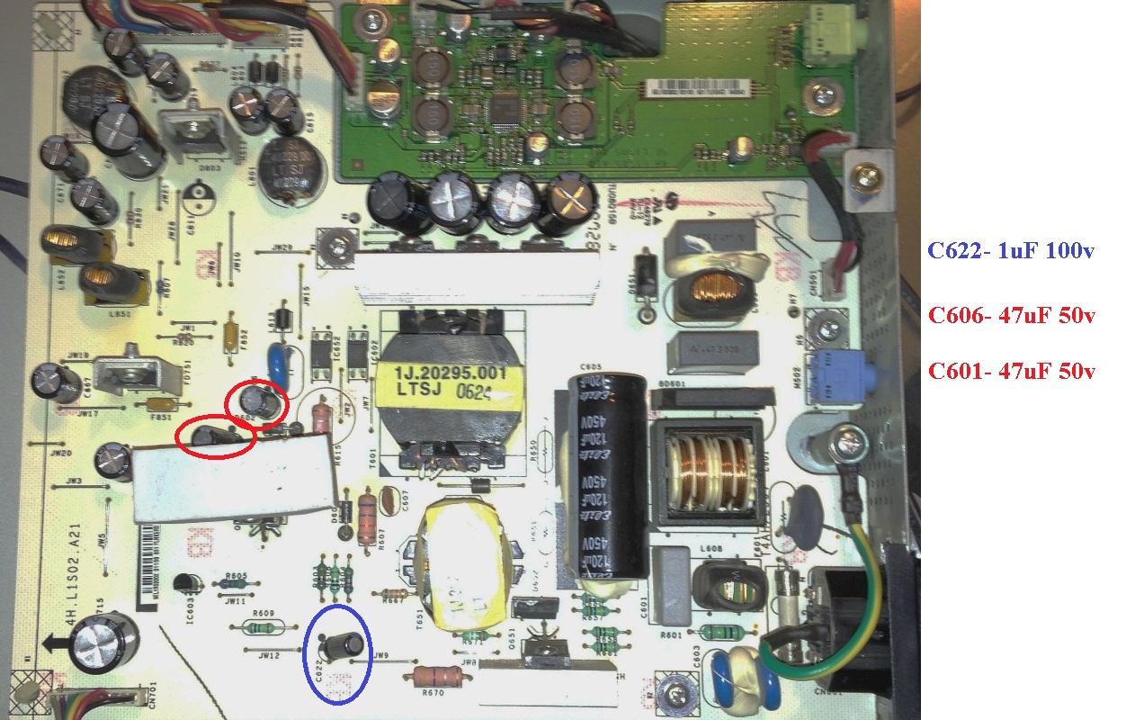

                  i decided to do some voltage reading comparison between the good working monitor, that you gave me and the one that i had, that doesnt work. and i have found an issue with mine but im not sure what to make of it. checking the voltage at F851 and F852 the voltage fluctuates between 10v and 14v. the voltage at the same locations (F851 & F852) , on the good monitor, is a steady 18.98v Any ideas as to what i should check next?

                    So i was able to fix the issue with the power supply board. I decided to replace the remaining 3 CAPS that i hadnt changed at the beginning. see attached pic. Once i changed those caps, the monitor powered on, solid blue light, backlight came on and it was even detected by windows 7, once i attached the video cable to it. But nothing was showing up on the display, not even the OSD Menu.

                      ********PROBLEM SOLVED********

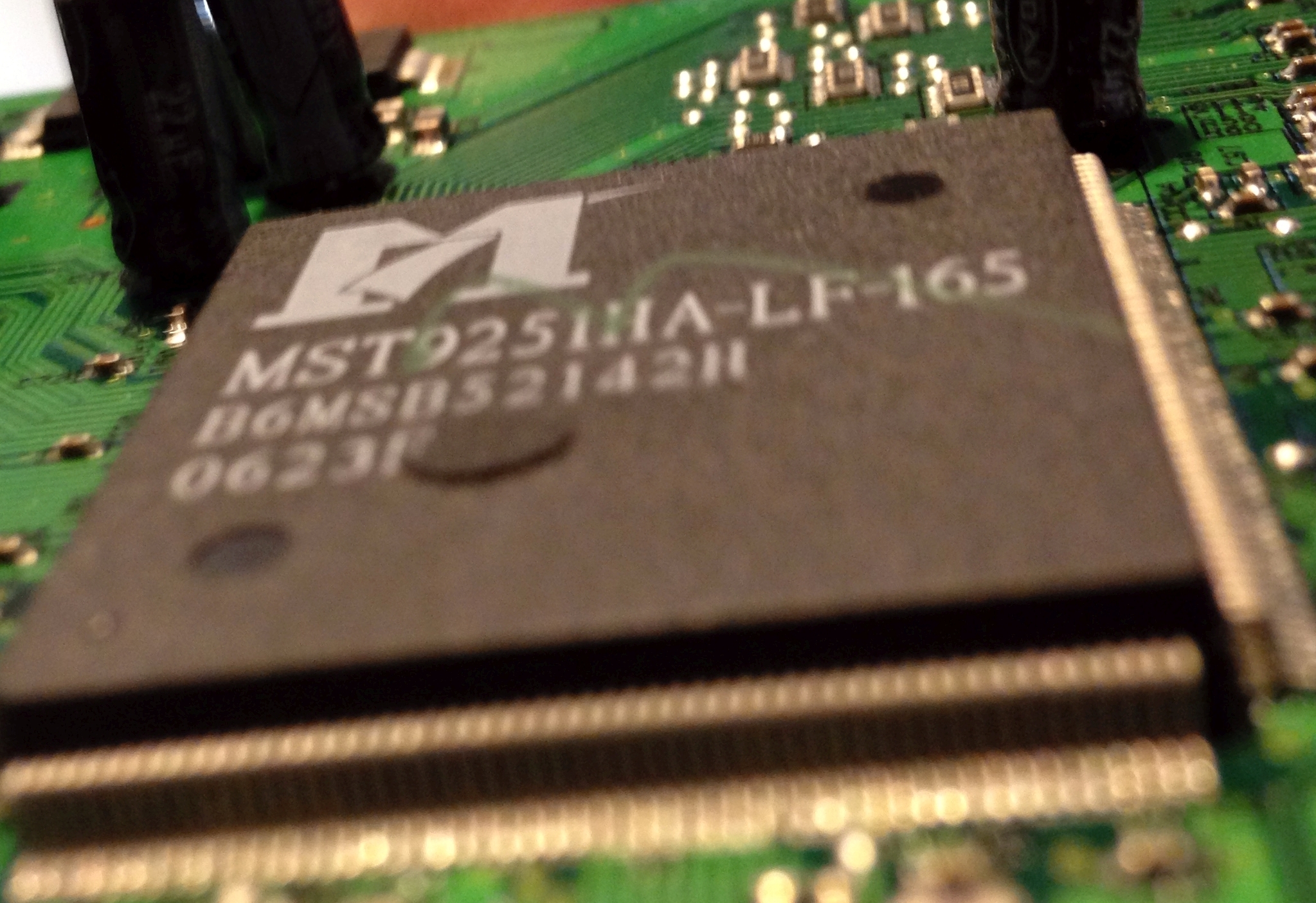

                      Attached are some pics of the problem component, although im glad to have found it, im not very happy that i have to replace the Main (Logic) Board. But it is what it is..... if i can find one cheap enough, ill buy it and post the results.

                        Ouch. One of the voltage regulators has likely shorted, and would explain the blown fuse.
                        The voltage regulator failure could well have been caused by the bad capacitors.

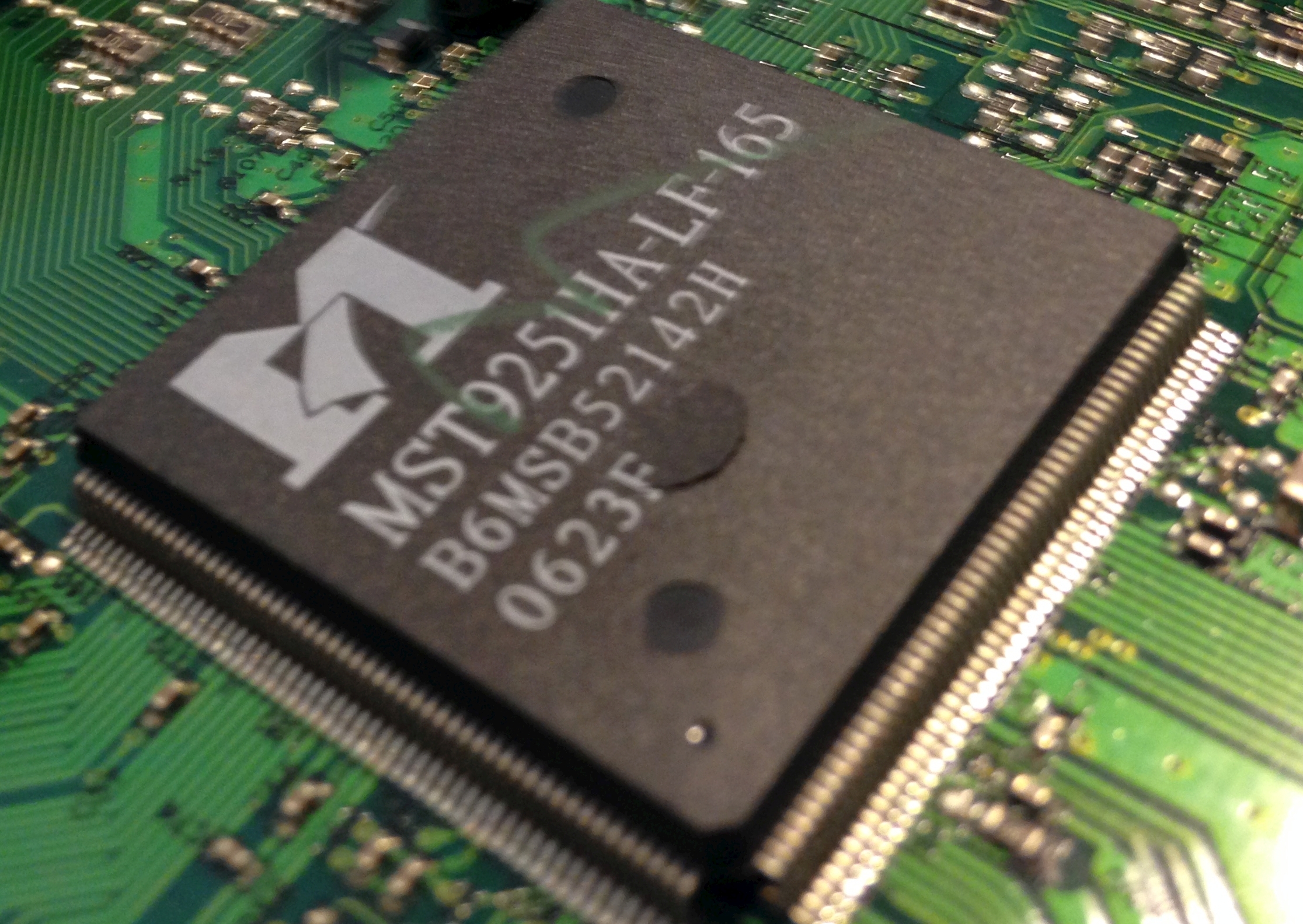

                          yea OUCH pretty much sums it up.... i hate when the end result is like this (being a component that i cant replace) im a mechanic by trade and instinctively my thoughts are to fix something, rather than replace. but it is what it is cant win 'em all. hope this tread helps someone in the future

                            Not impossible, you could buy here: https://www.utsource.net/itm/p/4911066.html
                            And soldering QFP is much easier than BGA...
                            The problem is if it needs custom firmware, which is not loaded from an external EEPROM. Then you need the custom programmer for those MSTAR ICs, and of course, the code.

                              What you could do is look on eBay etc for a universal panel driver board. That would let you use the monitor again. Though I don't know about image quality etc.
                              Might be cheaper than trying to find an exact replacement scalar board.

                                yea i found a replacement board amd installed it. but still not showing anything on screen.

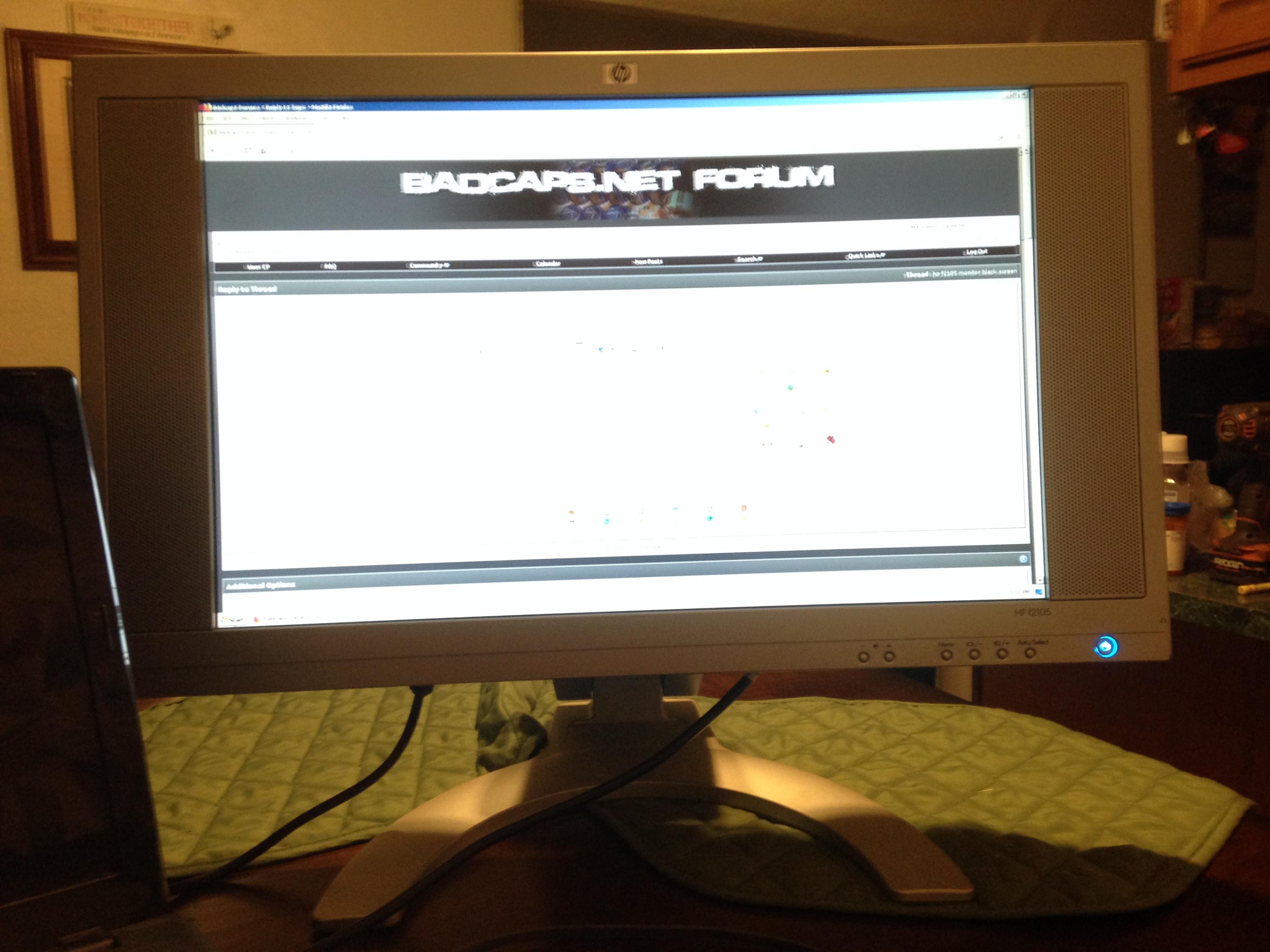

                                  ****FIXED****
                                  Finally got it working like a champ. After replacing the Main Board, i went through and RE-checked all my solder connections on the power supply board. and voila!
                                  What i have learned from all this.... When replacing the electrolytic caps, change ALL, even the tiny ones as well. they didnt look bad and i under estimated their potential for failure. Also when ordering new caps, double check their physical measurements as well as their electrical measurements. Caps are so inexpensive, compared to the price of a new monitor or whatever you are attempting to repair, that you might was well replace all of them. Although i did not have one, schematics of the board will save alot of time and headache.
                                  A BIG THANK YOU to all of you who offered your help i greatly appreciate it
