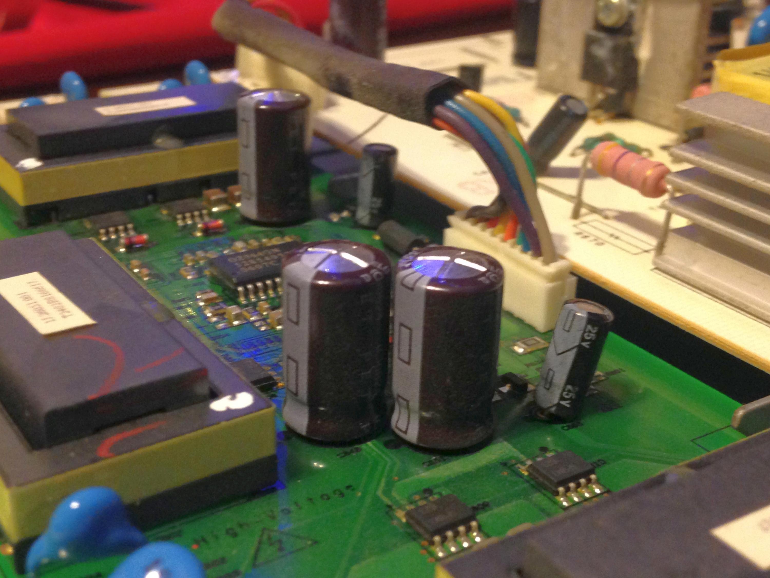

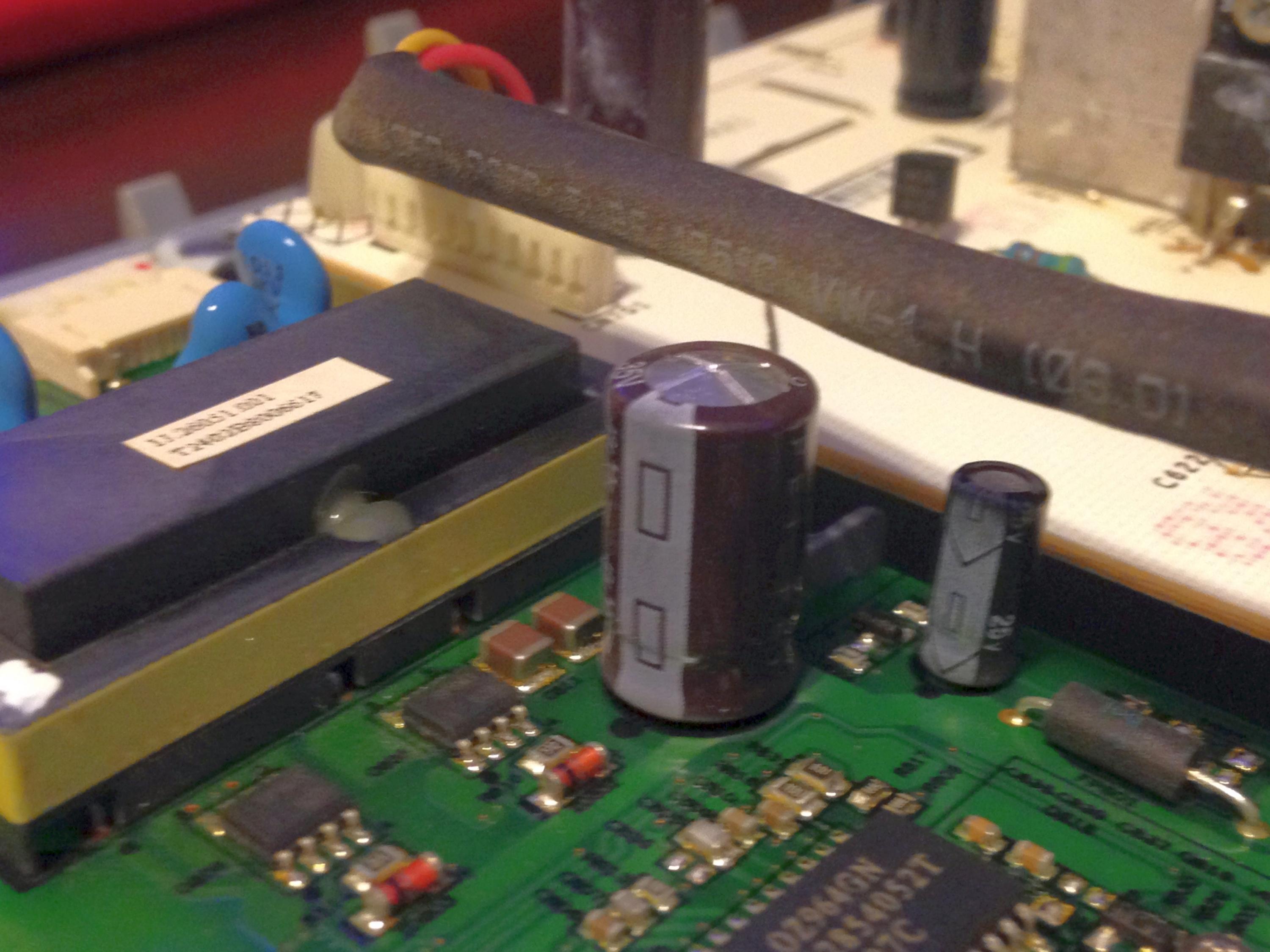

    hp f2105 monitor black screen

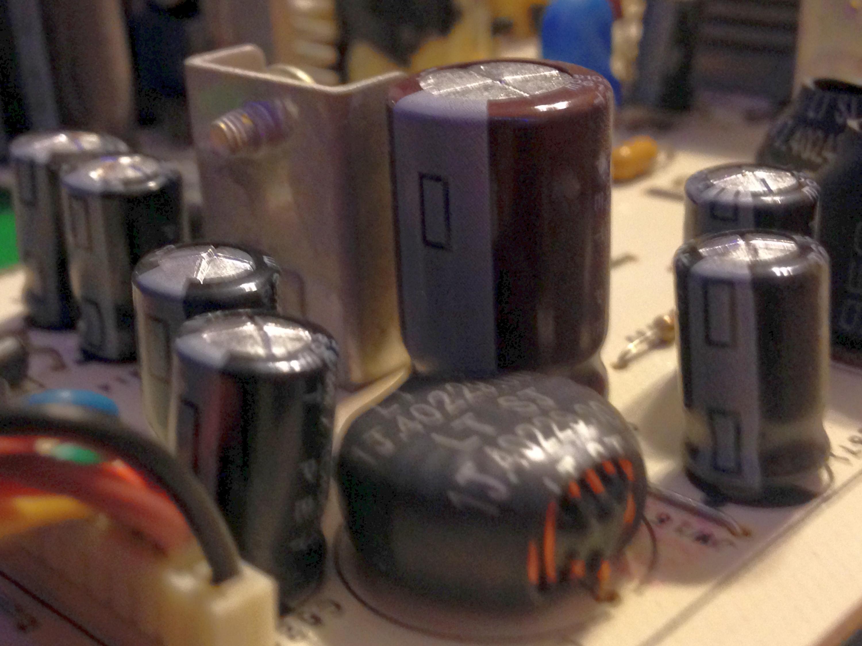

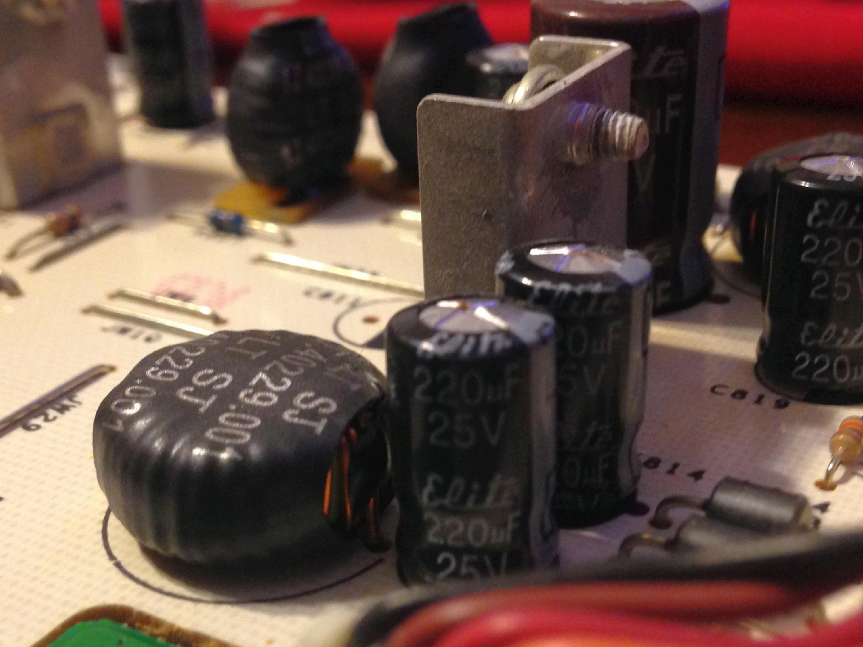

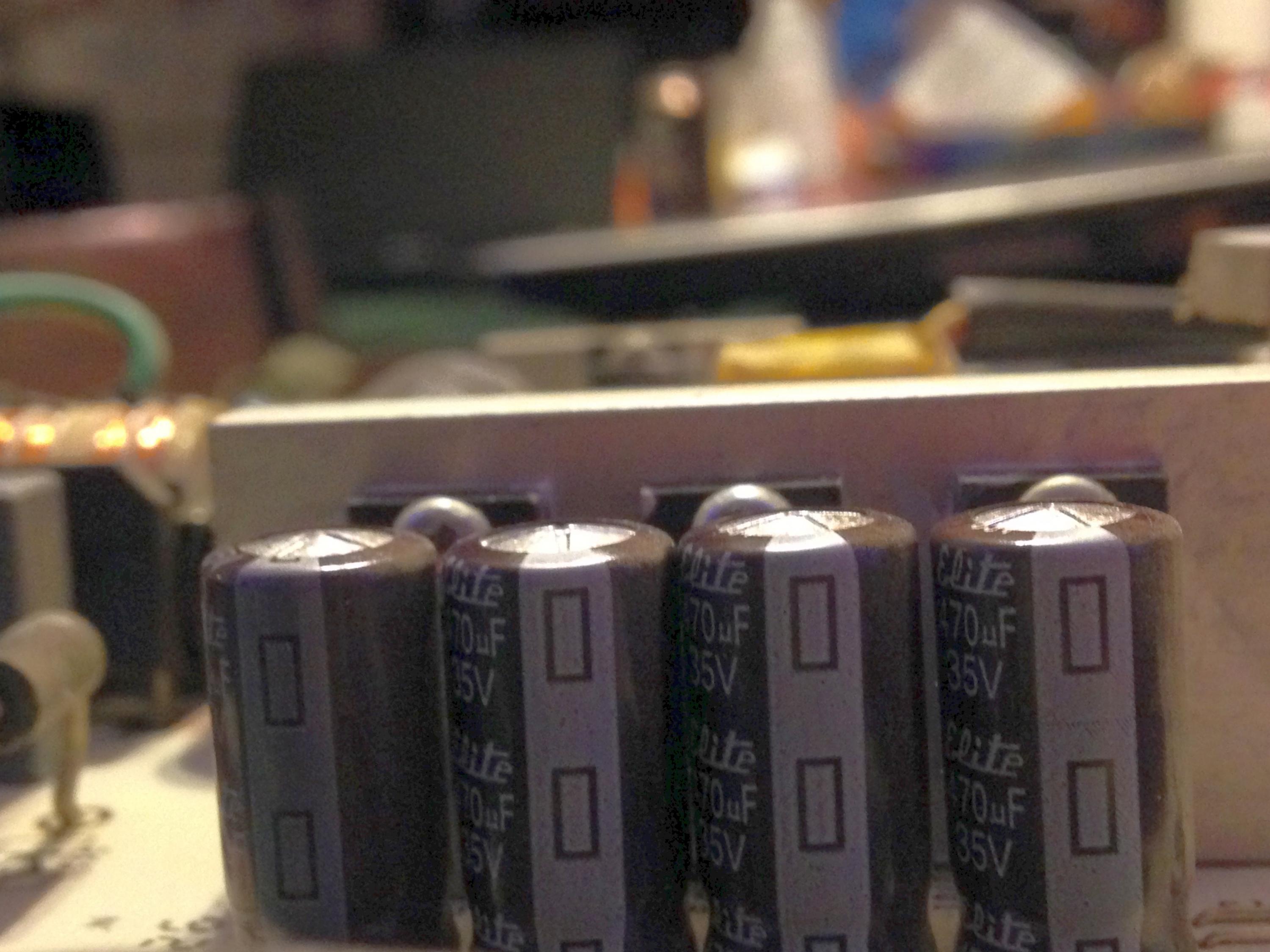

    i have an hp f2105 lcd monitor that has a black screen. the power indicator light comes on blue and stays on but the screen is black. i tried shinning a light on the screen to see if maybe it was the backlights that went out, but i dont see anything. this happened after the power went out, however my father said the ups backup came on but the monitor had shut off and was never able to get it to come back on. any ideas?? Also i removed the back cover and took some pics of the boards. i did notice quite a few capacitors that are bulged ontop. pls advise if i should replace these. the pics are below. thank you
  • 1supertech
    • Apr 2012
    • 384
    Re: hp f2105 monitor black screen
    Yes replace all even caps that look ok

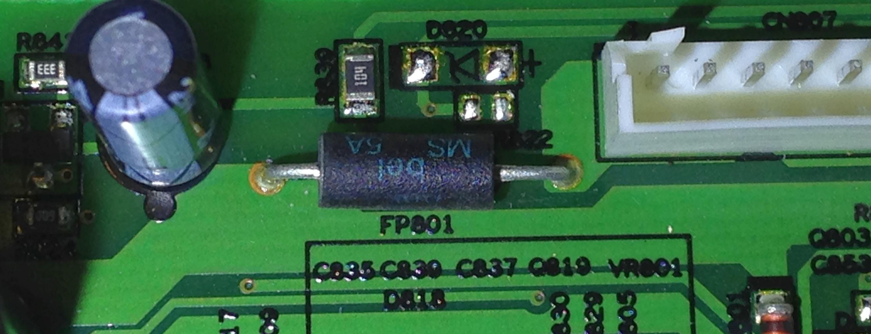

                i have found this fuse to be open, where can i get this fuse from?
                  BEL FUSE MS Series SLO-BLO 5A:
                  https://www.digikey.com/product-deta...1036-ND/614968

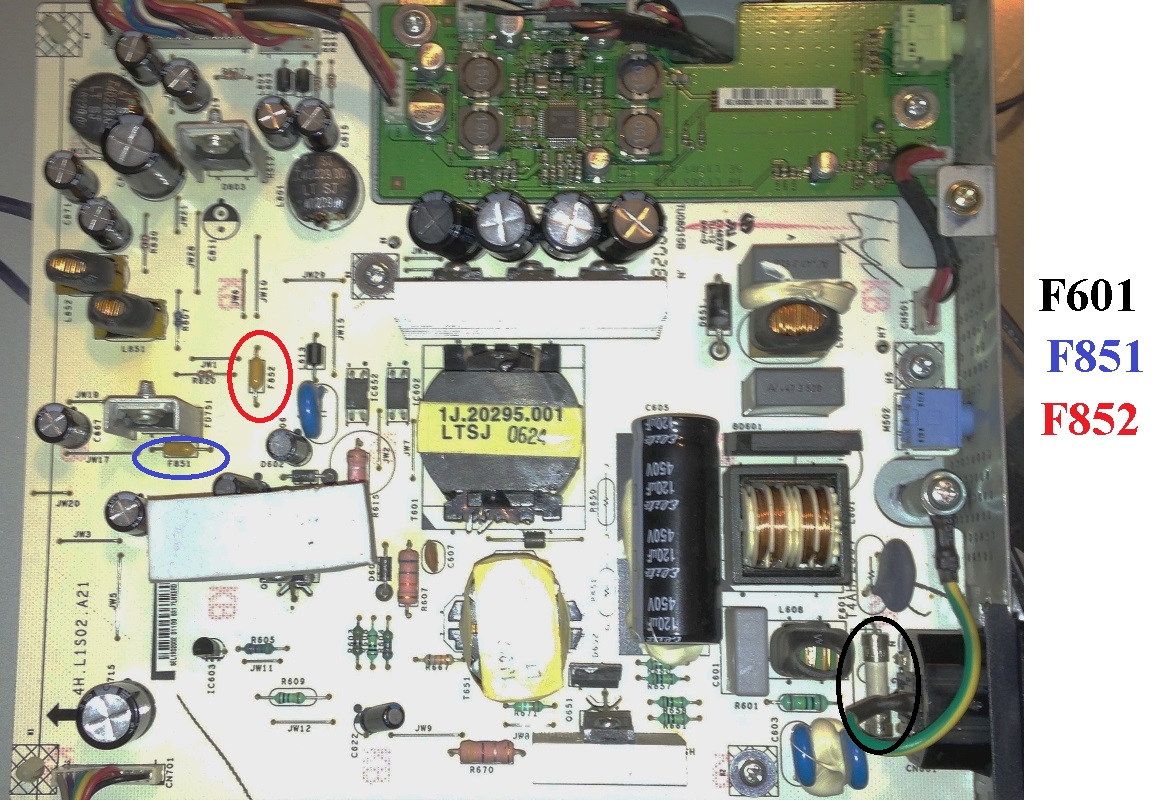

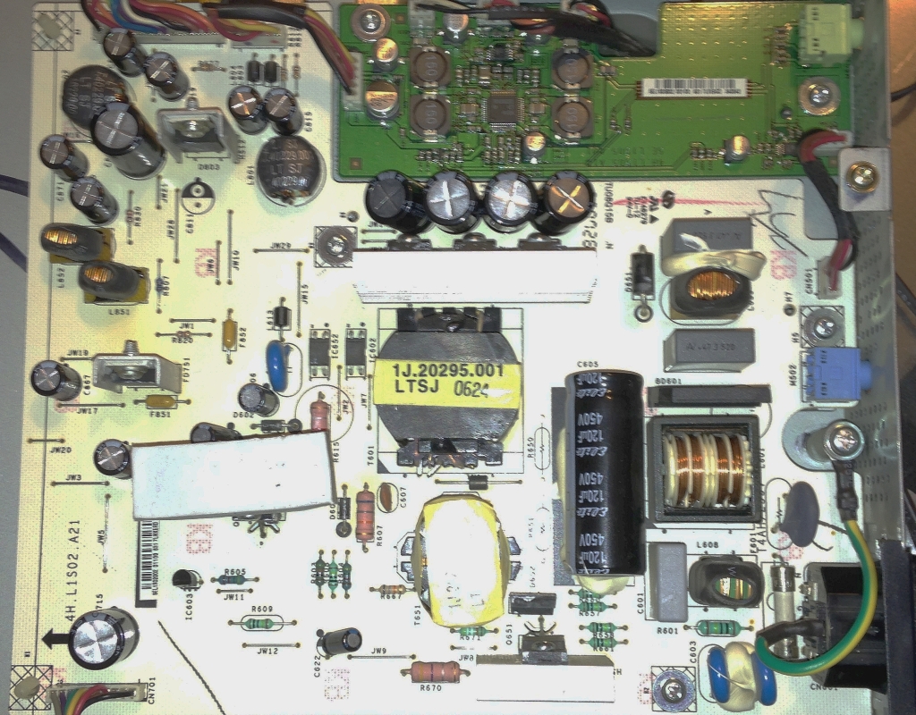

                      i got the new inverter board installed and now the power light wont come on at all. i checked the led itself and its good. but when i press the button, nothing happens. i checked the main fuse that is next to the power plugin and its good. i also checked the 2 smaller fuses on the power supply board (f851 & f852) and they are good as well.
                      attached is a pic of the power supply board with the fuses circled in different colors
                        What DC Voltage do you get by measuring between the two legs of that main filter cap (the big 450VDC cap laying on its side) in the hot side of the circuit?
                        It sounds like your NEW power supply board is dead or the cables are not connected back in place correctly. It is easy enough to put the old power supply board back in place and see if you can get the LED to come on.
                          its the same power supply board. the board i changed was the inverter board. the voltage reading on the main filter cap (450v) is 165v

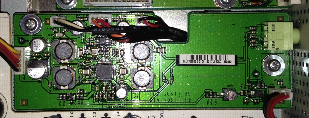

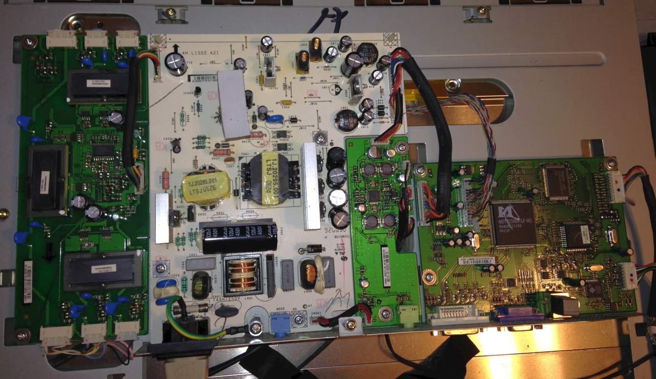

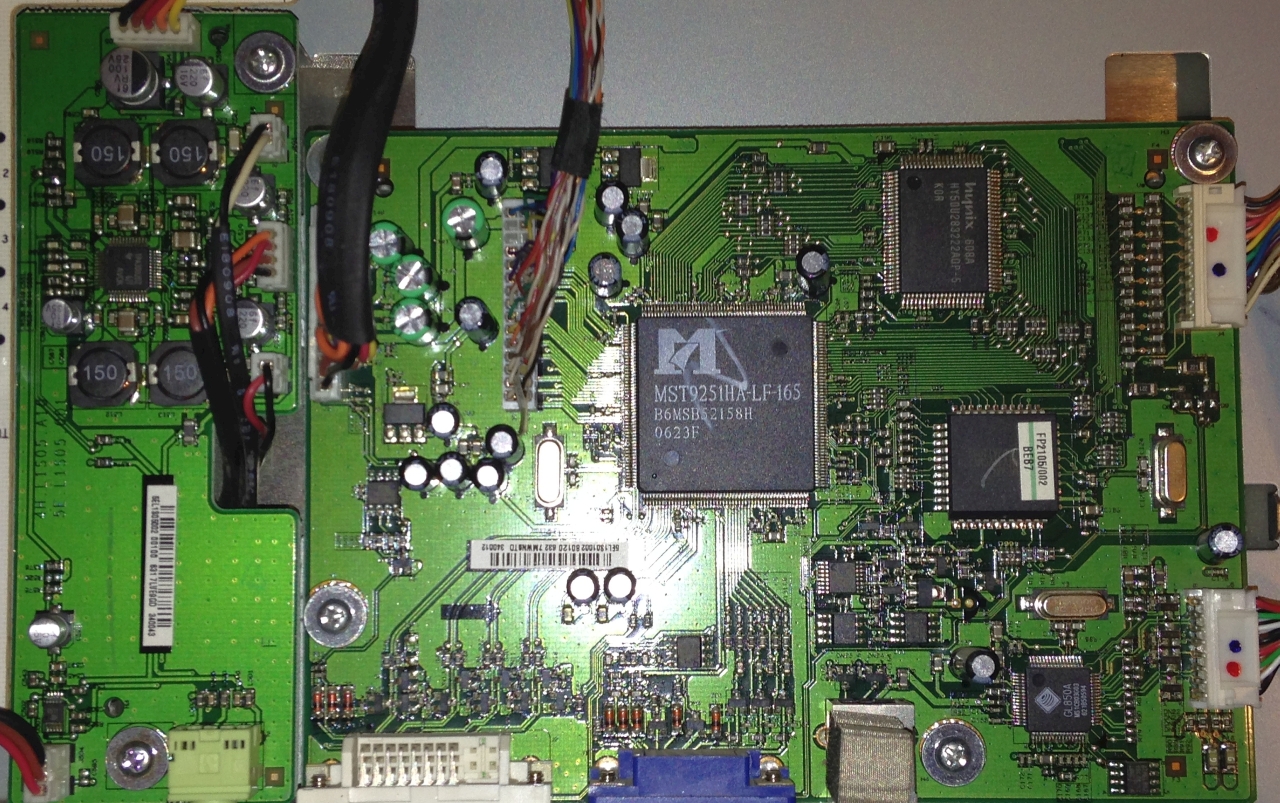

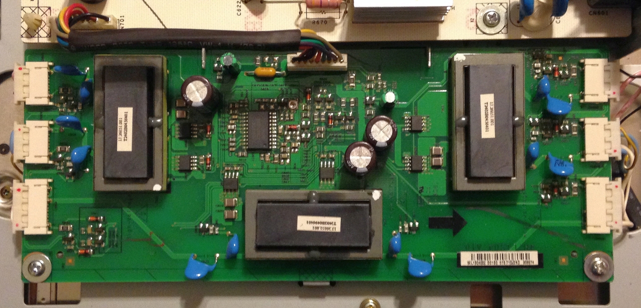

                            Sorry, I got confused. Can we see the straight shot pictures of all the boards, and pictures of how all the boards are connected together?
                            • ryn0909
                              Professor X
                              • 122
                              here are the pics you requested

                                  If you disconnect the cable to the inverter board, will you get your power LED back on?
                                  • ryn0909
                                    Professor X
                                    • 122
                                    nope
