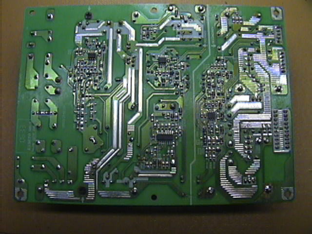

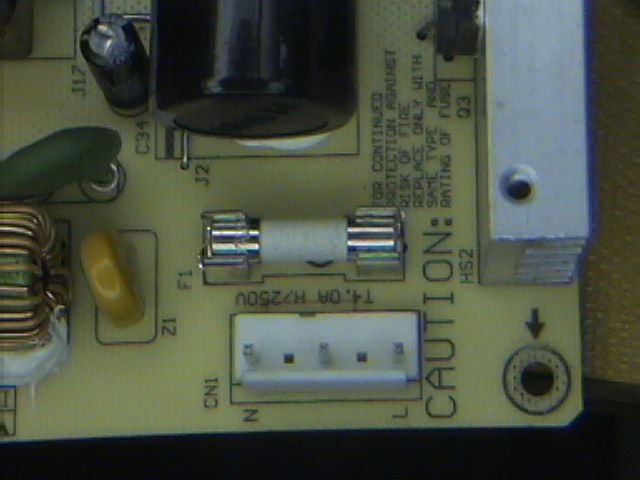

    I'm working with a Spectroniq model PLTV-3250 LCD monitor.
    It uses an FSP194-3F01 power supply.
    The monitor won't start, there appears to be a standby led on
    the front but its not lit. In the supply I am getting DC voltage at one of the
    leads (about 160V) of all of the heat sinked transistors except
    one, so the supply is live, but it wont start. I found some caps
    that were swollen at the top, so I replaced them along with some other
    smaller ones just for good measure. Also I replaced a shorted surface
    mount transistor. Then I went through and checked other transistors and
    diodes which all checked good. Just wanted to find out how to rig this
    supply so I can run it on the bench. That way I can see if I still have a
    supply problem, or something else in the monitor. I've seen different material
    on how to manually start a computer supply but this one is a bit different.
    I'll post some pics so you can see what I'm working with.
    Thanks.

    Re: Spectroniq PLTV-3250 wont start
    if you put AC on the input connector (1st pic, 2nd row) you should have voltage on the output (5th pic, 1st row). As long as the AC is connected (and if a switch exists it is in the on position) that PSU should be "live" (output V present) as it is only a PSU, I can't see an inverter section there.
    That is the way I've tested some (the key word here is SOME) PSUs (other ones right in the monitor or device in question). If you replaced bad/suspected components on the PSU, and there are V out then I guess the next move would be the main/Video board.
      Thanks for the reply,
      I'm not getting DC voltage at the 5, the 16 or the 24 volt outputs.
      I'm suspecting that maybe there is still some wrong in the supply, but
      I am not sure. I have seen articles on how to start a computer supply manually
      without it being installed in the system. It involved jumping two
      of the terminals together to start it, and also having some sort of load
      connected to it. This supply is very similar so I thought that this one could be rigged in a similar fashioned to start it on the bench without it being installed in the monitor. I was just curious as to which of the terminals I would need to
      focus on to get it to switch on. If this can be done it would be a quick way to
      isolate which area of the monitor I need to focus on.

                                      • glen65
                                        • Dec 2008
                                        • 30
                                        Update:
                                        Ok the new supply came in, I connected it to the monitor
                                        and all works fine. However I still wanted to repair the old one.
                                        So I took both supplies to the bench and connected a source to them
                                        in order to do some comparison testing to find out why I wasn't getting
                                        the 5 volt standby voltage. I check for voltage on the new supply
                                        in the area where I had to replace a surface mount transistor (Q7) on the
                                        old supply, it measured just under 15 volts. I checked the same areas
                                        on the old supply and the reading was about 1.5 volts. I went to diode
                                        test and rechecked the transistors and diodes in that area of the board,
                                        and all looked ok. Next I decided to do some comparison resistance checks,
                                        for this I decided to beak out my Simpson analog meter. I noticed that
                                        the resistance between two of the terminals on Q7 was lower than
                                        compared to the new supply.
                                        I started desoldering one leg of some
                                        of the components to find out which one was abnormally lowering the
                                        resistance of the circuit. I eventually made it to a surface mount
                                        15 volt zener diode. Once disconnected the resistance of the
                                        circuit went back to normal to match what I was getting from
                                        the new supply. I checked the diode out of circuit with my
                                        analog meter and sure enough that's what was throwing the
                                        resistance off. The diode was neither shorted nor open and
                                        had originally checked ok using diode check on a digital meter
                                        when in circuit. I replaced the diode then put the supply back
                                        into the monitor and it checked ok.
                                        To turn the supply on you need to inject 3.3 volts at the terminal
                                        marked o/f on the socket where the 5 volt line is at.
                                        I imaging if one wanted to start it at the bench it
                                        it could be done by simply tapping off of the 5 volt standby line,
                                        with something to reduce the voltage.
