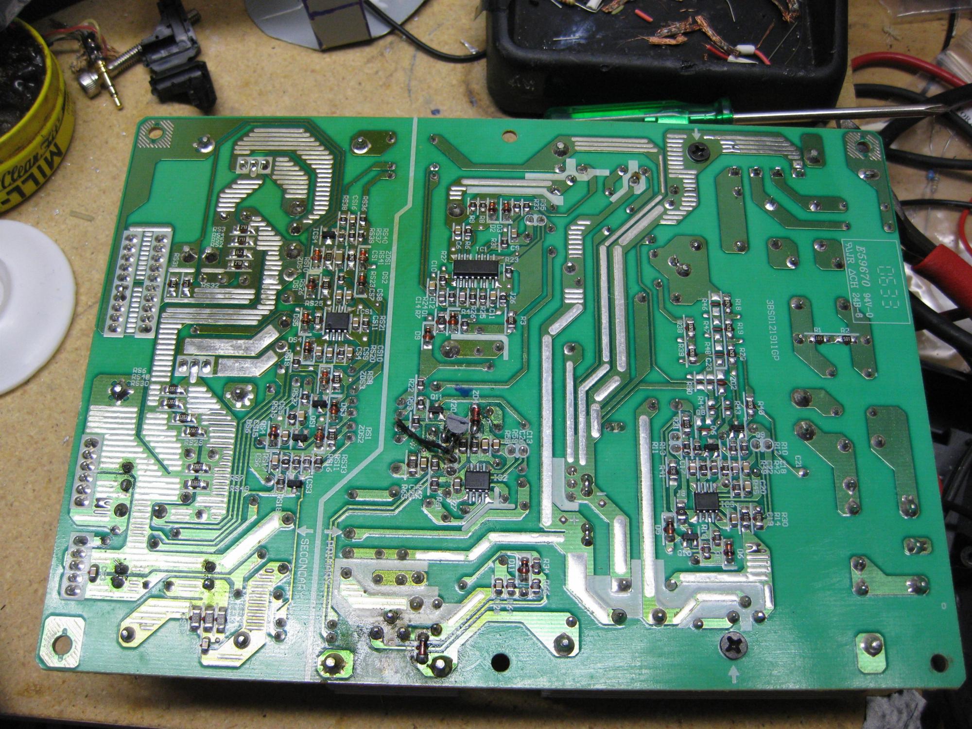

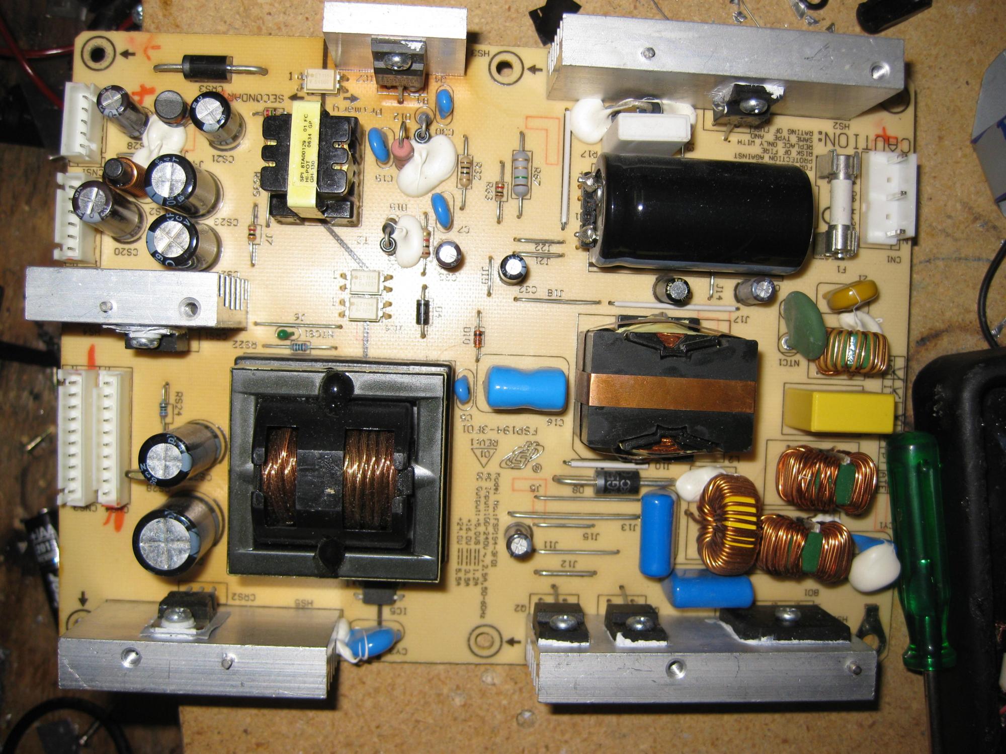

          Re: Spectroniq PLTV-3250 wont start
          Here are some pictures of both sides of the board. There is definitely what appears to be discoloration from heat on both sides of the board near Q4. I popped Q4 out of circuit and checked it with the diode check setting on my DMM, and there were no shorts.
          Also tested ZD3 and it appears fine.
          The area around Q7/ZD4/C33 is a bit messy. Q7 is now a MPS2222a. The solder pad on C33 came loose as I was desoldering it (carefully too, didn't think I had too much heat), so I traced the route along the board and jumped it to the next pin. There are no shorts in that area, however, I have made sure that everything is spaced apart, and I put electrical tape between all connections before testing.
          C33 is original, however...tested the ESR both in and out of circuit and got about 1.2 ohms, which seems acceptable. Is it worth replacing anyway? I don't have any 33 uf caps around, and can't get any locally, so would have to order some. I didn't think it'd be likely to help, seeing as the ESR is OK.
          6 caps were actually replaced in total (5 larger ones and C32). All caps in there right now measure good ESR.

                        This is a dual power supply. The 5V is standby, so that section is working. I would expect to see a line coming back from the main board that switches on the main supply.
                        IC1 is the SMPS controller for the main supply, IC2 is the SMPS controller for the standby supply. IC3 is the PFC controller. I'm trying to identify the control line, but can't see any legends on the connectors.
                        PlainBill

                            Here are some views that show the legends for the connectors.
                            I'm getting voltage between the 5Vs and GND, as already stated. If I plug in the set and try to turn it on, I get 3.3V between the O/F pin and GND for a short time. I believe this is the signal from the main board trying to switch on the supply, as you mentioned. This tells me that the main board is working fine, correct, and it's the PSU not starting?
                            Thanks.

                                Yeah, probably. You can trace the 'O/F' signal across the power supply. It appears to go to one of the two opto-isolators near the center of the board.
                                PlaiinBill
                                  #76
                                  The original 33 uF cap was a Capxon GL. I know Capxon are all pretty much crap.
                                  If I trace the O/F pin, it appears to first go through jumper J4 then to resistor RS35. That resistor goes to the spot on the back of the board between "QS4" and "CS6" labels. From there, it seems to go through DS6 and CS15 (capacitor is across the diode?). Then it goes through RS27 (which tests good). From there seems to go to NTSC1, which is on the front of the board. From there, goes through jumper J7, where it then splits.
                                  One side of the split goes to RS9 on the front of the board (which tests good). From there, goes to pin 1 of IC7, which is labeled:
