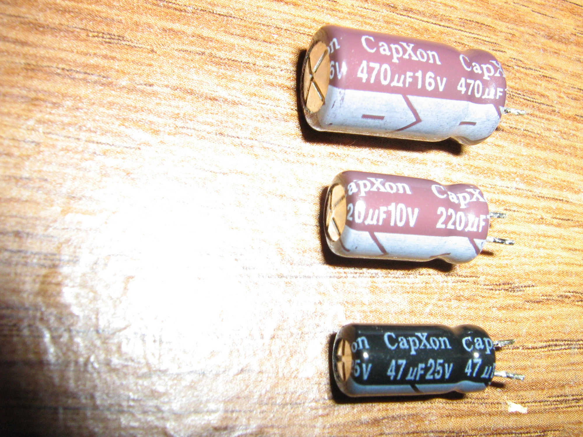

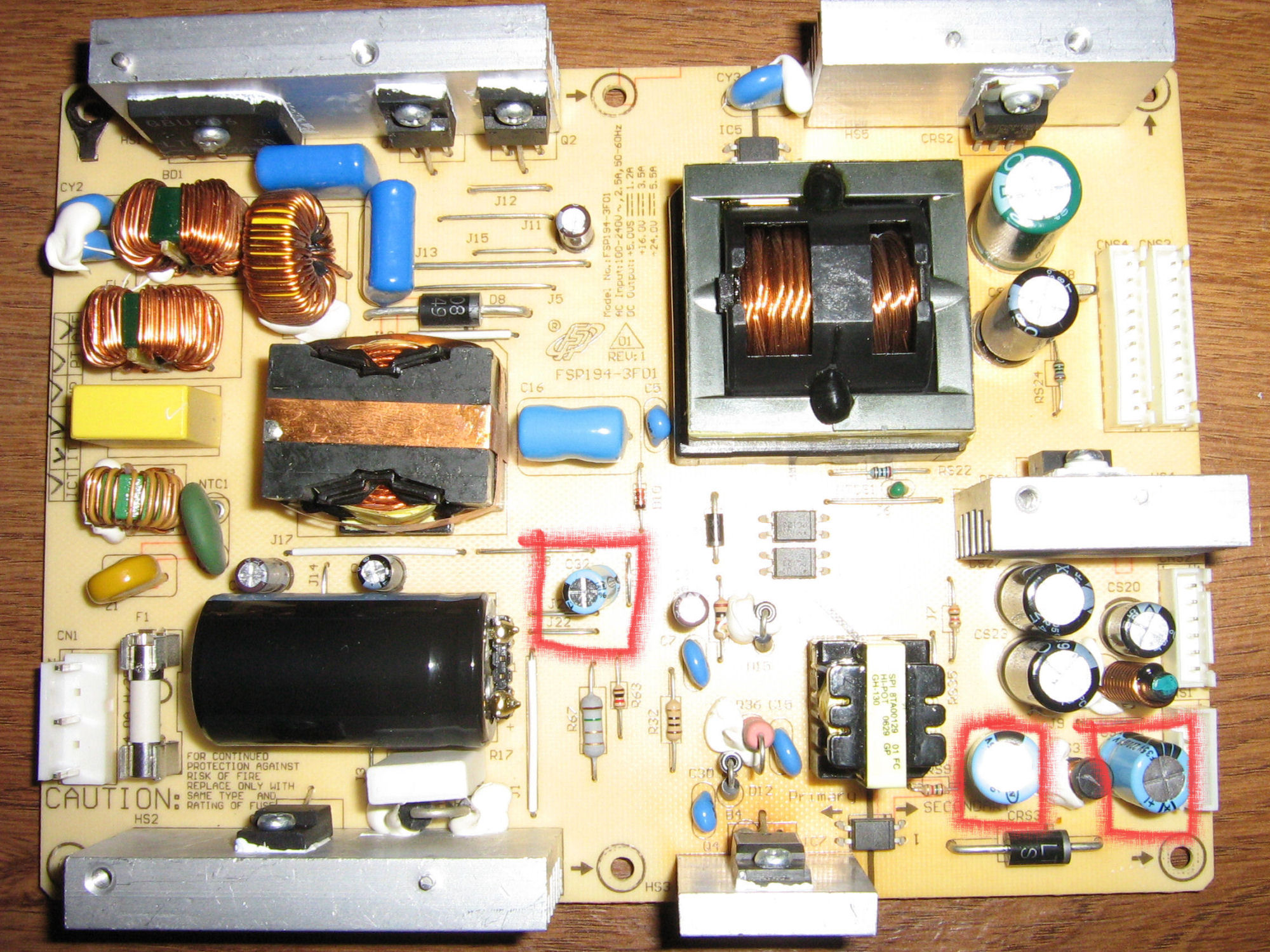

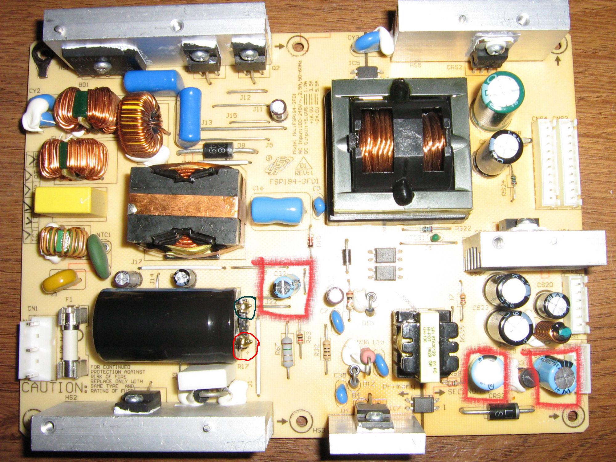

                        Hello again, I soldered on 3 caps. I took a picture of the Board and Highlighted the Caps that got replaced. But nothing happened when I hooked it back up to the Monitor I guess i should go ahead and replace ALL capacitors on the board. Earlier in this Thread someone said they replaced Transistor (Q7) where is Q7 ? ? I can't find it, could someone help me find (Q7) ? ?

                          I forgot to ask: Does anybody know if the "MULTIMETER" in the picture above has the ability to check the Transistors and Capacitors on this PSU ? Thanks Again.

                            1. Use capacitors we recommand here.
                            2. Q7 if you can't find it on component side or nor on solder side (SMD), the chances is that PSU is different.
                            3. Multimeter will only measure capacitance not ESR which is seperate meter made for measuring ESR. If caps says capxon, prudent to replace all. Carefully measure voltage on the secondary side (DC outputs with your multimeter on DC setting.) Unplug the PSU and remove from TV, check the big cap for stored voltage with meter first to prevent surprises and use 100K resistor to slowly discharge the cap. Next multimeter on diode mode, check the secondary diodes for shorts or opens.
                            Cheers, Wizard

                                from what he says I want to replace the 15v Zener Diode ? can someone tell me if the CIRCLED component in the Picture is correct ?
                                I also found Q7 but it is soooo tiny, I also circled it in a different picture, can someone tell me if this is Right ?
                                I went to Radio Shack for the 15v Zener Diode, all they had were 12.5v Zeners so I found these on EBAY. Are these the proper replacements ?

                                  First rule of thumb: Don't go blindly changing components because someone says this worked for him. Further, when he sprinkles lots of 'I think' s in the suggestions, be very, very cautious. Note that he referred to the zener as a surface mount package, the one you circled is a through-hole type.
                                  I feel like a challenge tonight, so let's work this one out together. The first step will be to take a picture of the bottom of the pc board. Turn off the flash, have plenty of room light, and use a tripod or steady the camera so it isn't shaking. I will try to identify the points to measure.
                                  The other thing to do is to hook the board up and measure the voltage across the large cap. Use the DMM you pictured, set to the 1000 VDC scale. I've indicated where the red and black probes should go (red probe to cap lead in red circle, black probe - well, you get the idea. Report the voltage you measure.

                                    OK I hooked up the DMM just like you said and it read 157v....... I think it is a 160v PSU so that is good, right ? I also supplied a pic of the back of the board with no Flash. hope you can read it. T H A N K You very much for any support.

                                        Excellent picture. On a 21" monitor it is easy to see everything.
                                        Nominal voltage across the cap should be about 165 volts; 157 volts is within tolerances. That tells me the AC input, RF filters, and bridge rectifier are all fine.
                                        I have identified 6 points on the output side of the board and crudely marked them A - F on the picture. Check the voltages on those. Set the meter to the 200 VDC range to start; reduce it to the 20 VDC range for any pins that measure less than 20 VDC. The black probe will go to the area I have outlined in black. The red probe will go to the other areas I have outlined, report the voltages you read at each.
