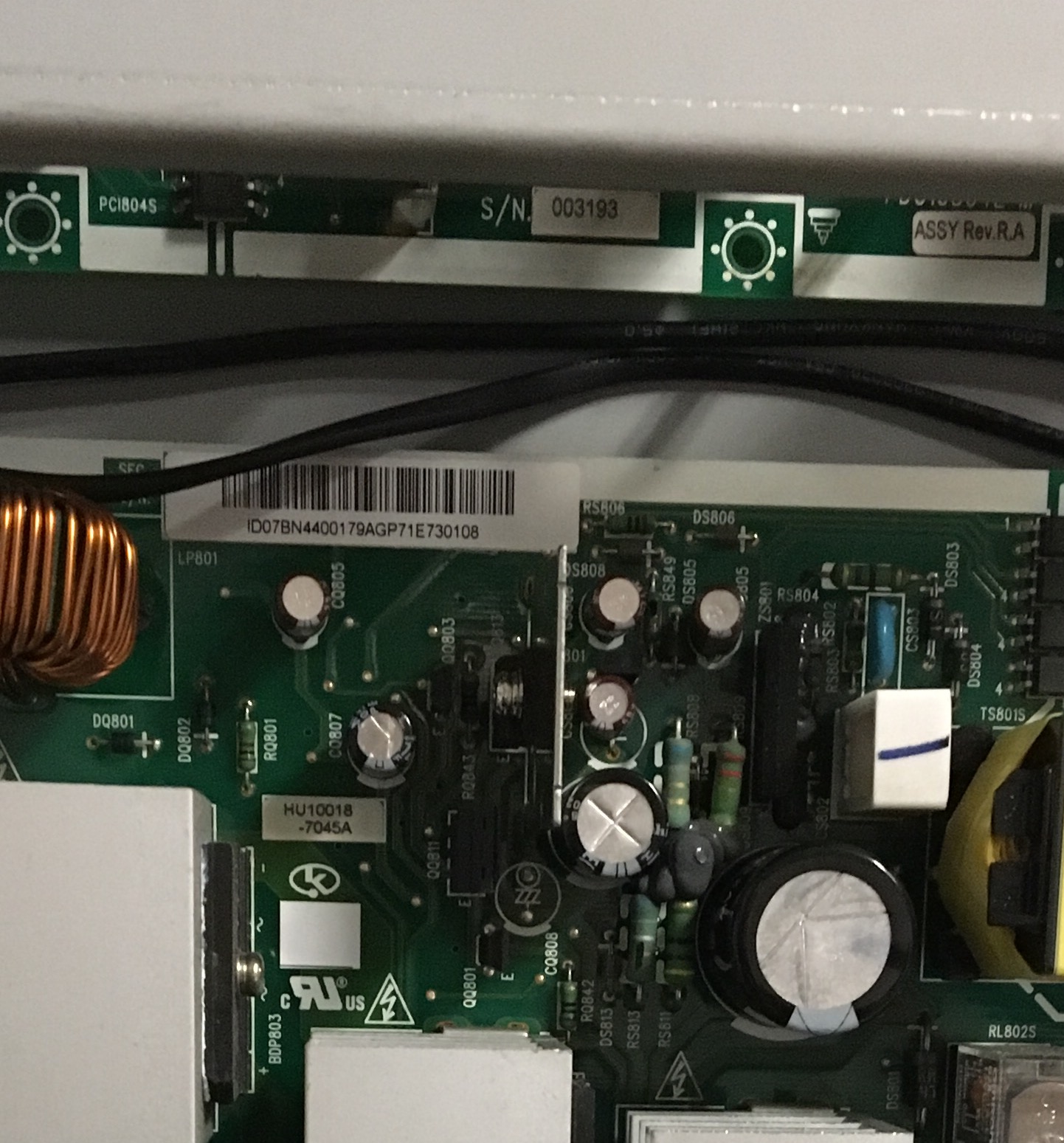

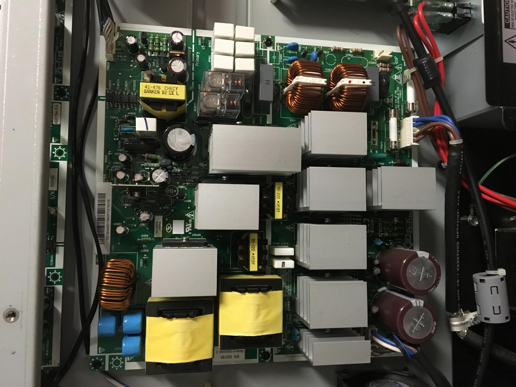

        Re: LH70BVPLBF/ZA samsung 700DX2 power issue
        The first picture is the board that is suspected to be the trouble, it is the one making the noise yet just by a quick view it doesn't look like any caps are bad
        The second pic is the group of caps I've narrowed the noise down to, does anyone see anything out of the ordinary or suspect to cause trouble?
            Are u sure the noise isn't coming from surrounding transformer or inductor, does inductor feel warmer then it should?
              I'm not able to Check temperature because it will not stay on for more than 2 seconds, but is the noise anything I should consider suspicious?
                          So a small update, I got down to the capacitors and they were all metered out to be good. I started pulling the jumpers between components and I came to the inverter controllers, with all of them plugged in the set turns off, so I started unplugging them one at a time and pressing power, sure enough one of them finally made the set turn off with being connected and when disconnected the set stays on fine but no backlight. I ordered a replacement on eBay that identically resembles the board I pulled except for a few numbers on the serial number, but everything else is identical. I'm not positive that the board swap will fix it but I'm praying it does and is the practice of mismatched serial numbers safe? Everything on the board, print for print matched up but the yellow paper tag. I'll keep you posted
                            You can check the rectifier with your DMM in diode mode (power removed to the board), in fact the 3 pin rectifier is just 2 diodes "front to front"
