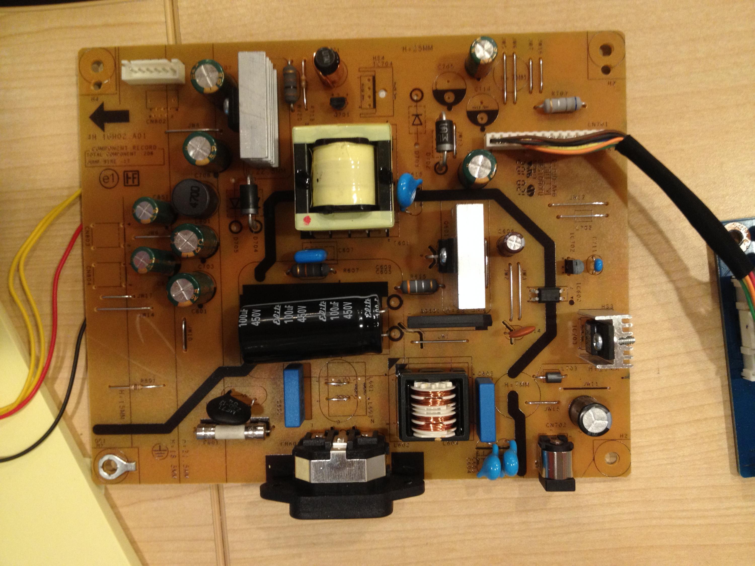

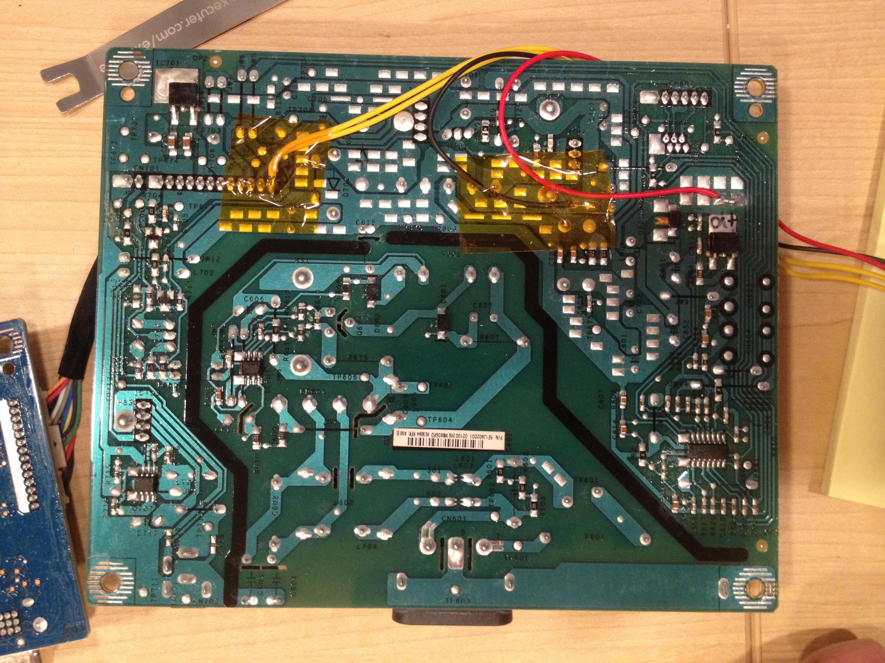

          Re: Power board schematic request: Dell P2412Hb
          Originally posted by budm
          Just let me see good clear pictures of the board especially the power supply board.
          Please see the attached top and bottom side pic of the power supply board.
          The red, black and yellow wires go off to the aftermarket driver board. Red is +30V, black is GND, the two yellow lines (the control lines) are +3.3V on PIN1 of connetor CN701.
          Thanks!
            Let me see the bottom side too. How many wires are on that connectors that goes to the main board? All the pins have wires connected, right? We just have to look for the pin that has less than 1V when monitor is Off, and more than 3vdc when monitor is on.
            Your new LED driver board uses active high signal, right?

              Hi budm -
              Please see my previous post. I revised it to include the top and bottom side pics right after posting the topside.
              Correct, the LED driver board is active high. Let me poke around that 15 pin connector and see if I can come across any other pin that fits the bill.
                What are those two yellow wires for? How did you figure how they are connected to that pin of the connector?
                  The two yellow wires are the active high control signals for the external LED driver board (and looking at the external controller board, they are routed to the same net). It's some cheapo board that I bought off of eBay and it was shipped from Hong Kong. it works, but i wasn't expecting much.
                  I found my mistake. I was off by one pin -- I currently have it soldered to PIN 1. It should be PIN 2 which has coincident timing with the stock LED driver turning on.
                  PIN 1 turns on a few hundred milliseconds faster than PIN2 and is always on after you hit the power button on the monitor. Looks like PIN 2 is the BL_ON signal.
                  Let me go change the wiring and i'll report back.
                    Hmm, I wonder why they need two wires, I would think one will be for on-off, and one for dimming control.
                      Looks to me it's a poorly designed board. The controller is a DF6113. According to the datasheet, there is a DIM function on that controller, but it's not pinned out to the connector.
                      In any case - I moved the two yellow wires over to PIN2. The monitor is working great! I don't need the DIM function in anycase since the replacement kit is a little dimmer than the original LED strip. I'm just happy the free display works
                      Thank you!
