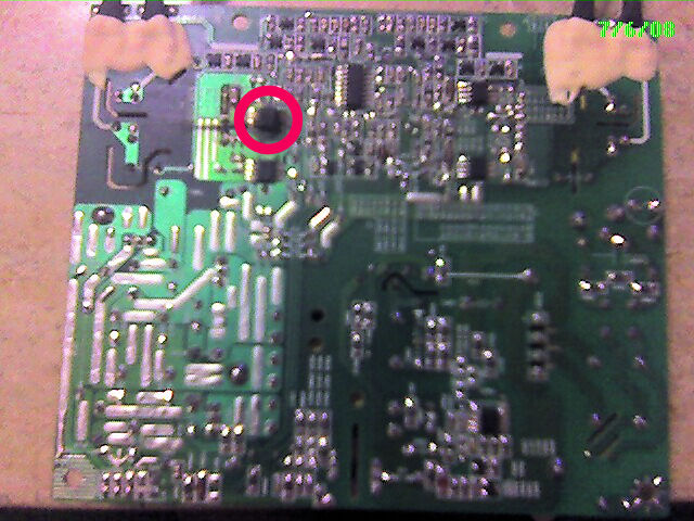

    I am hoping the people in this forum may be able to help me out.
    I have been given a monitor that exhibits the behavior described in this forum, namely it goes black in less than two seconds after being turned on.
    It is a Mag 900P, with a Product ID of LT982s, Manufactured December 2004.
    The capacitors on the Power Supply board look good in this monitor, instead it is a pair of capacitors just to the left of the power connector, on the Display controller which are swollen.
    The catch is this: the Power Supply board I am looking at is not the same as the ones you seem to be describing and which I have seen pictures for in this forum (I have not seen every picture, but I have looked at many), and it looks like someone let the smoke out of one of the chips of the monitor I have.
    I am hoping to be able to identify this chip so I can replace it while I am inside the monitor, anyway.
    Ultimately I would like to know the recommended replacement caps, and where they can be ordered from, for the Display Controller, and if anybody has a Power Supply board like mine can they tell me what it says on the chip/what chip was/what it was for. Basically it looks like the monitor might work without this chip if I replace the two bad caps, but I am wondering if the chip might be why the caps failed, or the reverse.

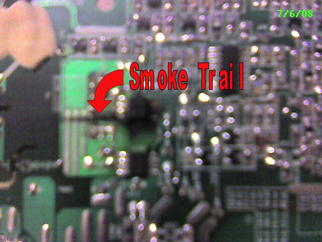

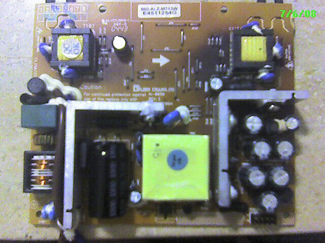

    The three images (attached) show:
    1) The power supply board
    2) The location of the bad chip, on the opposite side of the power board.
    3) A lousy close up where you can sort of see the smoke trail.

        To clarify:
        The bad chip is on the power board.
        The bad caps are on the controller board.
        The pictures I included are only of the power board.

              I have cleaned up the burned chip somewhat and I have discovered that on my board the burned chip and the one next to it are the same. There are two numbers on the Chips: a) 4606, and b) BE4Y1A.
              I hope that helps.
                Re: Mag 900P: blown chip and two bad caps...
                Webpage for the 4606: http://www.aosmd.com/web/products/pr...tnumber=AO4606
                Apparently the recommended replacement is an AO4620.
