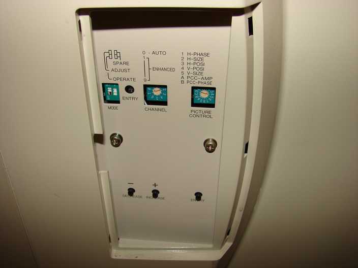

                      I wondered if it had this on it:
                      Jim
                      • Logistics
                        • Apr 2007
                        • 721
                        Re: Mitsubishi HL7965KW-SG twitching!
                        No, it doesn't have that. If you take the cover off there is access to four big plastic adjusters, one had something to do with horizontal and the other vertical, didn't pay attention to the other two. This monitor has the H+V size and movement under a cover in the middle of the face and the brightness and contrast are on the left side of the face along with the power button and degauss button. Oh, and under the cover in the middle it also has the Mode Select for 3 different presets + a preset recall button. Pretty loaded; I bet this was THE HOTNESS when it first came out. lol!
