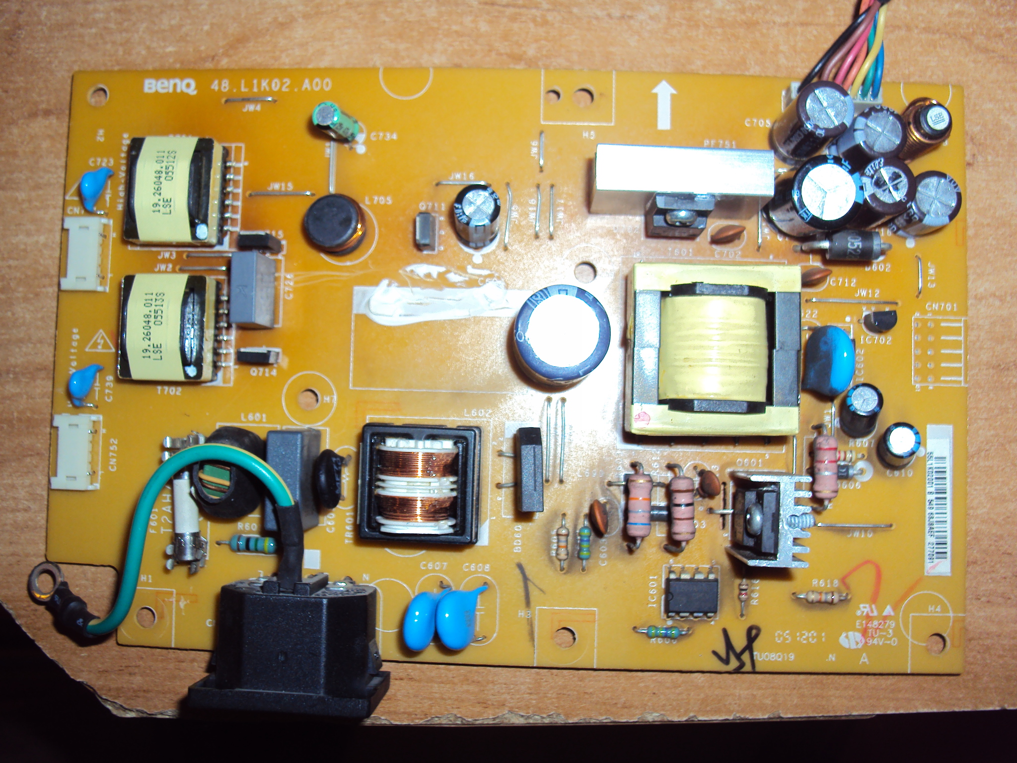

    Just as in title. When power ON is pressed, it turns on, but just to turn off after 4-5 seconds... (no LED, no faint image, no nothing... dead as dodo.)
    It will work OK, after 10 minutes of ON-OFF cycles, though.
    However, when I heat up upper right corner of the board with blow-dryer, it works perfectly every time. (those 5 elcos, inductor and diode)
    Tested caps on ESR,they all look good. Tried replacing (with used ones, but known good), no result. But heating up works as charm.
    Apart from caps, I don't know what else to try.
    (tried resoldering all in that area-no result)
    Thanks in advance for ideas!

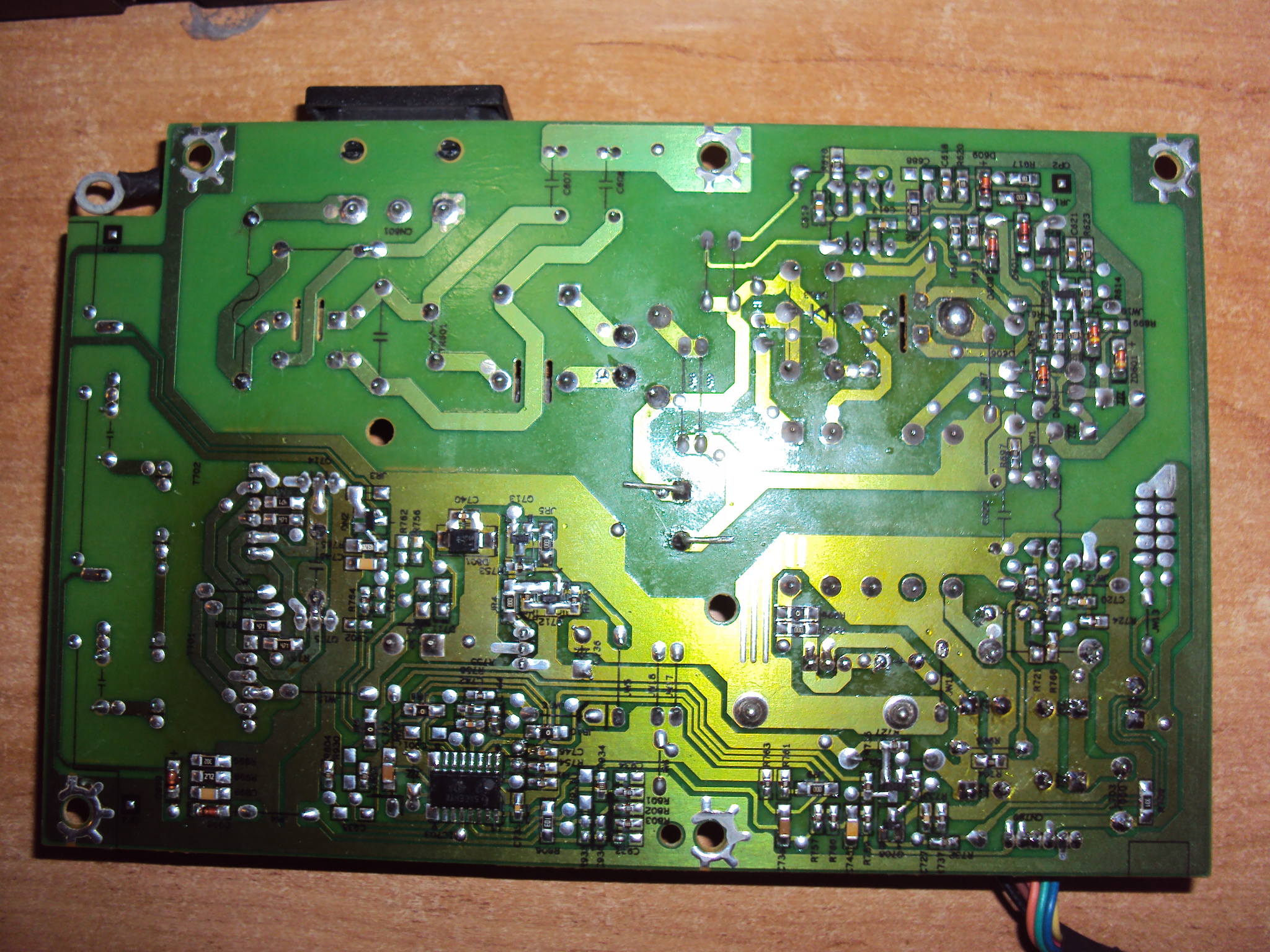

    'But heating up works as charm' heated the top side or the bottom side of the board?
    You have some SMD parts on the bottom side that may be affected by heat.
    BTW, when it does not work, do you lose the Voltage feeding the main board too, or lose the control signals from the main board?
    BTW, did you replace the main filter cap? Isn't standing it up will still fit into the chassis?

      Some solder joints to me dont look so good either on the power devices. Try resoldering them:
        Heating only corner of the board, directly into caps.
        Will check and report tonight or tommorow (GMT +2)
        Replaced it a year ago or so, worked good till now. It fits easily
        ...and will do some more resoldering as sugested.

          Here goes nothing
          Monitor turns on, and shuts down immediately as backlight is lit.
          On the connector to control board I measure 3.4 V, which drops for a second when backlight is lit, and stabilizes back as it shuts down. (I think it drops to 0V, but DMM can't catch it that fast).
          Also, there's a fuse or something (pf 751) above the heatsink (cant be seen on pic) which reads near 0 Ohm, but as backlight turns on jumps to 170 Ohms or so, and back to zero as backlight shuts down.
          Confirmed that heating with hair dryer works, but now picture gets lost, only the LED stays lit. (Was working good before if I heat corner with output caps, now it wont shut down completely but still loses image)
          Resoldered mosfet receey pointed to. Immediately after that, monitor worked flawlessly, for a 10 or 15 mins. Then it all broke down again Tested mosfet -OK.
          Tried to pull output caps out one at a time, no difference in behaviour whatsoever.
