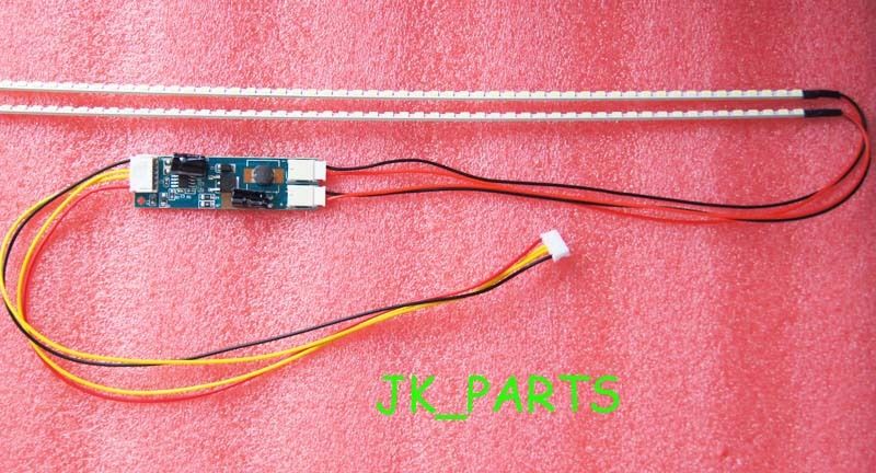

    I picked this up from the recycle center. I figured out it had a bad ccfl by hooking up another back light I had sitting around(my old monitor).
    Obviously replacing the CCFl isn't a very economic choice plus I figured my chances of getting a new one in w/o breaking it were also slim lol!
    I bought one of these Chinese LED retrofit LED kits(pic attached):
    http://www.ebay.com/itm/281750783944
    After waiting the obligatory 30+ days for China Post shipment, I finally installed it. I removed the inverter transformer, mosfet and controller IC plus some capacitors to clear space for the LEDdriverboard.
    It's working,but... I have a few questions:
    1) It's edge lit. I assumed that I should install the new strips into the plastic refflector that the ccfls were in. Of course after the fact I saw a few videos where they eliminated the reflector... Should I have done that?? It seems bright enough I suppose.
    2) DIMMING! The LED driver has a DIM lead but from what I read, there was only a "chance" that it would work. I just left DIM off. My PSU board has TWO DIM connectors. DIM-A and DIM-B.
    The display just doesn't seem right to me and I wonder if the brightness is the cause.
    Any ideas how to get it working? Preferably tied into the system logic,but even if had to install a pot and set it manually that would be okay. There is a hair stuck in the bottom of the screen so I guess I need to disassemble anyway lol! (where's my clean room lmao)
    I plan to have it side-by-side with my new 24" but until then I can't compare the displays together. However I am sure that it can be better quality.
    Thanks!

      i have done a bunch of these, you can search some older threads of it.
      it's best to use the reflector as a mounting frame, btw, just make sure you fix the strips in straight so they dont point away from the defuser!
      as for dimming, you need to start with the part number of the original ccfl controller chip so we know how it dimmed.
      also, the led's are pure white, but worn ccfl's have a pink tint - so you may want to play with the colour-temperature controls.

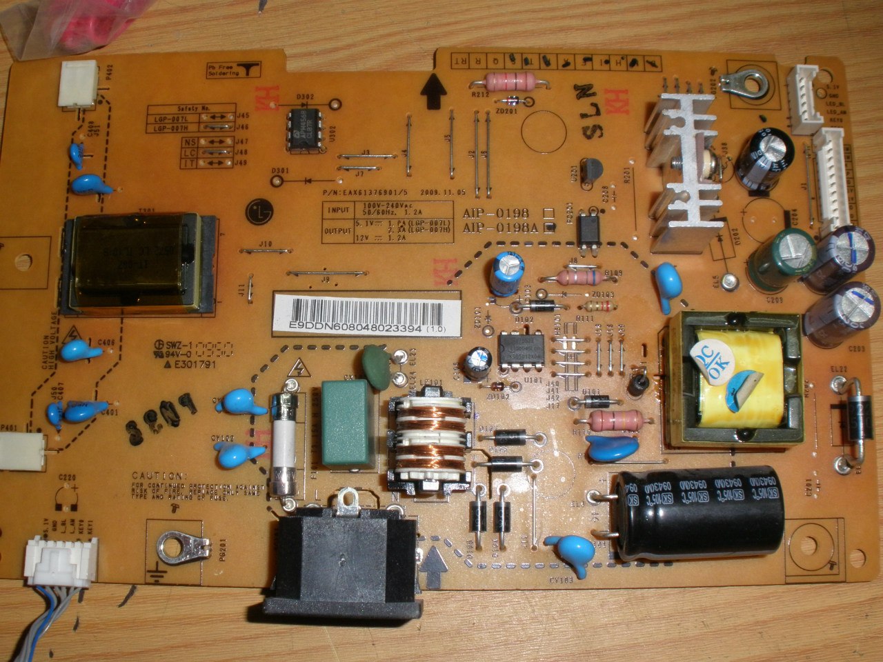

            ReeceyBurger123, thanks for the comments! Unfortunately, I did NOT mount them to the metal frame. I put them inside the plastic j-channel shape reflector that the ccfl was in. I left them running for ~10 minutes and checked heat and it wasn't bad so I rolled with it. Plus I already had hot-glued them in so... lol!
            Sorry that pic isn't my actual board. The caps are original in it so I'll leave them for now.
            I did remove the inverter circuit and mounted the led driver in its place.

                      those led strips dont get hot.
                      https://www.badcaps.net/forum/showthread.php?t=45465
