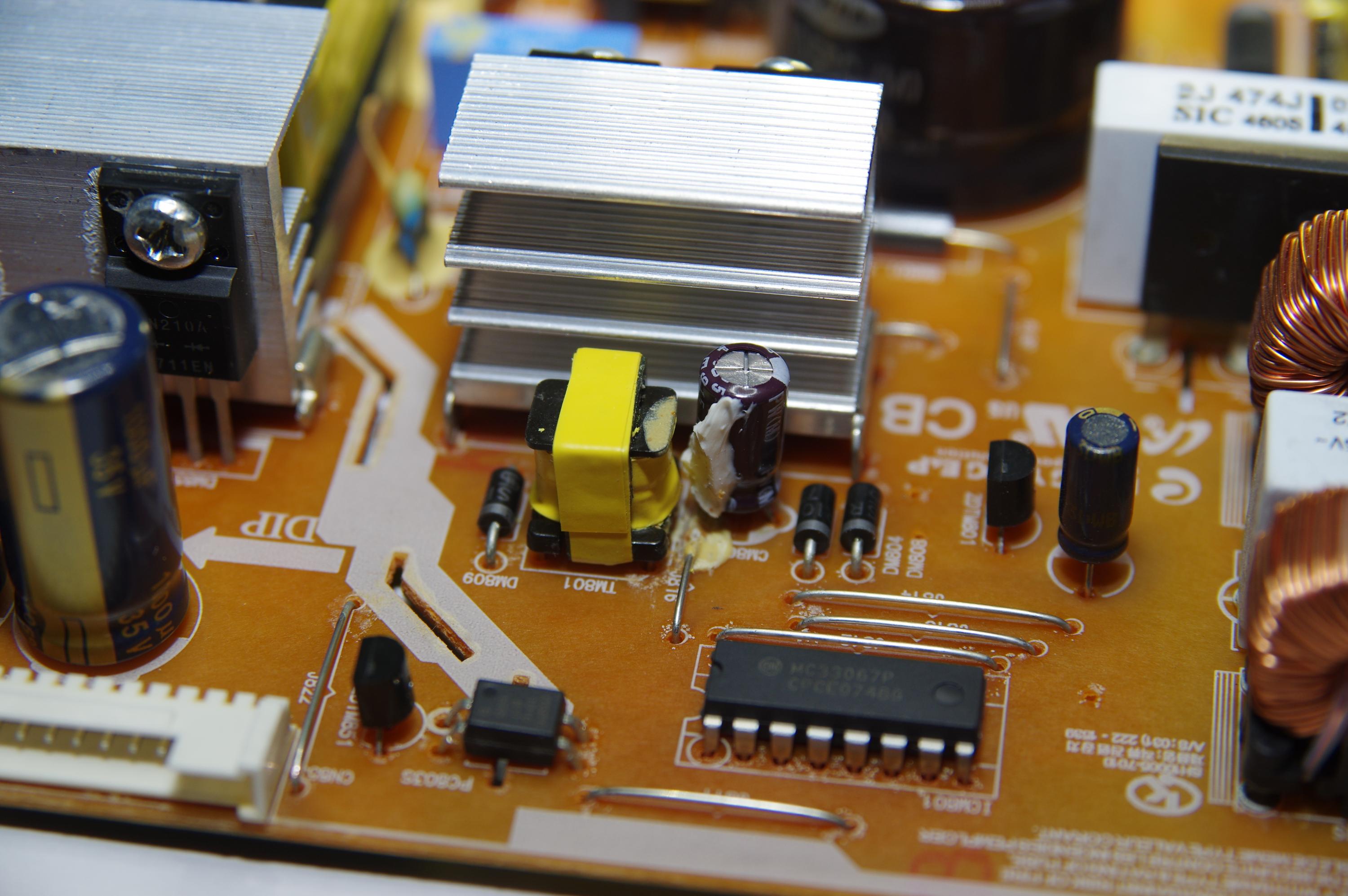

      Re: Samsung 2493HM power board NO 24v to inverter
      Thanks momaka, that looks like a good approach.
      Unfortunately I found TM801 to be open on the side where the glue is. I desoldered to look at it from the bottom. Bad news: the wire from the middle pin is covered in black burned glue and no more sign of the wire. This might have happened after removing some glue to remove the cap it was glued to. Or this transformer has been overloaded due to the wrong value cap. Can some explain what the role of this transformer is and if it is related to the standby voltage of the 22uF cap? If not, it's probably a coincidence this transformer toasted after recapping and touching the glue.
      Bottom line, I don't think this transformer is repairable. I will try to clean it with alcohol to see what is left of the wire.
      And I would think this PSU cannot work without this transformer.
      And a replacement transformer is hard to get I read somewhere else since it most likely is custom made for this board.
      Any suggestions? I really appreciate all the help here!
            Just cleaned the transformer. The wire is gone, like evaporated. Trying to open the transformer to unwind one round seems like a destructive action. It's glued together and I will break the magnet when opening. I guess I run out of luck and need to find a replacement board or monitor.
            Unless there is a way to replace this transformer with a different one that has similar specs. I can determine the winding count "relations" per leads in the working PSU.
            Any last ideas how to overcome this problem are very welcome.

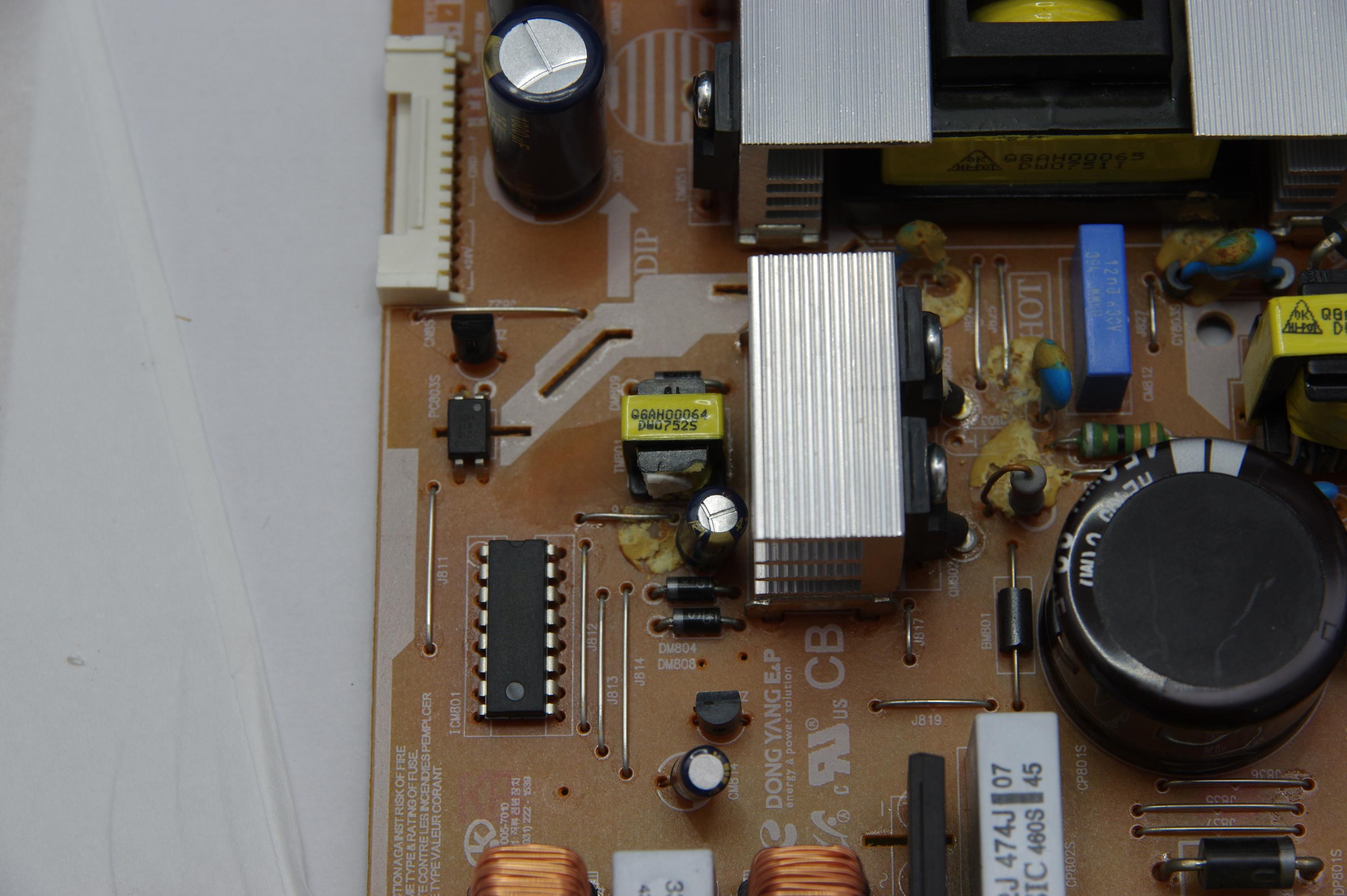

                I searched for the part-number but they are not sold anywhere. I just find troubleshooting forums on this monitor and pictures.
                I thought I could take the risk and I installed the good transformer (which I bottom-cleaned thoroughly while it was out!) in the faulty PSU and everything works as it should now.
                Conclusion: Glue killed the TM801 transformer and without the TM801 no 5.3VDC and 24VDC.
                Once more it is clear that cleaning the glue off is worth it, preventing damage which is very difficult to repair like this transformer.
                I find it hard to understand why the glue is there anyways? Especially since it is spilled generously over metal parts carrying high voltage and high frequency signals.
                My question to the people in this forum with a dead 2493HM (or 245B) but operational TM801 transformer, I'm am very glad taking it over from you! Just the TM801... I will reward you generously!
                Or anyone with a bit of understanding on these kind of transformers to help me figure out what kind of make and type could be a replacement.

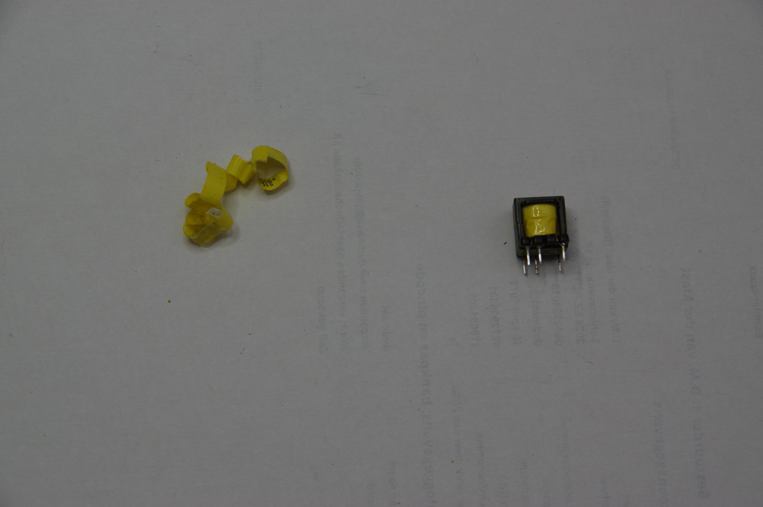

                      #30
                      QGAH00064 / DW07515
                      I will post a picture later.

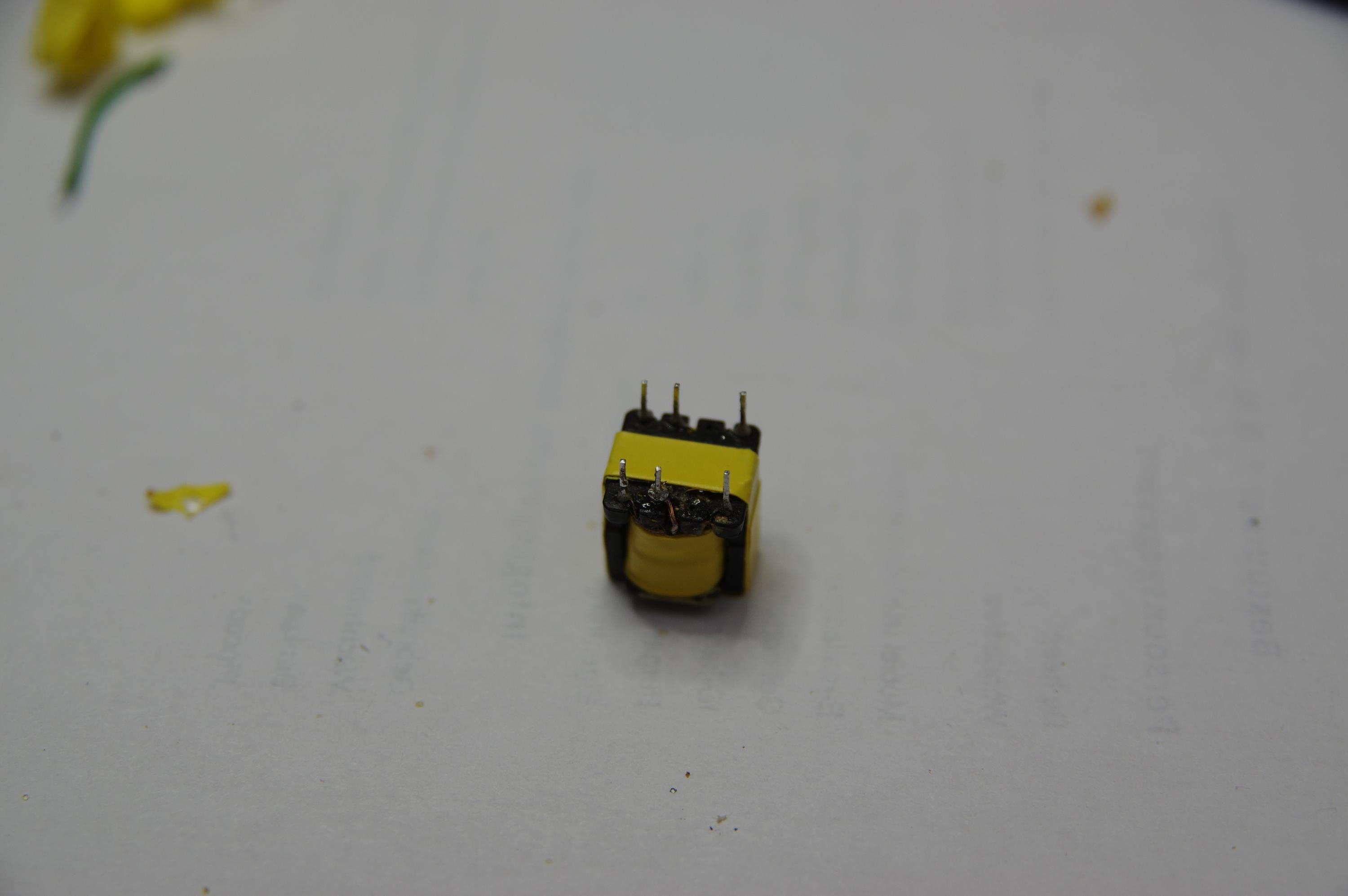

                        #31
                        See the attached picture for the working TM801 transformer (taken from a different fully operational 2493HM PSU board), next to the heatsink, installed in the "faulty" PSU board being subject in this thread.
                        The board is now working properly. Hope to find another transformer or alike to get the known working other board back to life so I have both monitors running again.
                        So please! If you have one in a dead PSU board or just broke/damaged 2493HM or 245B you can make me a very happy man by offering this small part to me

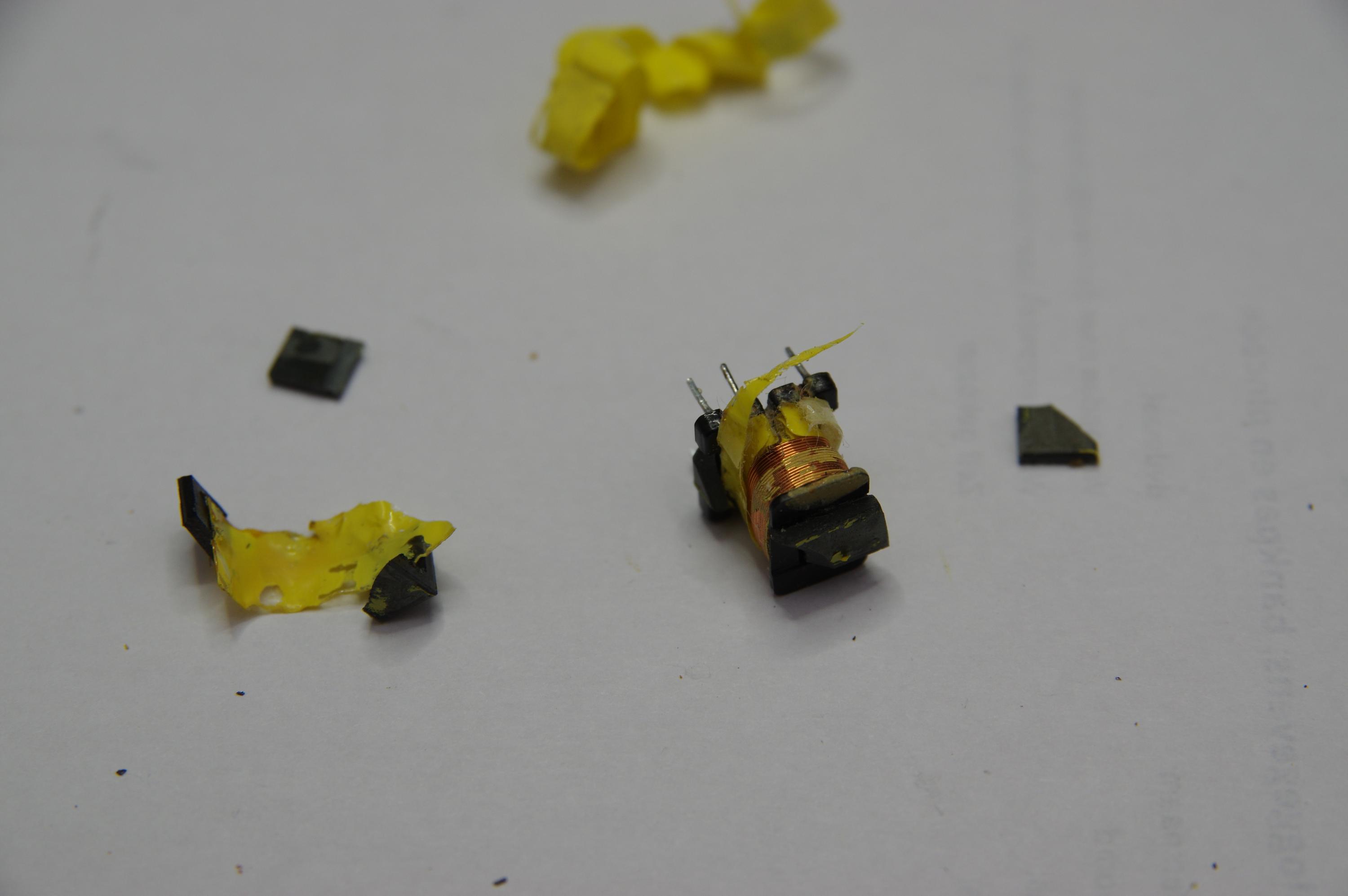

                          Well, look at it this way: it's already broken. So might as well try and fix it, no?
                          The way to take these apart would be to first unwind and remove the yellow tape on top (the one with the part number). Next, try to separate the two ferrite core halfs of the transformer. They are usually glued together so you will have to pry them apart. If you break them, don't worry - in that case, just keep all of the pieces from the core (if they are all glued back together later on when the transformer is fixed, its core properties will not change too much). Finally, take out the bobbin/plastic separator with the windings. Make sure to label how each wire is connected (either on a piece of paper or on the transformer) and show us some pictures too. Depending on how badly the wire is burned, you may have to rewind just a section of the transformer or the entire thing. But it is not that big of a deal. You will just need to find similarly-sized wire. A little thicker than the original is okay if you can make it fit. Thinner is okay too, but you may have to wind it in double-strands.

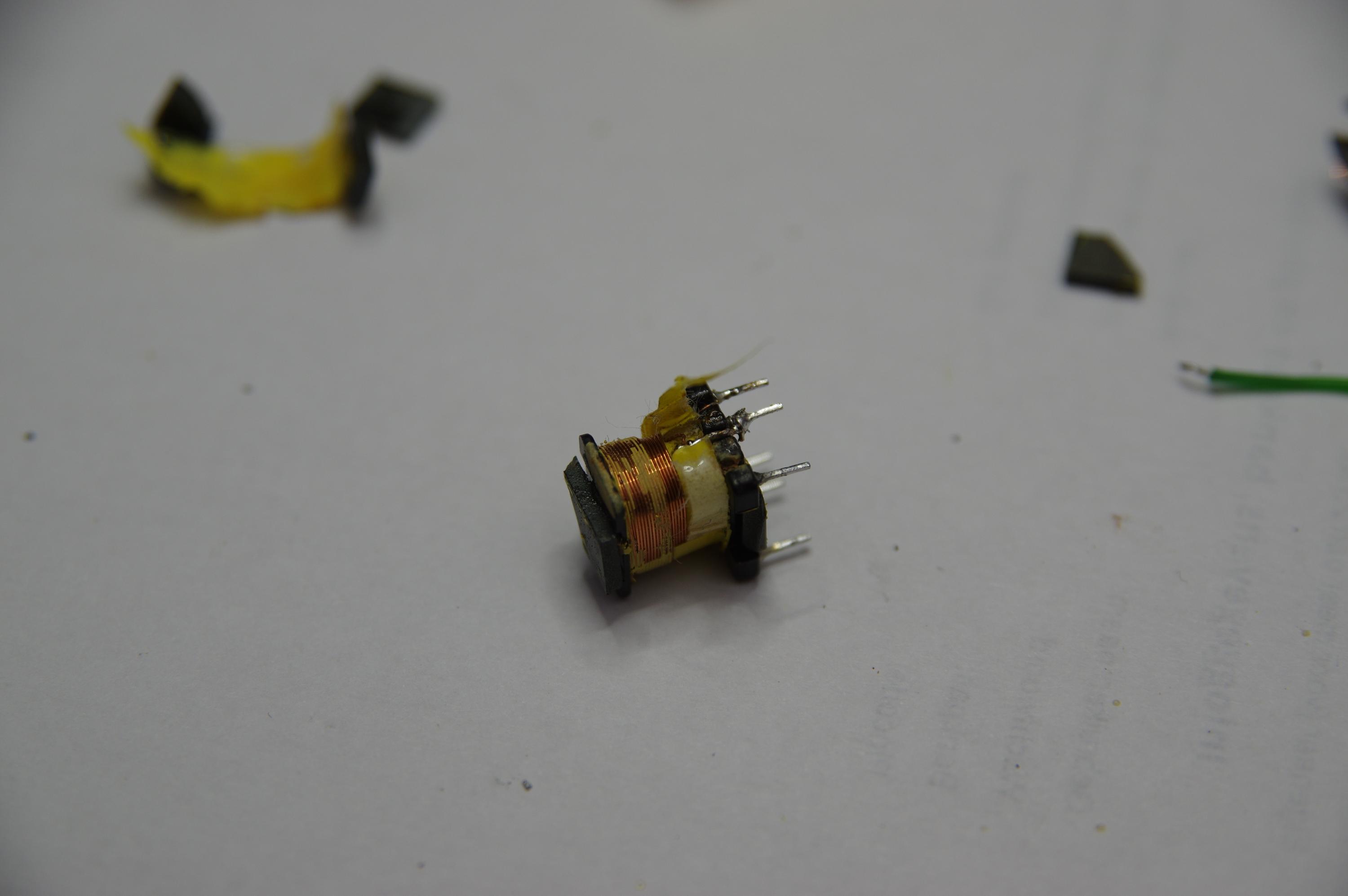

                                #35
                                Amazing! The transformer repair was a success!
                                I opened the transformer breaking the magnet in 5 pieces, found the burned wire, extended it with a small thin wire and connected it to the pin, firmly taped it back in place and glued the magnet into one piece using super glue. Finished it with re-taping the magnet. See pictures. Result: a working 2493HM again!
                                It can be done . I needed about an hour for this repair.
                                Thanks all for the tips and support.
