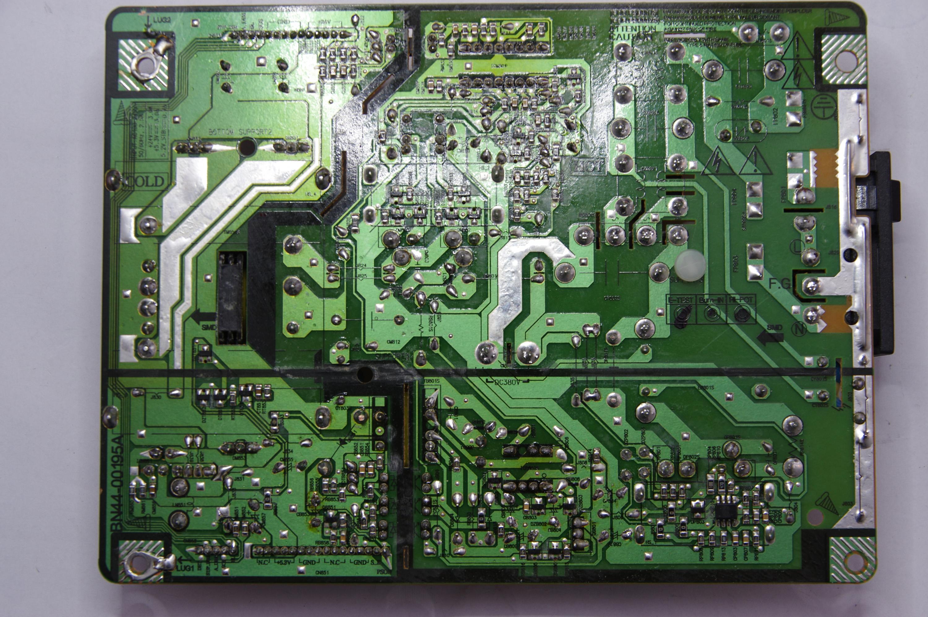

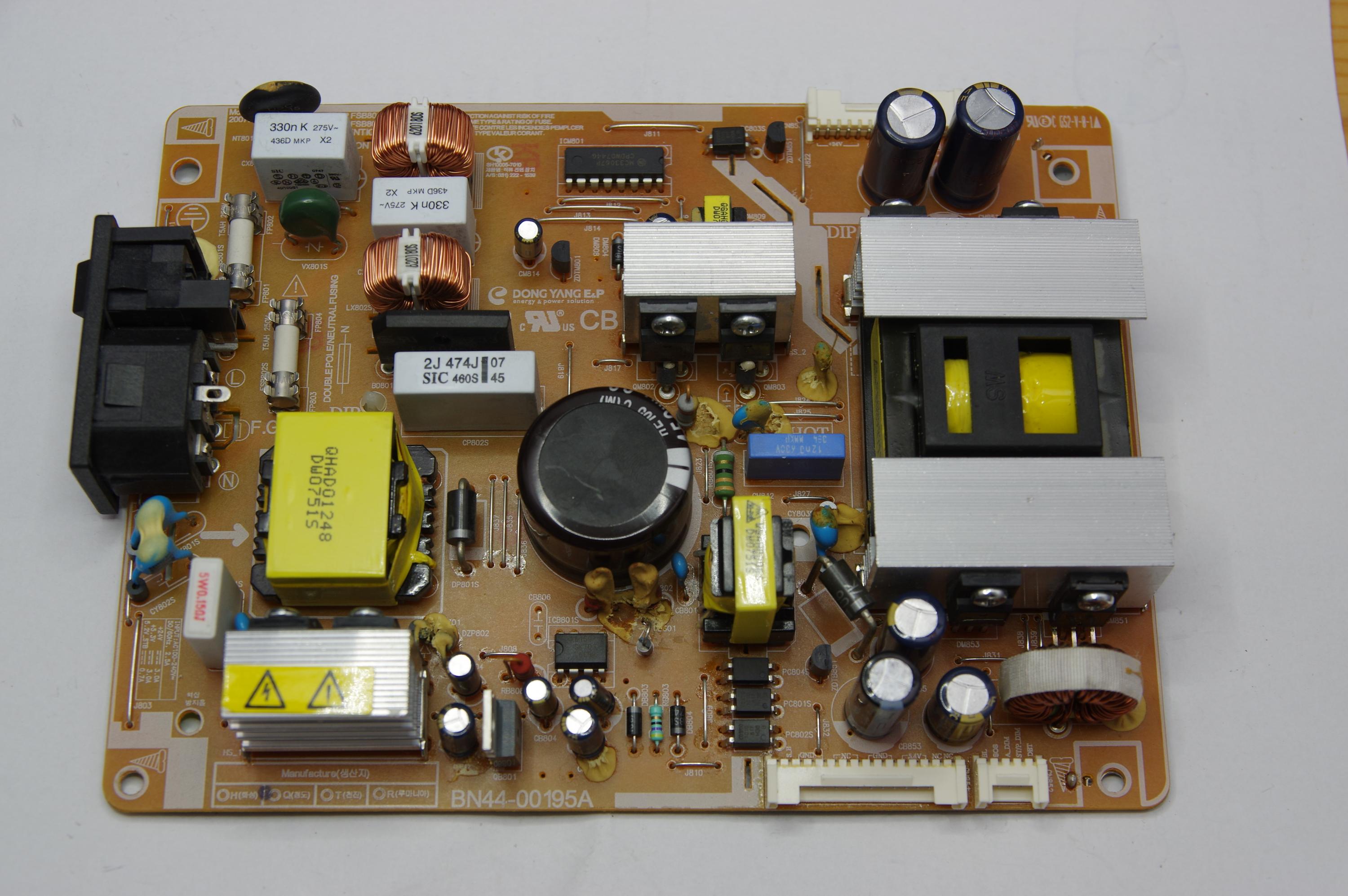

    Hi, this is my first post requesting for some help fixing a Samsung 2493HM power supply.
    This is the third monitor I try to fix by replacing the electrolyte caps with decent Panasonic one. All of them failed with a black screen while the blue power led in on. The first two were fixed well and are still in business after about six months now.
    The third one is currently on my bench and after I thought to have it fixed by replacing all elco's it proved not to be by showing a black screen again after about three hours operation time.
    Troubleshooting learned I had made a mistake. I put in a 2.2 uF 50v cap where I should have put a 22uF cap. This cap is parallel to a zener diode if I look at the diagram found in another thread. On the PCB it is numbered CB804. In the diagram it is CB802. The diagram is slightly different which makes sense as the PCB is numbered different BN44-00195A.
    https://cdn.badcaps-static.com/pdfs/...f8a620fd8c.pdf
    My knowledge on the power circuitry is not good enough to understand what this mistake may have caused further in the line. But replacing it with the correct value cap did not bring back the backlight. Measuring the 24V output indicates it does not provide it.
    I have tested the panel with the power board of one of the working monitor and all works well. The problem is isolated to the power PCB.
    Anyone knows what the first and next steps would be to troubleshoot and fix this?

      Thanks budm for the quick reply.
      I have not yet measured the 5.2V standby. Will test that tomorrow when I have some time... Can I test that with the board isolated or do the Controller PCB and inverter PCB to be connected? And where to best test this voltage?
      The blue led works BTW. And the buttons seem to work since my laptop responds to the source selection function. But since there is no display visible, also nothing with a bright flashlight I'm not able to confirm this.
      I attached two pictures. Please let me know if you need some close-ups.
      Thanks again! highly appreciate your help!

          For the standby voltage - YES, you can test the power board without anything else connected to it.
          As for where: find connector CN851. You can see its pins on the lower left side of this picture you posted:
          https://www.badcaps.net/forum/attach...7&d=1455401164
          I believe that connector is for a wire harness that goes to the logic/video board. On connector CN851, there is a pin labeled "S_E", right next to pin "PS_ON" in the right corner of the connector (I'm using the same picture above as reference).
          Let us know what voltage you see on that pin with respect to ground (pins labeled "GND").

            If you do have PS-ON signal (>2VDC) when power switch is activated, then you need to find out if the PFC Voltage Booster is working or not, you should have close to 400VDC between the two legs of the main filter cap.
            BTW, I can still see some of the parts are still covered with glue, especially the little blue disc snubber cap next to QM803, also CY803, etc.
            If the PFC is OK but still no 12V/24V then you need to check the resistor (0.22 Ohm) that is standing up next MOSFET QM802 and the capacitance of the blue rectangular cap with '12nJ 630V' printed on top.

                      After reading back and trying to do some logic reasoning I have a question.
                      1. With the wrong value capacitor installed (2.2uF instead of 22uF) the monitor had worked for about three hours. So the standby voltage should have been working. Despite it shouldn't work according to what budm said.
                      2. Could this wrong value cause extra stress on other components like the other new capacitors installed? Or any other component. Although I cannot see any component has died/been damaged, we now can tell for sure the PFC does not work while it worked before, even with a wrong value cap in that area.
                      3. Is the PFC the heatsinked transistor and diode on the bottom left (see picture)? I try to understand the layout but this seems to be too high of knowledge for me .
                      Cheers and thanks for the help!

                          That TDA4863g is the PFC IC you are looking for.

                                  Bottom right 8-pin SMD is the PFC IC.

                                      Thanks, found the ic! And three steps further:
                                      1. More glue is removed, though not all, but visually all legs are now glueless.
                                      2. Measured the two standing 100KOhm resistors next to the main filter cap which are covered in glue and cannot be cleaned without breaking them. One measures correct at 100KOhm. The other (next to the transformer) is around 71KOhm. Compared this with the working PSU and the values are both 100 KOhm. How big of a problem is this? I could replace these although I need to order them.
                                      3. measured VCC (pin 8) on de PFC chip against pin 6 (ground): 14.8VDC. The working PSU measures the same.
                                      Where does this bring us? I hope you can help me look further...
