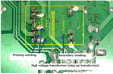

                                      Re: Help - how to test an inverter transformer
                                      Originally posted by stj
                                      check both.
                                      the primary is the one the power goes into and usually looks smaller if you can see it.
                                      the secondary is the output to the tube(s)
                                      most problems are on the secondary side,
                                      but it's worth checking there is no conection between the primary and secondary.
                                      Thanks for your reply. I came through the attached... is that the way that the windings need to be checked?
                                      Thanks,
                                      Matt
                                        How about the pictures of the top side of the board? and also the whole board both sides.
                                        What is the make and model of this product you are working on? The more information we get the more we can help.
                                        It looks to be correct as you have marked for the High Voltage secondary winding.
