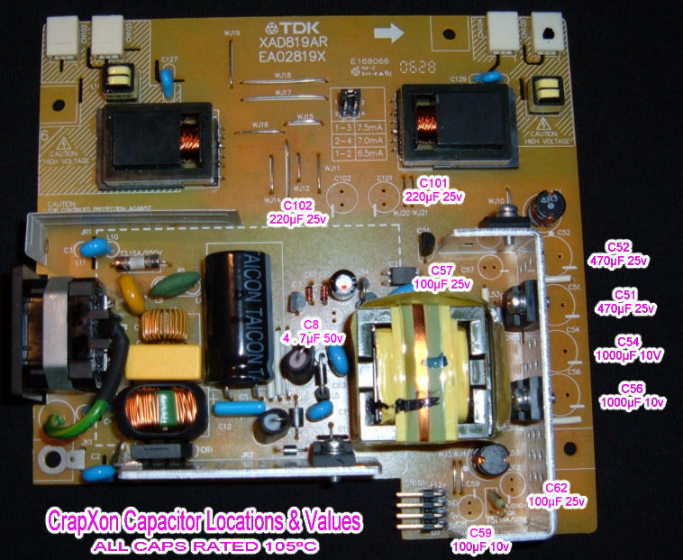

      Hi! I found this post through google.
      Yesterday I pulled a Princeton monitor out of a dumpster and decided that I would try to nurse it back to health. When I plugged it into the wall, it made a steady a clicking noise (came from the two small internal speakers), and when the monitor was unplugged, the clicking noise persisted but diminished in frequency. The monitor never actually powered on. This led me to believe that it was a power supply problem.
      I pulled the whole thing apart and pulled the power supply PCB out. The model number matches the one mentioned above in this post (I'm sure its the same monitor). The 6 large capacitors on the board do appear to be "bulging", i.e. they are not flat on top. I think I will replace them and hope for the best.
      My question is, should the clicking sound indicate a different problem? I don't want to fix the wrong problem.
      Thanks!

        Re: Confused cap values during removal- best fix?
        just recap it.should be fine then.
          clicking noise from psu can mean it's overloaded, ie short-circuit on one of the outputs, but clicking on speaker shouldn't be that, so yeah, try recap.
            It could be that the power supply is cycling on and off rapidly due to the bad caps and the onboard speaker amplifier is outputting popping noises to the speakers. Since its supply voltage is being given to it and taken away when the PSU shuts down.
            Similar to the noise heard when you turn an amplifier on or off.
            Just replace the caps you'd be suprised how many times a recap will be all the monitor needs.
              Recapped, monitor works perfectly. So essentially, since the monitor was dumpstered, I basically paid seven dollars for it. Fuck yeah!

                  • DannyBoodmannTDLemon1900
                    • Jan 2009
                    • 3
                    #29
                    Just thought I'd add some details and tie it to a monitor model so perhaps others can find this page via a forum search, Google, etc. This was the only legitimate Google result I found concerning this TDK board. Thanks to the op and those that have added to this thread.
                    I discovered the same TDK XAD819AR \ EA0219X board in a friends Princeton VL1919 that he wanted me to take a crack at fixing. These were sold through Costo about three years ago give or take. Symptoms were a blinking display with a synchronized clicking through the built in laptop style speakers on the back on the case. The backlight would occasionally flash on for a moment.
                    This board is both the power supply and the CCFL inverter. On my board the same four CapXon caps, the 470uF and the 1000uF were bad. Three swollen and the fourth had burst out on the bottom which I hadn't noticed until I dropped it out of the board. The two CapXon 220uF in the center of the board appeared ok, however I did notice that a couple of caps not mentioned in this thread either appeared bad or on the way out. There are another three CapXon inside of the "corral" made by the heatsink [C57-C59-C62], C62 appeared swollen and C59 didn't look "quite right". There is yet another little guy [C8] next to the transformer that looked ok but also made by CapXon.
                    I opted to replace all ten caps on the board made by CapXon (green\gold stripe) and recommend if you tackle the job to do this as well. At this point in the thread you've probably already decided to change out the previously mentioned six caps and there's only another four. As most of us will be already paying $5-7 for shipping for under a pound you might consider tacking on the extra <$2 of caps. Not sure why I did, but I left the only non-CapXon radial cap [next to C8] on the board. I looked it up later but I had already placed my order so it stayed on the board. If I recall it was a 47uF 50V, it can be seen but is not marked on the photo.
                    A word of caution, at least six of the caps have either a surface mount cap or resistor soldered near their leads on the solder side of the board. A couple of them are very close. When you're (de)soldering be careful you don't splash a solder short or knock one of those little bad boys off. I recommend doing one leg of a cap and then moving to another cap, allowing that part of the board (and the smc) to cool before coming back for the second leg. I managed to do just fine with my hugely tipped RS squeeze-bulb desoldering iron. Personally, I wouldn't try wicking those, but that's me.
                    The cathode(-) side of the caps are marked on the board with a line through the circle's edge and have a square solder pad on the solder side of the board.
                    The OEM caps are rated to 105ºC, be certain to check this value if your replacement choice is categorized as "general purpose" as many are only rated to 85ºC.
                    I know most here probably don't need those last bits of advice, but some reading this will be n00bs as we all once were. n00bs are advised to read the faqs and other stickys in the forum, 99% of your questions will be answered.
                    I would have shot the photo with the OEM caps in place but I had to desolder three of them because I couldn't see their specs when they were onboard. When one's soldering and on a roll ...
                    Here are the values along with the current (01\2009) Panasonic FM Series part numbers ....
                    C101 220uf 25v 105ºC - EEU-FM1E221
                    C102 220uf 25v 105ºC - EEU-FM1E221
                    C51 470uf 25v 105ºC - EEU-FM1E471
                    C52 470uF 25v 105ºC - EEU-FM1E471
                    C54 1000uf 10v 105ºC - EEU-FM1A102
                    C56 1000uF 10v 105ºC - EEU-FM1A102
                    C8 4.7uF 50v 105ºC - EEU-FC1H4R7 <-- FC Series - FM n/a
                    C57 100uF 25v 105ºC - EEU-FM1E101
                    C59 100uf 10v 105ºC - EEU-FM1A101
                    C62 100uF 25v 105ºC - EEU-FM1E101
