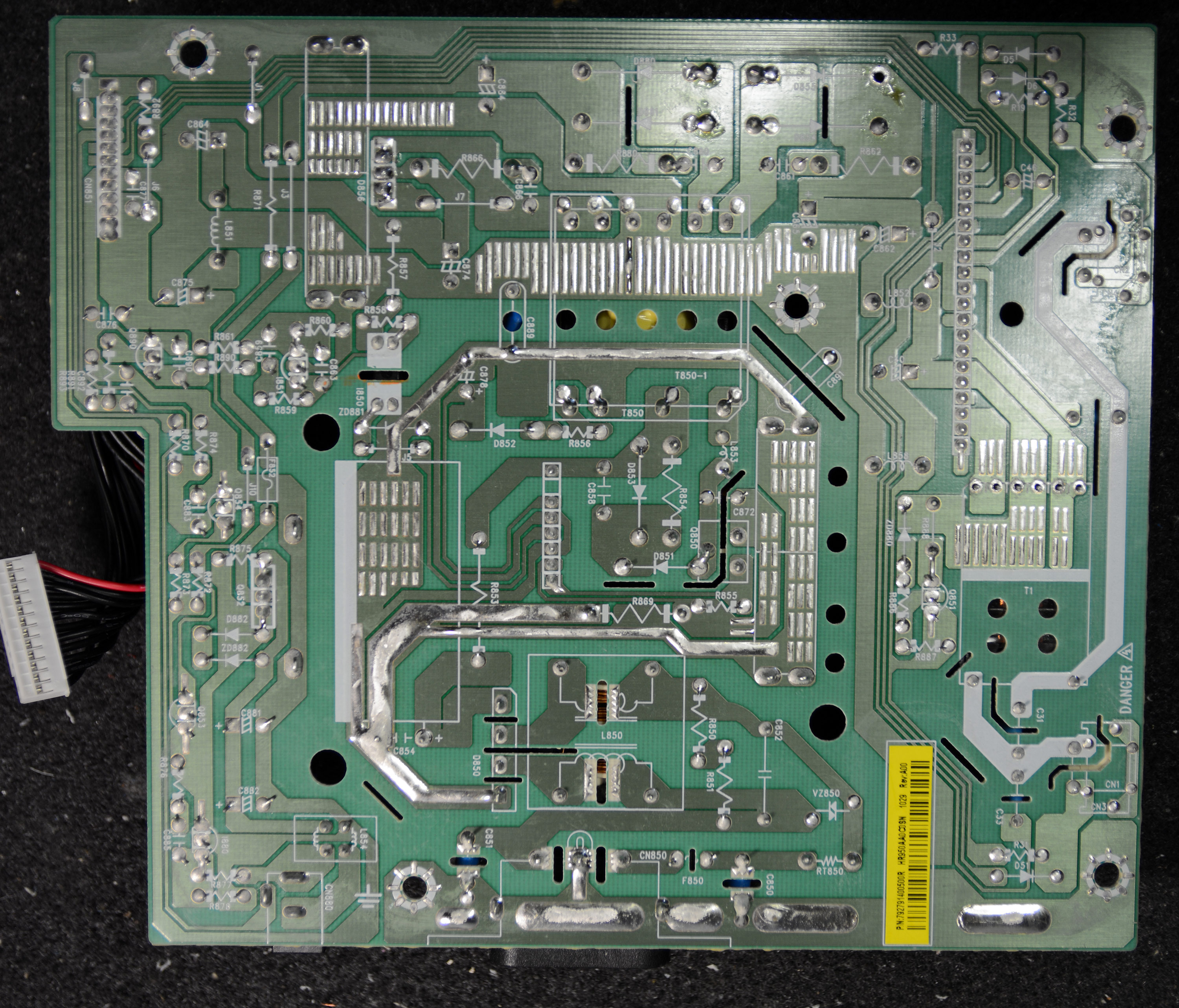

DELL P2210 - SMPS +5V reads ~+3.5V

      Re: DELL P2210 - SMPS +5V reads ~+3.5V
      Originally posted by fzabkar
      ISTM that the dual MOSFET at U2 (P6006HVG) could be shorted. I would resolder all the pins of transformer T1 and check for shorts on the HV side.
      I think you're right... again!
      The dual MOSFET seems shorted. I will try to replace it and see.
      Spare parts are on the go. I will write back as soon as I receive them.

              Little update. First display is ok but the second one keeps burning dual Mosfet. Inverter and motherboards seems to work ok for about 5 seconds but after that Mosfet is shorted again and power led goes off.
                Interestigly I have one dead PSU here also.
                D855 was shorted, changed but still no power. I think I got also low 5v.
                  Update, all sec. voltages are low at fluctuating 1.5v. It looks like there is some short somewhere...

                    #29
                    Check for shorts to ground across each output rail. Maybe a bad diode on another rail. Capacitors fail shorted too, sometimes. Test without the logic board etc connected to be sure it's the PSU and not the load.
                    Could also be bad primary side controller circuit is power cycling from bad Vcc capacitor or diode, or even bad controller.
                    Can you upload photos? Doesn't seem to be any in this thread so far.
                    -David VanHorn

                      #30
                      All diodes check fine. There are no shorts on voltage outputs on +5v, +12v or +16v.
                      The diode that was shorted were on the +16v output.
                      U2 Dual mosfet is also fine.
                      There is audible clicking noise coming from somewhere on the board.
                      On second reading there are ~ 3.5v on the 5v rail, 9.5v on 12v rail and 12.5v on 16v rail.

                        #31
                        The clicking is probably from the main transformer as the primary-side controller starts up, shuts down, and starts up over and over.
                        Could be the controller supply, check C878, D852, R856

                          #32
                          C878 have fluctuating voltage 12~14v
                          D852 and R856 are ok.

                            #33
                            Check the voltage on the main filter capacitor and ensure it stays steady. If it were bad you may get this problem.
                            Could be a feedback issue. Try checking\changing I850 and I851.
                            But I wonder if something on the 12v or 16v rails is still bad, leaky perhaps, or failing under load.
                            You could try lifting one leg of D855, D880, D881 and also R862 and R880 to disconnect those rails and see if that gives you a stable 5v.

                                #35
                                Main filter capacitor has around 310v on it ( it's measured 86uF ).
                                I have tryed to resolder diodes and resistors on 12v and 16v rails but it's still the same.
                                U850 has problem starting, I will try changing optocoupler and TL431 on feedback.

                                      #38
                                      Looking again at the schematic, ZD881 could cause the problem if it were leaky\shorted.
                                      Another idea might be the current sense resistor, R869, if it has increased in value.
                                      But, last time I had a PSU fault like this I checked everything and eventually found the controller was bad.
