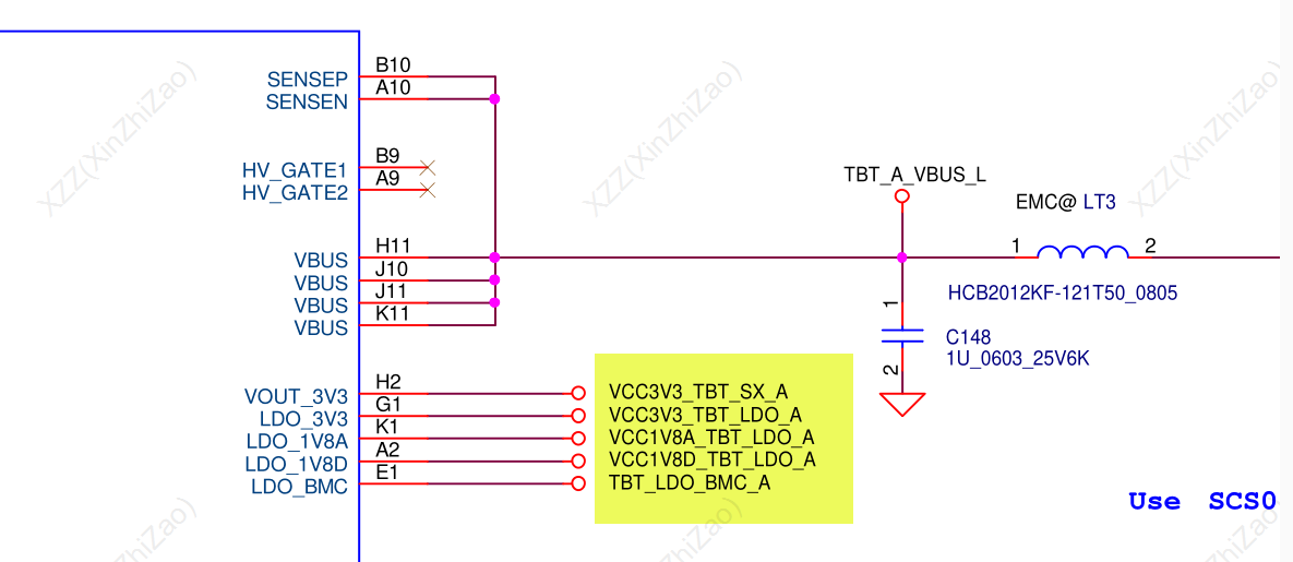

                              Confirm that the PD firmware flash rom @ UT6 is being powered. Measure the voltage to ground on pin # 8 = VCC3V3_TBT_LDO_C.

                                  Confirm if you have each of the following power rails. One will be the same as what you have measured. TI is the same company that builds the CD321x series found on the macbooks so anticipating the same logic to troubleshoot will be applicable.
                                  Each goes to a nearby cap so may be easier to probe the capacitor (with caution).
                                  Click image for larger version  Name:	power_rails.png Views:	0 Size:	85.5 KB ID:	3341036

                                    Hi mon2,
                                    I took the following measurements from U19, 20 and U21.
                                    U19
                                    H2: at C141 reads 0V
                                    G1: at C142 reads 3.32V
                                    K1: at CT94 reads 1.780V
                                    A2: at CT95 reads 1.785V
                                    E1: at CT96 reads 0V
                                    U20
                                    H2: at C154 reads 0V
                                    G1: at C155 reads 3.30V
                                    K1: at CT97 reads 1.795V
                                    A2: at CT98 reads 1.783V
                                    E1: at CT99 reads 0V
                                    U21
                                    H2: at C167 reads 0V
                                    G1: at C168 reads 3.32V
                                    K1: at CT100 reads 1.786V
                                    A2: at CT101 reads 1.783V
                                    E1: at CT102 reads 0V
                                    Thank you

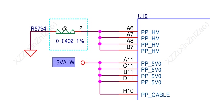

                                      Confirm if you have the voltage on +5VALW.

                                        A11, C11, B11, D11 and H10 all reads 0V
