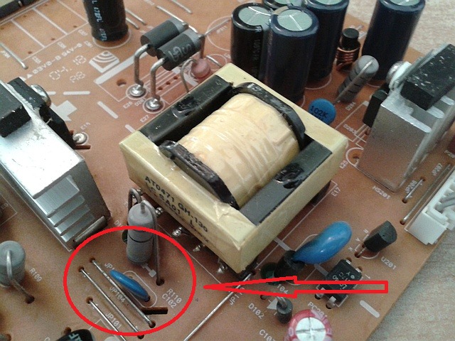

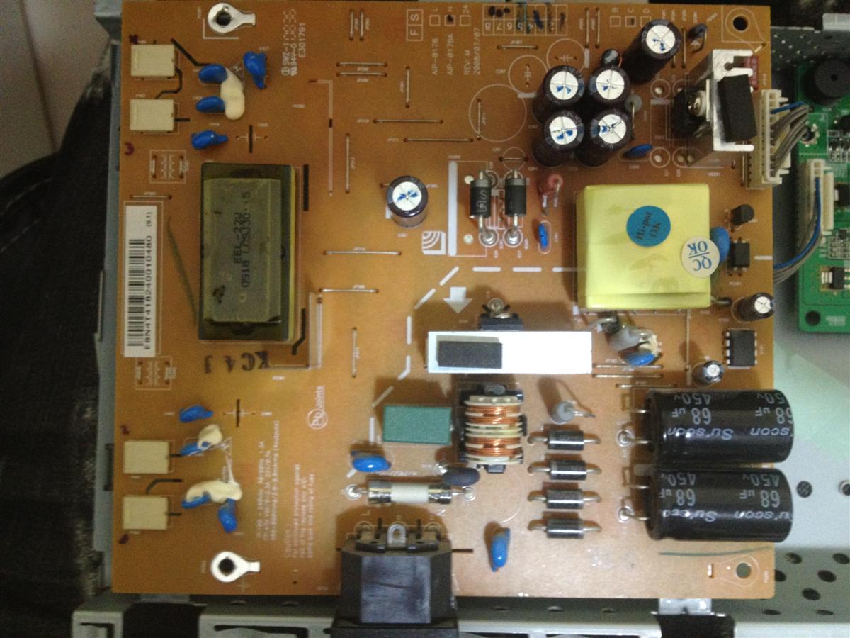

    So... First, I am not an electronic enthusiast, I had few lessons in school several years ago but nothing really technical. No surprise if what I ask in this topic can be easy stuff for you
    My previous monitor (LG W2252TQ-PF, an 21" LCD monitor without LEDs @ 1600*1050 / 16/10) died one year and half ago. Before dying and for a good week, he produced an high-pitch noise at specific situations (in sleep mode, even offline but power connected, and between resolution changes) and so I expected it to stop working, and he did. Unable to start it again, I stocked it somewhere and replaced it by a new one.
    I wanted to repair it someday mostly by curiosity, and yesterday I finally got time and motivation to repair this old guy. I opened it, saw two bad capacitors but decided to replace nearly all of them (8, all Su'scon). Of course, I respected polarity/capacity, security and bought some decent replacements (Panasonic for the most part). The only ones I didn't replace was the two 68µf @ 450v but they didn't look bad.
    And he works again ! The image is fine in all areas, I don't see any problems BUT... he still produces the high-pitch noise he did before dying, in the same situations than before. Obviously, this sound is not coming from the capacitors or maybe from the 68µf ones I didn't replace ?
    I can't pinpoint the exact location of the sound, the only thing I am sure is that it come from the power board, but as I don't want to get an accidental hurtful discharge, I prefer to avoid getting too close of it while it is working, now that he got some power in nearly two years
    So I want to know your opinion of it, or if there is a way to know what can produce this damn sound offline.
    (I attached an image of the power board. It is not my image, I found it in the web but it is exactly the same board. If needed, I can produce some...)
    Cordialy,

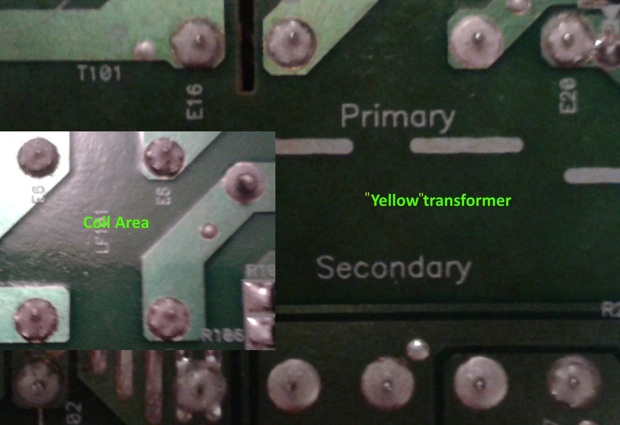

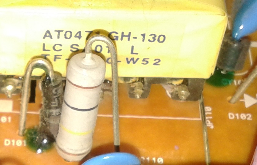

          Just to be sure, I want to ask two informations from everyone :
          - In the first image I attach in this post, I guess that the curiously shaped soldering (not conique) must be replaced ? I can see this shape in multiple location, it will be a lot of work...
          - I think that the green (and solid) goo at D102 and D104 is some kind of glue in the second image, but can someone confirm ?
            • 30979
            Re: LG W2252TQ-PF, high-pitch noise remaining after repair
            the star shape on the soldering is fine - it's a rivet under the solder to make the board stronger.
            the green is threadlock used to stop the ferite beads vibrating

              I tried redo some of the soldering, and I even replaced the two 450v 68uF as the sound seemed come from there, but the high-pitch noise is still here.
              That means that it is probably the transformer at location T101, the yellow-plastic cube at the middle-right of the first image. It is written AT0471 / LC SA01 L / TF-2820-W52.
              Unfortunately, I failed to find a location to buy a new one... Some people said that some glue can fix this problem, but I don't see where I should apply it (is this the datasheet ? it is visually similar and it is written TF-2820, but mine is partially enclosed). Build a brand new one is probably possible but not for me, I don't have the tools nor the time and competences.
              I guess that my best course of action is probably to buy an old powerboard on eBay from China, at least if I want to remain costly-efficient, or just don't care and unplug the cable when not needed. But for this last option, I want to know if this sound is just a sound or if it means serious problems at long term.

                I think I know what is generating this high-pitch noise : the blue cap at location C102 (cf screenshot). It is a 2200 pf 1kV capacitor. It is in the area where the sound come from and each time I touch it with a screwdriver (with caution), the sound change a bit. It is the only one who do that.
                As it is a high voltage stuff, I don't have any way to take some measurements, and I am not motivated to do that anyway, too dangerous.
                I tried to replace it by a new one after waiting some days that the board discharge itself... but the new one generate the sound too.
                So I am stuck. I wonder if I just have to sink it into some silicon, or maybe an other way ?

                      Sorry for the VERY LATE response, computer crashed, bookmarks lost, etc. and life Now I am determined to finish it because if I failed, it goes into the recycle bin in a month at maximum. I need a second monitor asap as the one I had is dead.
                      So, hum...
                      replace it with a better one? are you sure that the noise is coming from that HV cap?
                      I can't be sure at 100%, but I tried to touch the resistances and capacitors near C102 with the screwdriver (with the same ulmost care) but only the HV C102 cap does a reaction : the sound changes a bit, as long as I am touching it. I haven't try to test the transformer, as I don't know if I would get an electrical welcome. Better safe than sorry.
                      I can certainly replace it with a better one, I will buy some on the web. Just to be sure, I need to find higher voltage, but stay with same capacitance, right ?
                        Hello again,
                        I just changed the C102 blue cap with an another one, same capacitance but 3 KV.
                        There is no high-pitch noise while off anymore, this is a progress.
                        But, there is one similar noise while on, a very feint one. Apparently this sound disappear when the resolution is changing, and return once it has something to display.
                        It is not a trouble as it is not like the previous sound who was very loud, and even with new caps the rest of the monitor is still old so I guess it is normal.
                        Still, I only tested for 2 hours so far. No problem for the moment but I will try it with serious stuff to display once my real computer is back online (PSU gone, 7 years warranty, dead after 8 years ).
