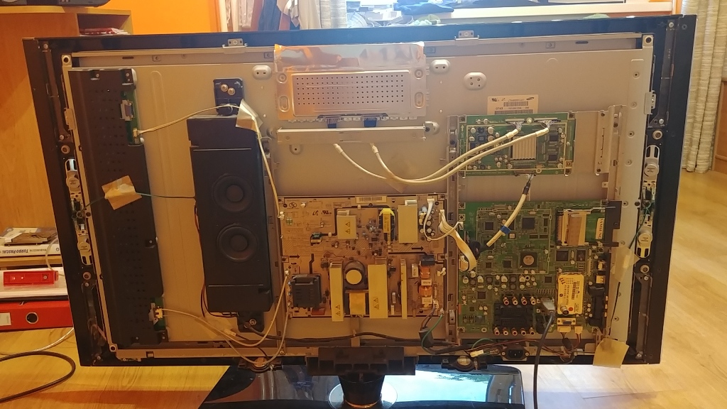

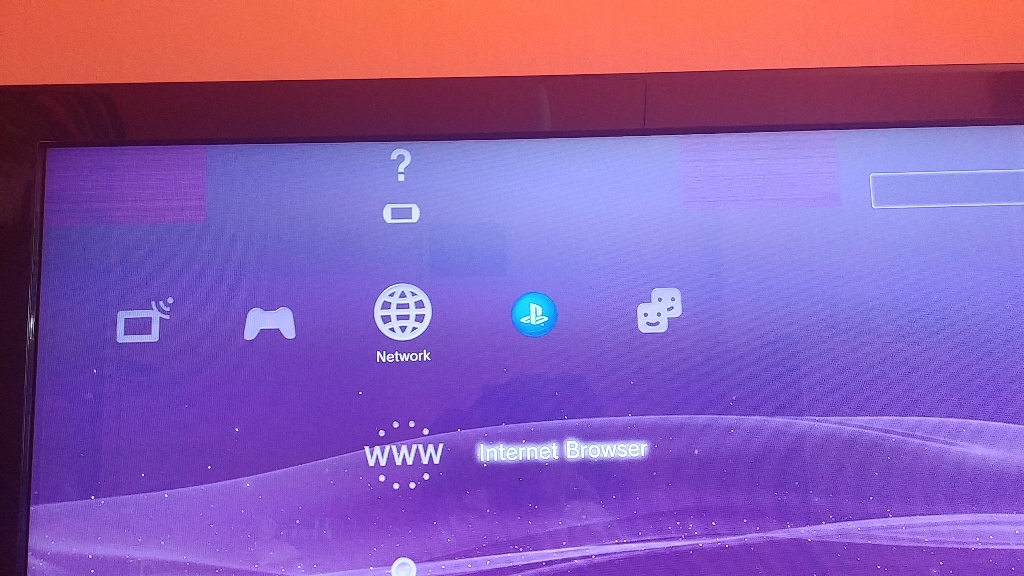

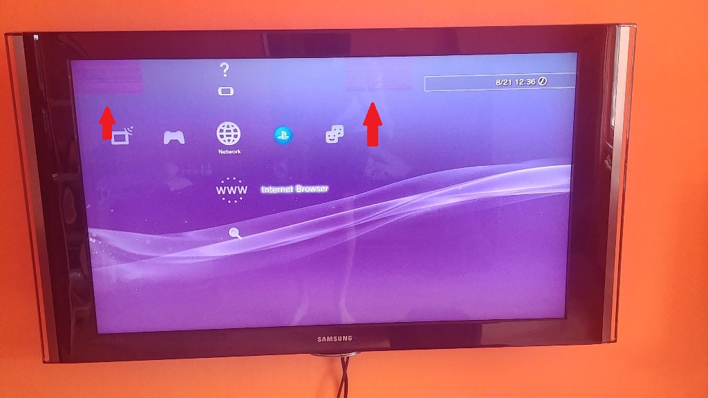

    I have this TV bought back in 2007 and used it for playing on PS3 for 4-5 years actively. After then it was barely used. It was mostly in stand-by mode or plugged out of mains completely for years. Today when i turned it on i have noticed noise in picture on two different locations of the screen. As you can see on the photos (see attachments) the noise is only in a small rectangle area, and if you look at it closely you see that one noise rectangle area is at the upper left corner of first half of screen, the other noise rectangle area is at the upper left corner of the second half of screen. it is symmetric, not random.
    It was tested on two HDMI ports and one AV port and the noise is the same so it is not output port related. I have tried to move the cables but nothing happens. I have disconnected the cables and have cleaned the contacts by isopropyl alcohol, i have also cleaned the boards with alcohol but did not help.

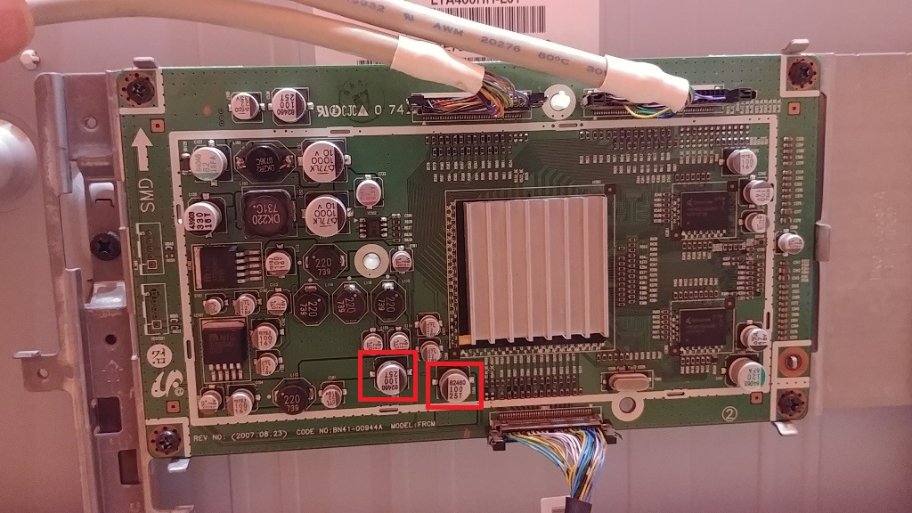

    I have checked the boards visually, everything seems OK. Except top surface of two SMD capacitors on the FRC board are a bit not flat like the other caps. but it is not serious like they are blown, very slightly can be felt by finger that they are not completely flat as the other capacitors. I am wondering if they could be defective, i will try to change them later if i manage to get such caps.

    That looks like a BGA issue, since it's quite old boards should be cheap... A temporary fix would be reflowing the affected board in the oven.

      And which board? Main or FRC or T-CON? or all of them? Thanks for the reply
        Re: Samsung LE40F86BDX (model 2007) noise in picture
        It's usually the main although on a set that old I believe I've seen the FRC board cause this issue... The Tcon can only cause half-screen or full-screen defects so you can rule that one out.
