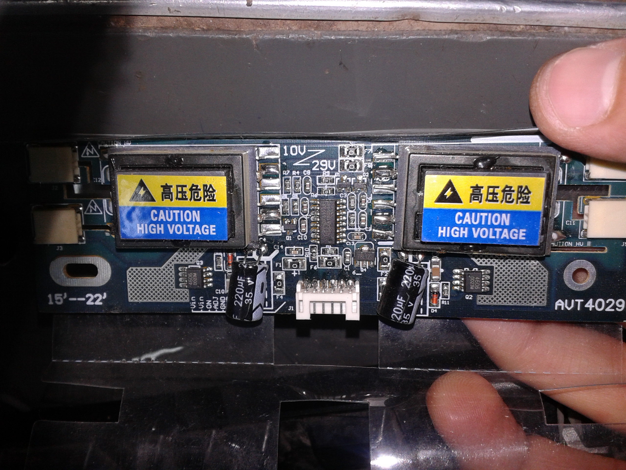

    hello gentlemen warm and getting hot greetings from Egypt
    there's allot of situations I've no choice but to disable one transformer out of the two that inverter is using
    also reduce lamps to 2 out of 4 "1 on top one on bottom of the LCD panel"
    the last situation i faced was a burnt inverter board on CCFL connector
    "hp la1951g"
    inverter board is a single high voltage transformer + 2 connectors'2 pins each' sure for only 2 lamps with no chance to fix the board i had to put an external inverter that uses ordinary 2 transformers + 4 connectors
    inverter board make sound and shut after 2 seconds using only one transformer 2 connectors
    how can i bypass that and if this question was mentioned before can anyone guide me to a solution
    another situation when i have no chance to replace cclf lamps due to measurements
    trying to keep inverter board operating with it's half disabled
    hope u guys understand what i mean

    So let me get this correctly, you have monitor that only has two lamps and the replacement inverter board is made for 4 lamps operation but you need to make this replacement board work with two lamps, correct?
    If that is the case, we will at least see the good clear pictures of this replacement inverter board.

        Re: how to disable half inverter circut and baypass protection
        sorry for the delay
        the only chance i have to disable half of the external inverter board
        shipping from china is expensive down here
        photo is attached
          Great picture, can I see the back side of the board too? I do not see any detection didoes on the board.
          Also please give me the P/N of that 16-pin PWM IC so we can look up the spec sheet for it.
              thanks
              there's no back for attached inverter totally SMD include DIP capacitors
              the PWM IC datasheet available in attachment DF6019A
                  Originally posted by The ENIGMA
                  sorry for the delay
                  photo is attached
                  Funny, I bought the exact same inverter from eBay not too long ago. Still haven't installed it, so I was able to look at it for you
                  With this inverter...
                  https://www.badcaps.net/forum/attach...5&d=1434323554
                  ... The left side provides feedback to the DF6109A controller IC, so you cannot disable that. Also, it looks like the primary sides of the two transformers are in series, so it may not be possible to disable the right side. However, it may be possible to just plug 2 lamps in the left side transformer to make the feedback look happy. I don't know, try and see. Connect 2 CCFLs on the left side and none on the right side. If it doesn't work, then the two transformers definitely have their primary sides in series.
                    I do not even see any ballast caps on the board.
                        Do you mean those blue high voltage caps between the CCFLs and the transformer?
                        There are only 2 on this board. Haven't traced them how they are connected (yet). The CCFLs for the right inverter are connected to ground on one side and the transformer's high voltage outputs on the other.
                        It's the same for the left inverter, except here the lower CCFL connector provides feedback (CCFL is not connected to ground there).
