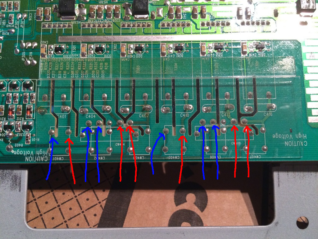

                    Show a photo of the underside of the board by those connectors so we can see what they connect to.

                      Re: Dell 2005FPW Flickering - Seeking Tech Advice
                      Hi Agent24,
                      I'm way over my head here, so thank you for helping out! Here's the picture you requested.
                        Yes it looks like the wider connectors are doubling up to replace two of the smaller connectors each. That makes it a bit trickier but you can temp solder leads to the solder pads on the underside for testing if it comes to that.
                                From what I can see, the lamp wiring is as I have marked on the photo. Red for lamp output from transformer, and blue for lamp return wire.
                                You can also look at the lamp plugs when plugged into the inverter - thick wires are outputs from inverter, thin wires are returns.

                                  • 30965
                                  incase you had not noticed, the board is printed to also handle 6 seperate connectors - one for each tube.
                                  so just solder onto the pads for each un-fitted connector.
