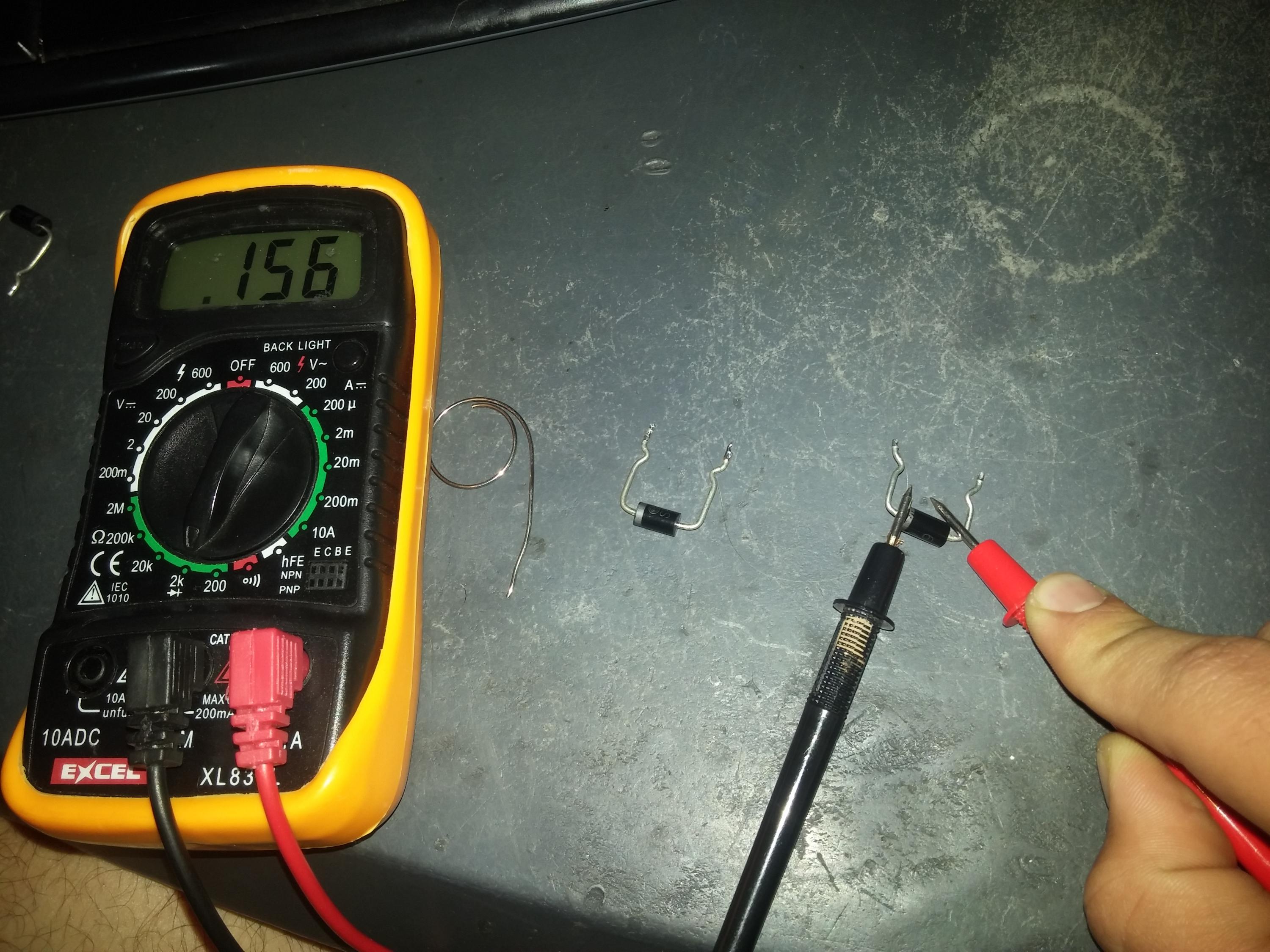

                    • shlomi93
                      • Apr 2015
                      • 10
                      • israel
                      Re: where can i get electrical components???
                      Originally posted by newtothis
                      What do you mean 0.5-0.8? 0.5-0.8 what exactly?
                      Have you set your meter to diode mode and tested with red first to + and black to - then vica versa?
                      They should allow continuity one way and not in reverse.
                      If they fail then lift a leg from the board and restest
                      the diode continuity is only in one way but the value is low.
                      i set the DMM on diode mode and those are the results..
                      look at the pic.
                      Originally posted by budm
                      "i know that i need to get 0.5-0.8 on a good diode and i get:
                      2 diode SR5150 give 370+/-
                      2 diode SB540 give me 150+/-"
                      What mode did you set to to test the diodes? It sounds like you set it in VOLT mode (dc or ac).
                      My post #5:
                      This power supply /inverter board is an always on power supply, so that is why I ask if you do have any DCV at the connector feeding the logic/main board, you can also disconnect that cable and see if the output dc Voltage will be steady without the main board connect. You can also have shorted circuit in the inverter section that causes the power supply to be cycling on and off. BTW, what did you use for the GND REF point for the meter when you make that measurement?"
                      So you do you have?
                      no im on diode mode.. look at the pic.
                        Ok I think the 0.5 to 0.8 is volts on the diode setting as in retiredcaps guide is says 0.5 to 0.7.
                        BUT you need to test twice once as you did in the picture then swap over the probes and test again
                        Here is the guide - there are lots of useful tests in there most with no power to the board.
                        https://www.badcaps.net/forum/showpo...4&postcount=19
                          SB540 has Vf of 0.48V at 5A If, so the Vf will be lower when using the diode mode due to very low test current, see FIG 3 Graph, but as selldoor suggested, you need to swap the probes also. i always check the diode for short or leakage using Ohm mode.
                          Again, you need to diconnect some of the load to see if the Power supply will stay on as noted in my post #5.
