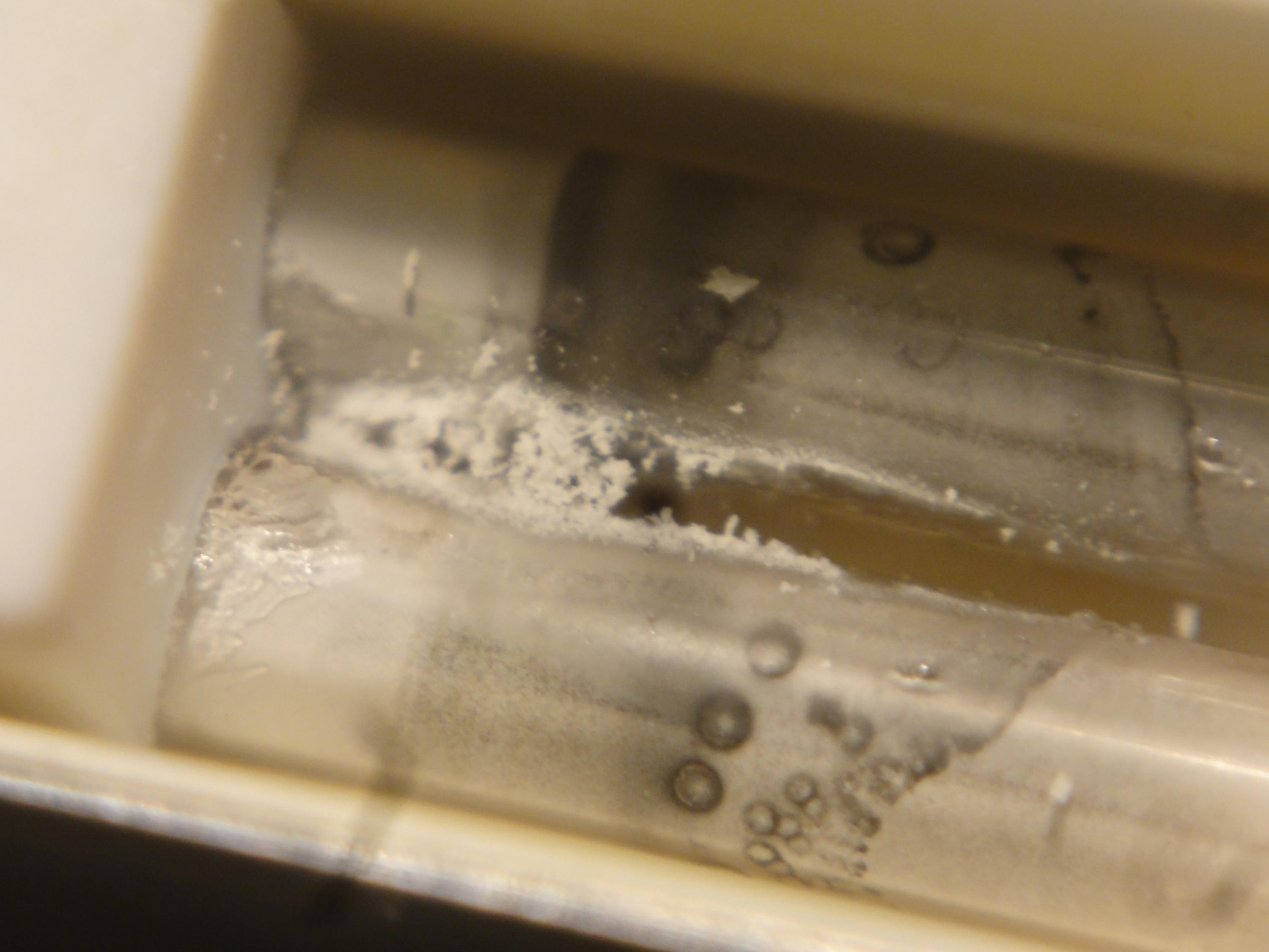

    I've read numerous posts with similar problems and hope I can get a handle on what's ailing my Westinghouse LCM-22W3. Eventually only show: green led and desktop for ~2 sec, then black/nothing. Reboot would give same. After a few min led switches to orange.
    I've fixed an lcd before (thanks badcaps). Replaced some caps on power board but got messy, so ordered a compatible DAC-19M005 replacement for my DAC-19M010.
    With new power board: now upon boot I get (green led) & ~2 sec of desktop, then black (using VGA, or dongle: no true DVI cable). I can tell using a flashlight the screen is getting no image. There are no sounds.
    Q1: Anyone think the DAC-19M005 is worth keeping? A post on another site says problem may only be a difference in the current protection circuit (replace one component?). Other posts surmise this problem is due to backlight issues.
    I could return the DAC-19M005 and look for a 19M010 but imagine that also might give wrong current. Personally I'm smelling backlight issues.

      "After a few min led switches to orange." Do you have it connected to running PC?

        Try the backlight substitution trick. I successfully used old tubes from CFL lamps to prove a lamp fault in a monitor recently. After replacing the lamps with new CCFLs it works fine. The old one had a crack in it!
        Would work for 10-20 minutes at a time too... tricky one...

          @budm: Yes or course. I'm leaning towards keeping this power board and trying the t-shooting. Doubled my investment so figure in for a penny in for a pound. Just wish I had some clue as to whether it's the 'inverter' (cap?) on the board or the CCFLs.

            Just make a pair of these:
            https://www.badcaps.net/forum/showth...er+testing+cfl
            It will save you so much time and money to find out if you have bad lamps or bad board.
            Here are more pictures of what go wrong with the lamp assemblies.
            http://s807.photobucket.com/user/bud...in=true&page=1
